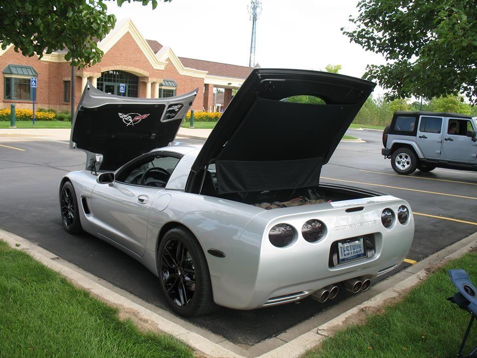

Originally Posted by mrmagloo
Bill, can I still drop my beast off in the spring? I'll bring the beer.
I haven't done my car in 18 months. .. not sure if I have enough gas in the tank to do mine. The good news is my car still looks wet.
From one of my security cams taken a month ago.100,000 miles.
One of my favorite C5's.
It pales in comparison to some of the really exceptional cars on this forum, but its certainly not your average C5. The amazing thing is that with proper care, a 100,000 mile car that's 18 years old can fool the eyes of most non car people. Those who think its brand new. A 40 year oldish black guy driving a brand new Lexus, asked me at the bank, if my car was the " NEW" Corvette spider.. his words.
Bill aka ET
The operative word in his question was " NEW ".
I owe this phenomenon to my four corners. always spotless, wheels wells look as if they never saw a road way. wheels spotless and dust free , tires clean and not that fake wet look. Rotors without spec of brake dust, no rust, and as if they were chrome plated The stainless steel aircraft fasteners that are set into the black nitrated aluminum hats add a detail that catches the eye. . Also the paint finish is wet looking , that's Zaino .. MY car was cleaner than the 2016 Lexus. It takes little effort to keep a clean car clean, if you never let it get dirty. Of course being retired gives me the luxury of time, which many people do not have. I've been very sick with lots of trips to the hospital,,, testing and clinical trials..

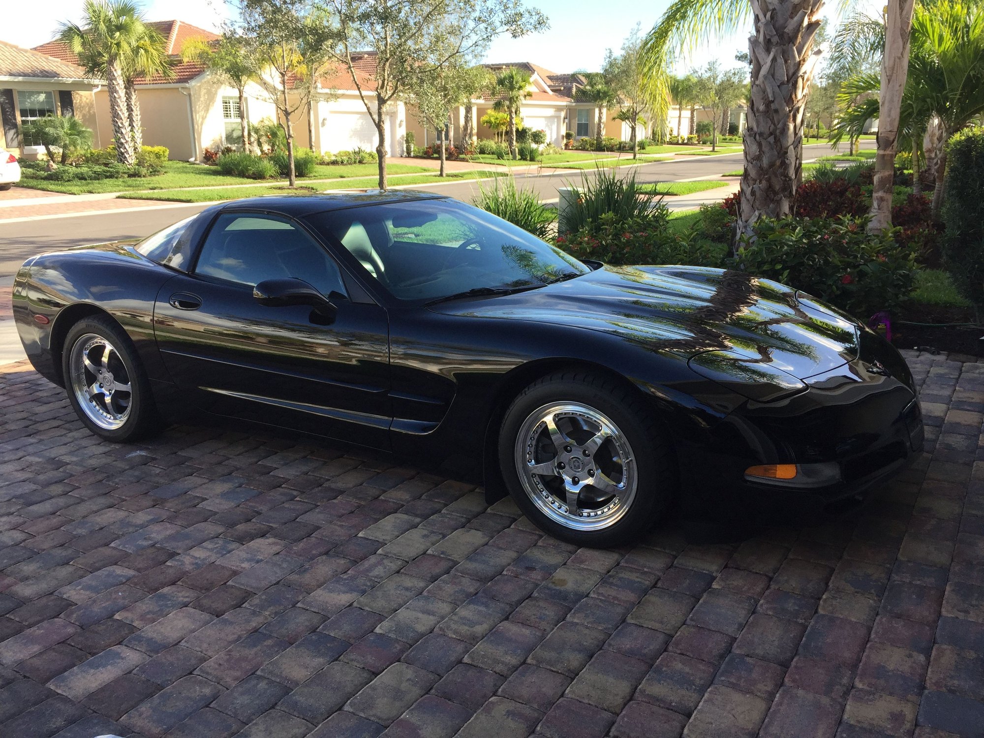

I recently clay barred my Black C5 a few weeks ago followed by Griots One Step Paint Sealant. I am very careful and haven't had problems with scratches, but it could easily occur. Just keep folding and kneading the clay and change it frequently. 11 years with my Black '99, taken just after the clay barring and paint sealant.
Looks great Mike.. Just because I use Zaino doesn't mean that there are not other products that can yield a good result.. IM glad you recognize how easy it is to scratch a clear finish. But to deliberately rub a dirty car with anything without removing the silica that's use to remove paint on a piece of sand paper, is mind boggling..

Bill, here in Florida there is sand everywhere. Every time I clean my cars I thoroughly soak them, using lots of Meguires car wash and a clean Griots thick nap microfiber was mitt. I use a blower to dry the paint and rims and a clean quality microfiber cloths to dry the remaining water droplets. The blower works well on the polished finish of the 3 piece rims removing every trace of water so I don't even need to touch them except when I routinely polish them.
I drive my car and often in the rain and there are plenty of bugs here but the clear bra, and keeping on top of the cleaning keeps the paint and rims looking new. Plus I keep the exhaust and rim barrels clean as well.
The GM clear coat over the Black paint is very prone to show even the finest scratches and imperfections. When I installed my headers I made sure to use thick fender covers and blue tape to keep them in place and to tape any other exposed painted areas such as the painted headlight covers and edges along with heavy towels and not a mark on the paint. If you're careful you minimize the chances.
