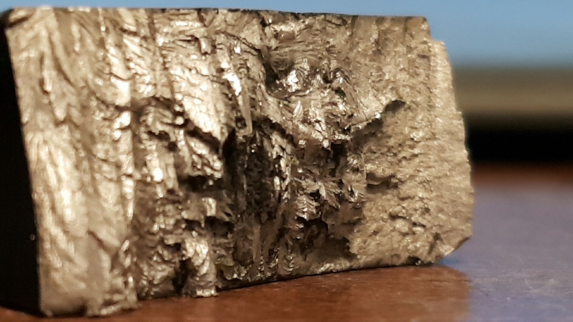

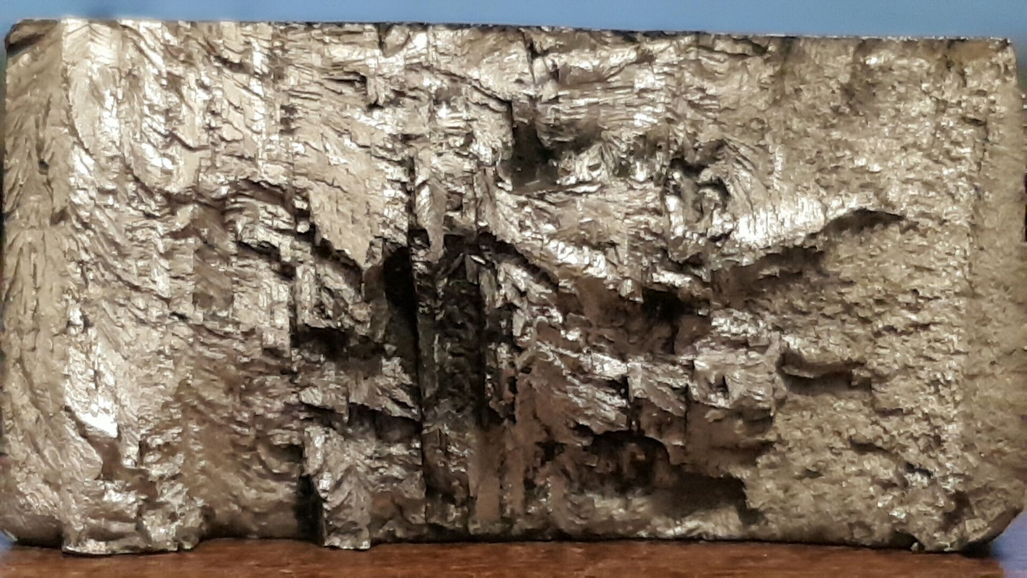

I had talked to the manufacturer of my forged wheels and was told that re-coating was fine as long as whoever was doing it knew what he was doing as temps above 450 would change the structural properties of the metal. Your info is consistent with that.
I have a question for you. I never got an opportunity to refinish them as the anodized wheels cracked in the middle of the spokes.
I cut out the cracked sections and took some cross section pics on both sides. Is there anything in the attached pics that would suggest anything to you?
I have also heard that the anodizing process may also weaken the structure. Is this true?
I am just trying to gain an understanding of what happened to satisfy my curiousity.

First off, in reality, fatigue strength is proportional to starting crack size, and if anodizing can prevent scratches (which eventually originate into fatigue cracks) it would only improve fatigue strength. Secondly anodizing prevents contact with the elements (much like paint does) with Aluminium which prevents stress corrosion cracking, once again improving fatigue strength. Furthermore, the layer of aluminium oxide is so small that it can't seriously be extrapolated to reduce cross sectional area, which would translate into reduced strength.
So to answer your question, NO, anodizing does NOT reduce the structural integrity of a part on the scale of a car wheel.
Now, in all honesty, a small amount of surface is altered with an acid, like sulfuric, or chromic acid, which does technically reduce the strength of a part by reducing cross sectional area...but depending on the material used for anodizing, that can be as little as 0.0001 of an inch, to 0.010 for the more aggressive processing. Your usual processing usually only uses the prior, and 1-ten thousandth of an inch, is NOT going to effect a car wheel.
Without being able to physically handle the material, it is hard to say what caused it. Typically, a part thought to be strong, and defect free, will break in this manner when it's base materials engineered limits are exceeded...too much nitrous hehe! However, it only takes a small surface defect to eat away at structural metals that go under heat, and/or stress cycles regularly. Bellow is a pic of a lab experiment where they scratched the surface of an aluminum rod, then applied stresses to it until it completely failed. You can clearly see how a small surface scratch can propegate until the part fails entirely.
