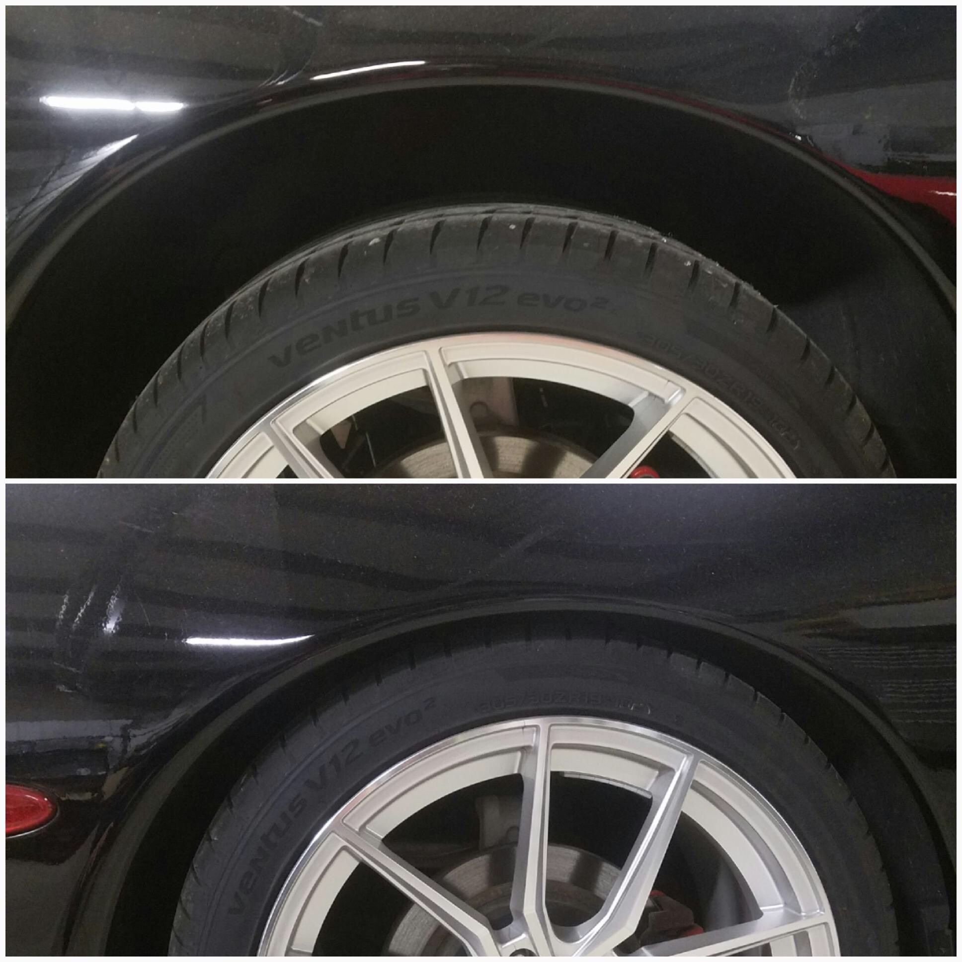

Ok, I have Hankook 305/30/19's mounted on Cray Spiders on rear of my '02 Z06. The shop just called me and said they did the lowering with a kit and then an alignment and the closest they can get my rears in spec is -2 degrees. They are telling me -.6 is spec and I will have a little inner wheel wear but if they put it in spec there is rubbing on the inner part of the wheel? Anyone experience this? Actually, my question may be what is the correct way to lower your car?? Here is the difference:

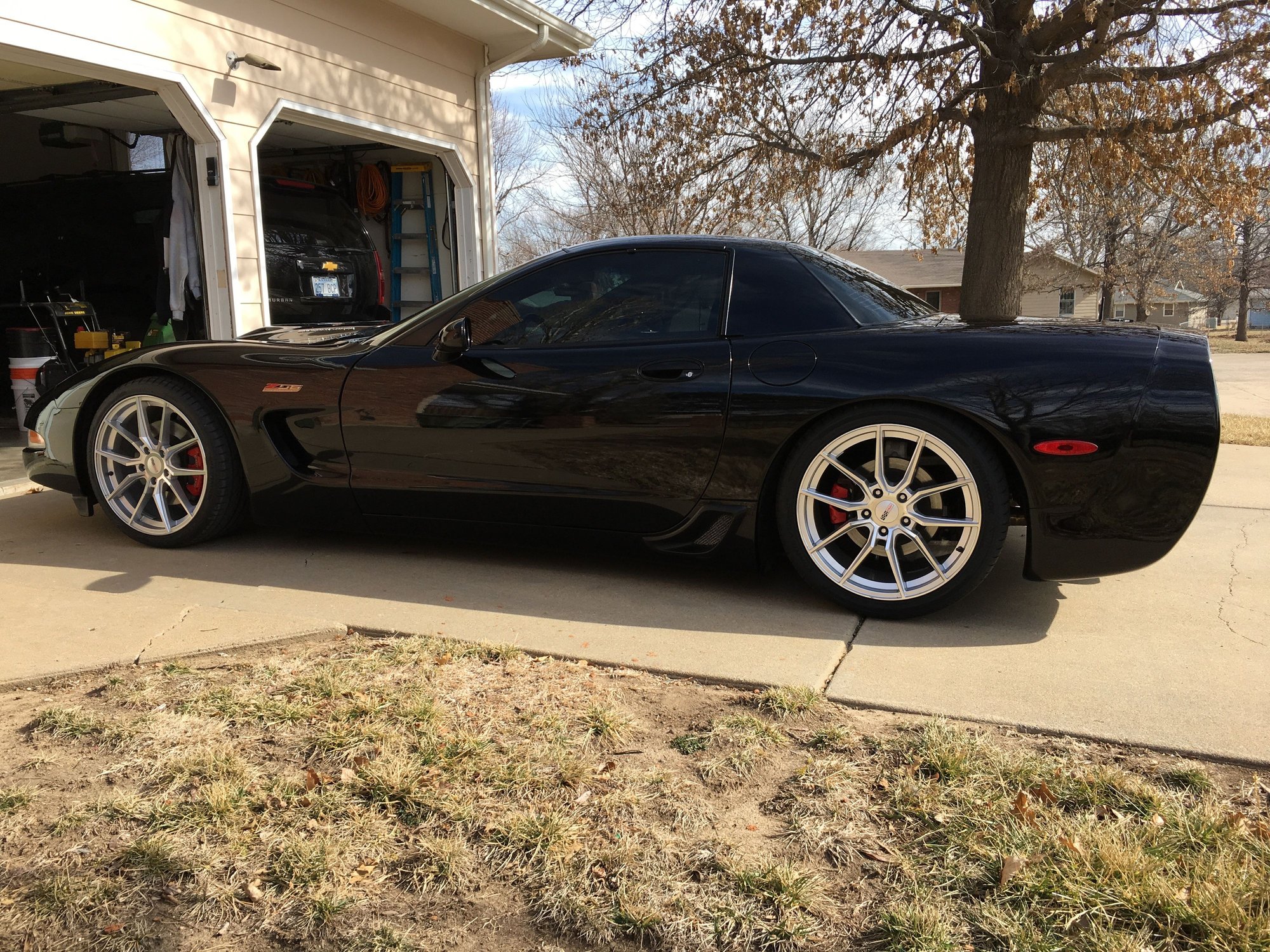

Finally got my ride back from the shop and here is pic of whole car. Love the look, but it rides like crap now, really stiff and bouncy. He didn't lower the front too much to help with navigating my driveway. So should I come back up a bit in the back? Coilovers?

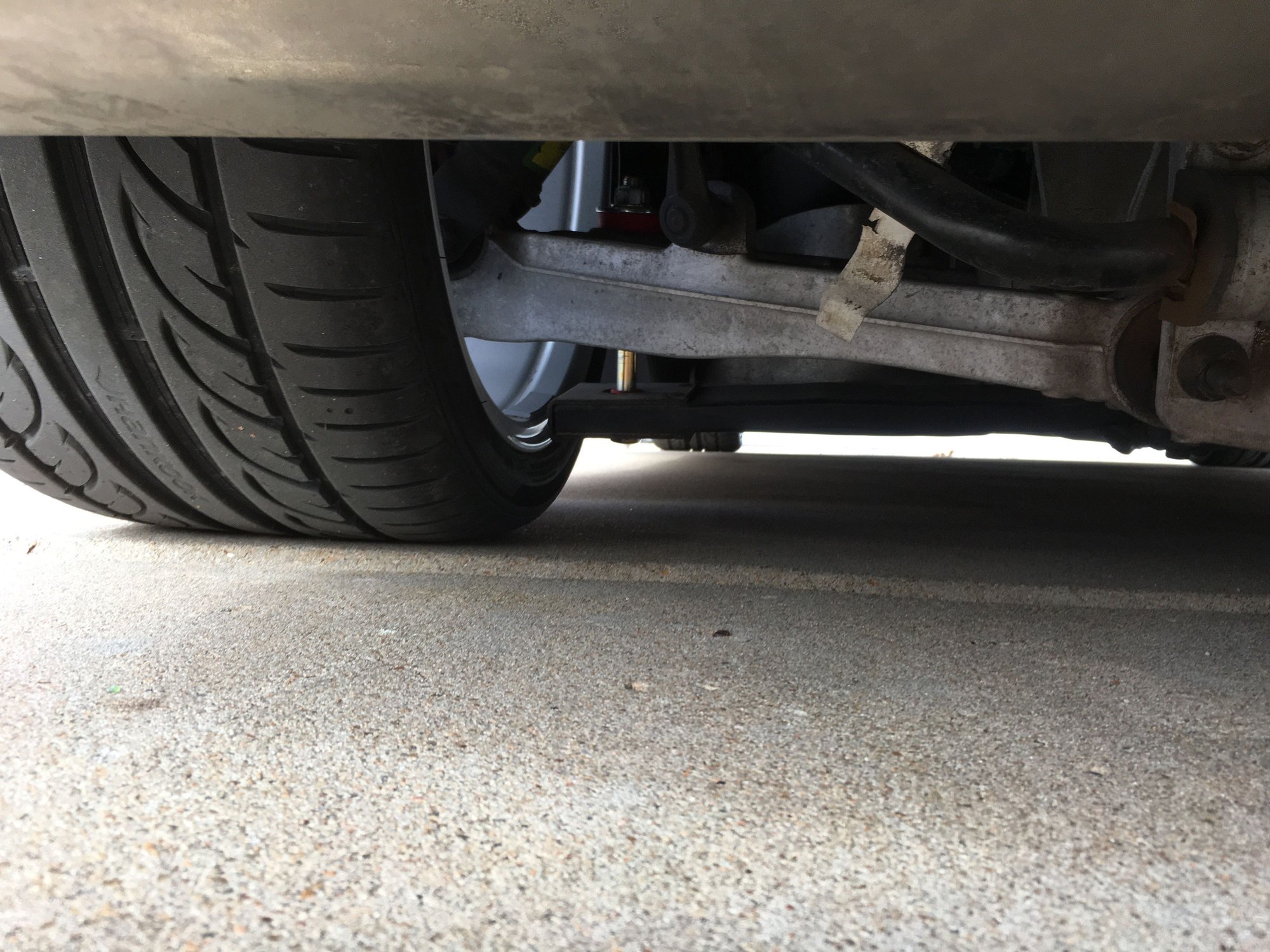

Here is the left rear. See where the bolt is and how close it is to inner wheel.

Hits on the end of your leaf spring, I see that wheel is listed as a 65mm offset & stock is 58mm so only about .200 more inset than std rim. May possibly need to run a spacer to push wheel back out to get your camber back. Coilovers will fix that, as your leaf spring gets removed, or as you stated maybe raise it back up some, not sure if that will help.

It sure looks good being that low, but the rear looks too low compared to the front. As was mentioned, there should be some forward rake. The recommendation is 1/2 to 3/4" higher in the rear measure at the rocker panels. It would probably help a few of your issues. What shocks are you using? If you don't want to go coilovers, try Bilstein Sports, they work well with lowered cars. You also could contact Doug Rippie Motorsports, they have the Sports specially valved for them at a price not much more than regular Bilsteins. I have the regular version and they work well.
