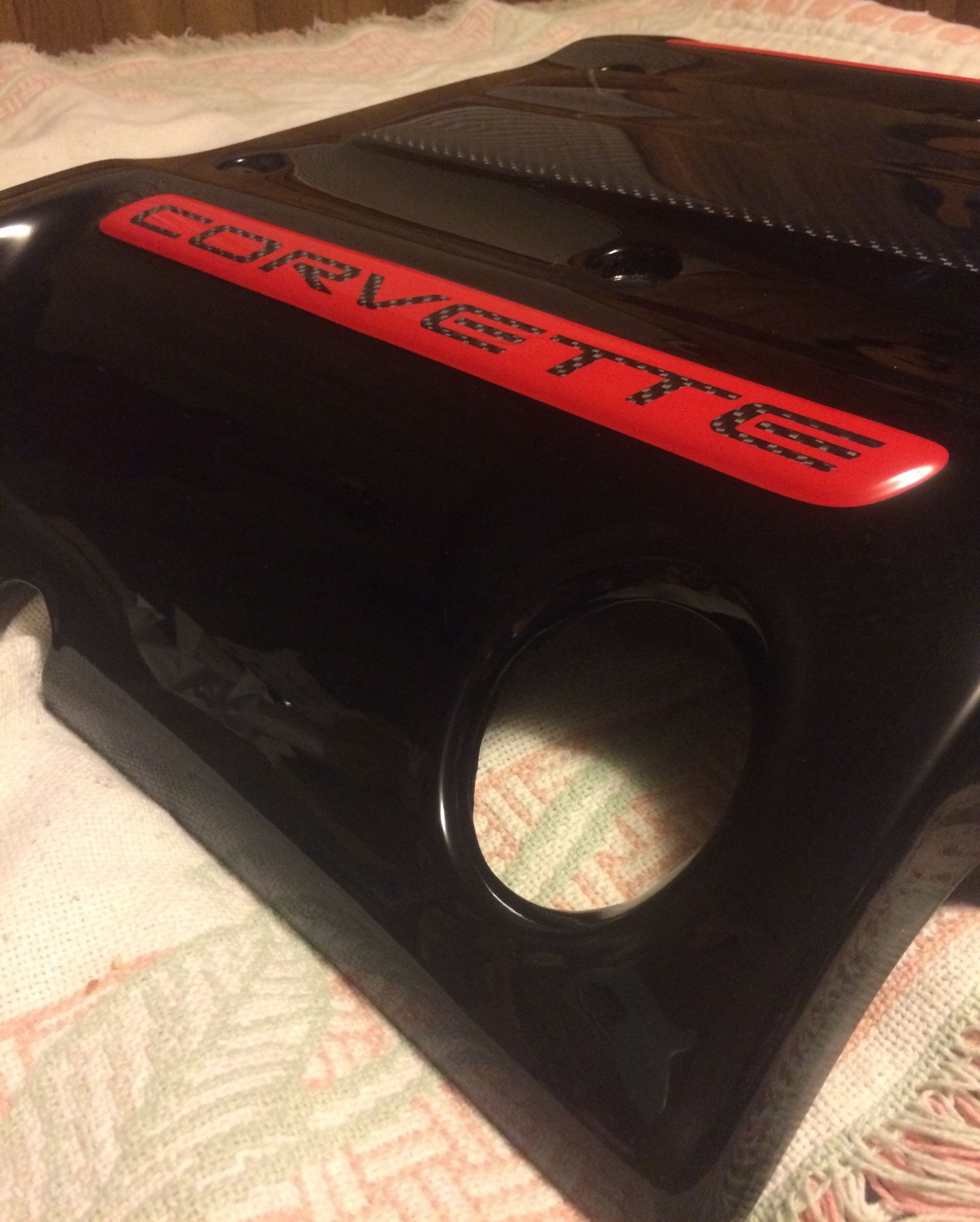

These are light as a feather
and also not valve covers

Sorry.....
Had a brain fart

, that is a nice looking piece though
