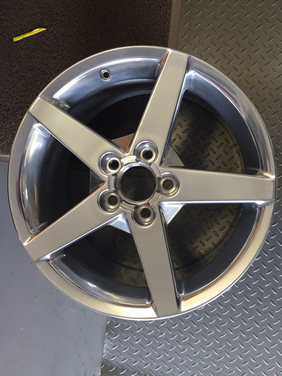

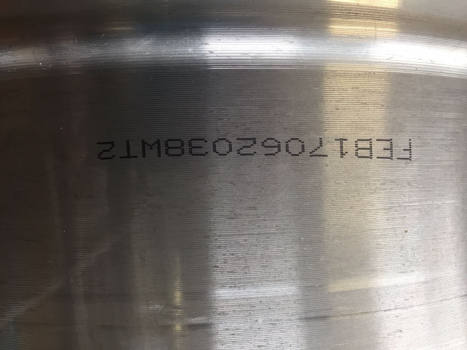

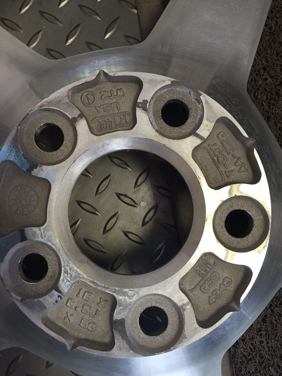

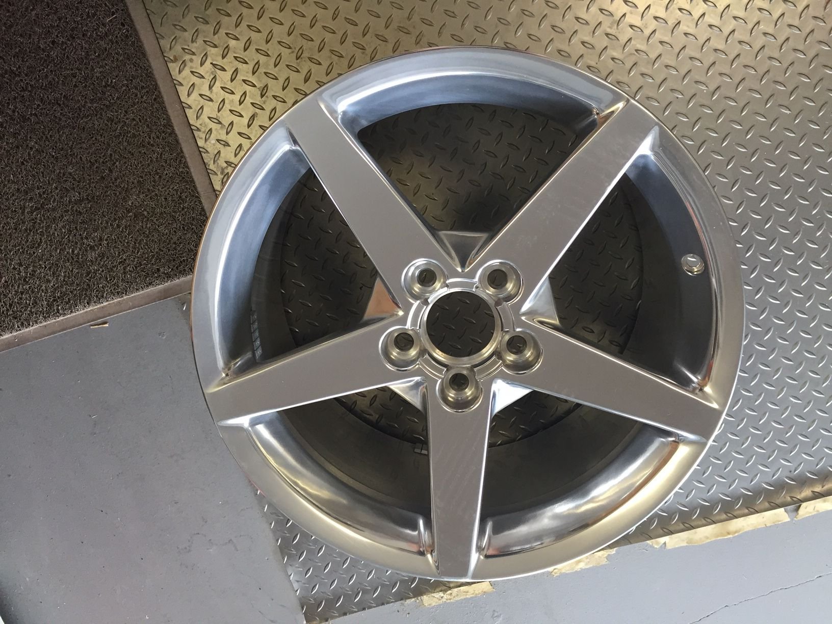

I picked up today a set of 4 OE rims from a friends 2008 C6 that were taken off the car when new and put in storage. He told me it was from his Base 2008 C6.
Any information regarding these rims?? What are they worth??
These are not Chrome.
I am missing the Center Caps. Where can I purchase OE/Style replacements?
RPI Design has the Decals available for the center caps. They have two sizes available. Which size should I purchase?
Which Lug Nuts/Locks should I purchase????
I would like to put these on my 1999 C5. Will their be any problems with the larger wheels/rubber??

Hopefully they'll fit fine, so much better looking than the wagon wheels. JMO

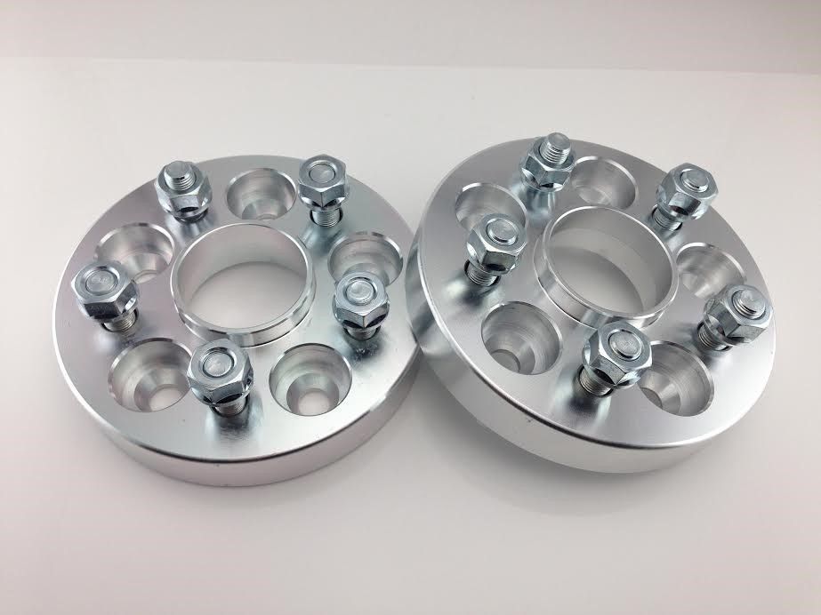

As 8VETTE7 said, spacers will be needed at least in the rear. Most guys use adapters. Big difference between the 2.
The front wheel offset is so slight you can get away with not having to put anything on the front. As for the rear, you will need these :
http://www.ebay.com/itm/191700486593...%3AMEBIDX%3AIT

You need 1" spacers or the wheel studs will hit the rear of the wheel unless they are trimmed. 20mm = .78" which means about 1/4" of stud will have to be removed.
