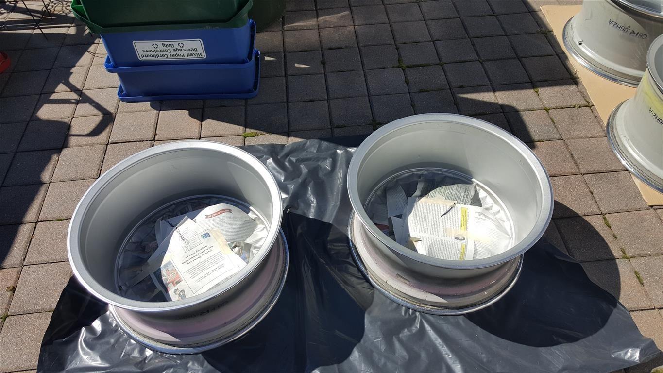

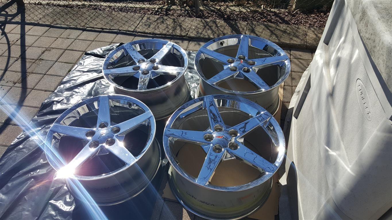

GM Chrome C6 5 Spokes off a 2007
Finished up doing a little Preventive Maint. work on them today.
Cleaned, primed with acid etch primer, some Dupli-Color wheel paint along with matte clear...barrels look good as new.
Got the adapters for the rear as well.

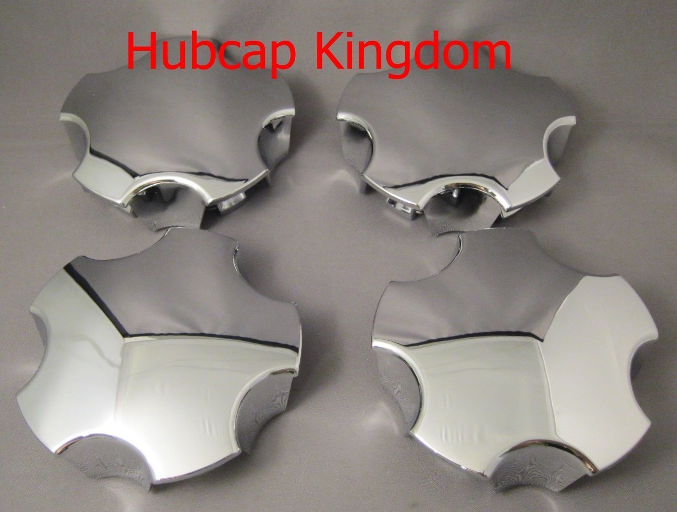

Awaiting plain chrome center caps to arrive ( putting C5 Emblem vinyl stickers on the caps )
along with new Schrader TPM's and I can have them mounted, balanced and installed on the car !

Good to hear you are putting C5 logos on, I have seen C5s with C6 logos on them, it just doesn't look right. Be sure and post pictures when mounted.

Lou, can you tell me more about that primer you used? I'm preparing myself for what looks like eventual pitting on my barrels. Is the wheel paint better than regular body paint?
