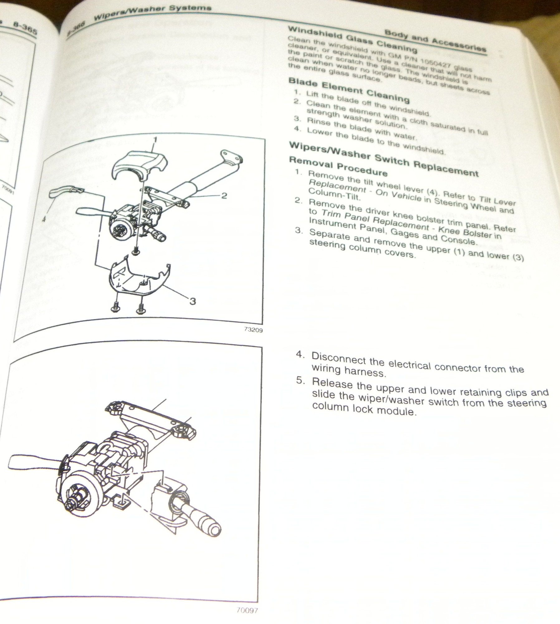

I going to help My friend replace the windshield wiper /washer switch on the steering column.
Are there any write up ....wondering how extensive this might be and if
there are any pictures of the project.
Thanks

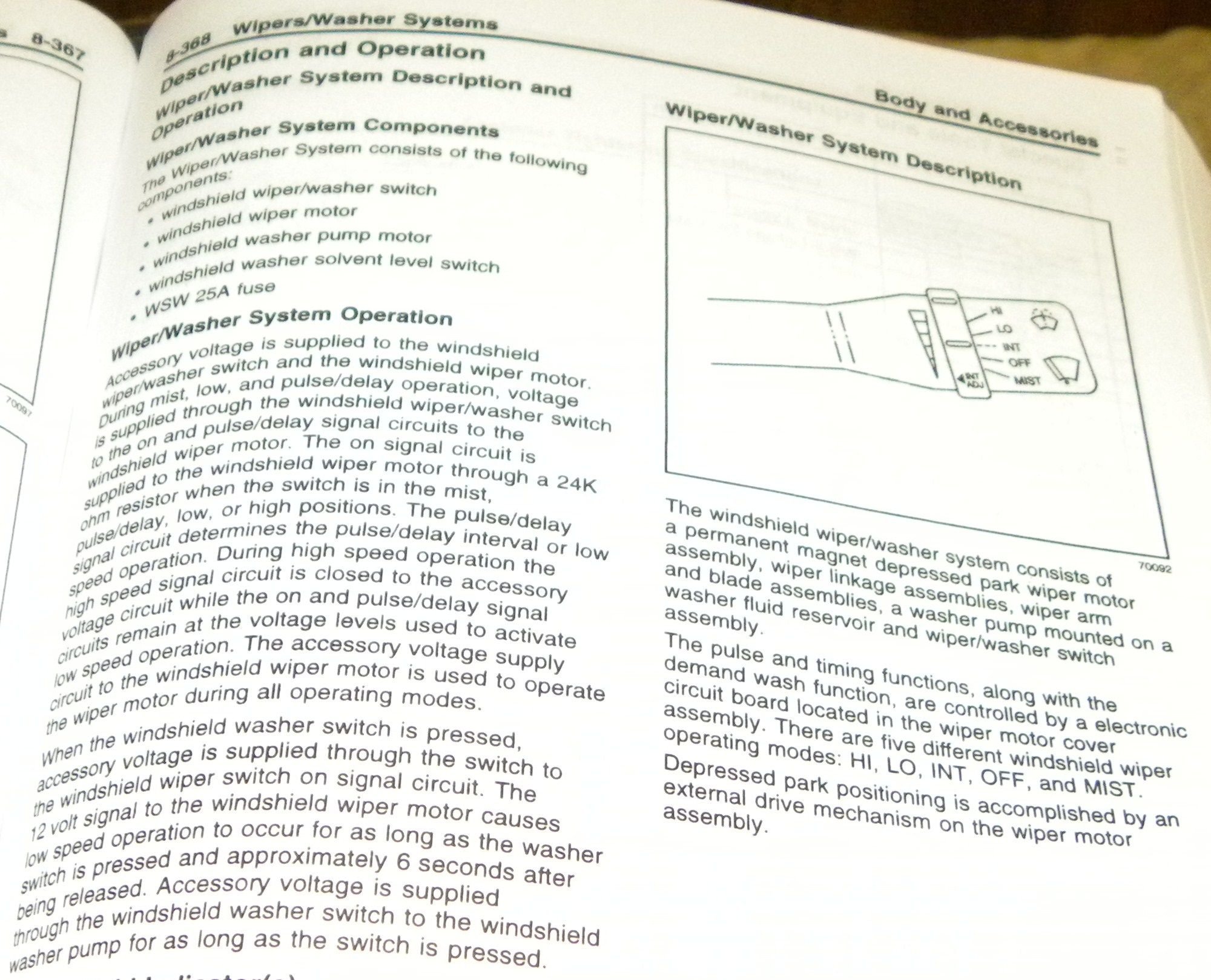

I know its not very good but hope it helps...

Thanks so much that's lots of help...the only thing I will have to check is how to take the tilt lever off...

Hi Sloop
Everything worked out fine...the only change I would add is ..take out the drivers seat and add a couple pillows for those times when you have to lie on your back.
This was originally diagnosed to be a bad wiper motor and then with the help of
the forum turned out to be a wiper switch problem..
Thanks a lot this saved My friend a good amount of money,,!
