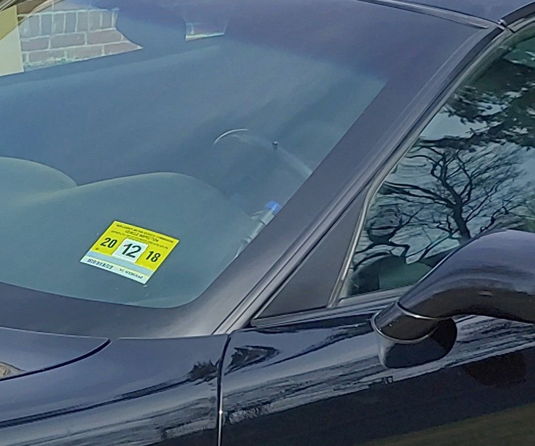

[QUOTE=ApexerER;1594318803]
Originally Posted by radar502
If you don't mind I would love to see a pic of how/where it is mounted....Thanks
Here is a pic that shows where I mounted mine. Ran the wires down the A pillar and used the double sided tape to mount the semi circle clips that hold the Raptor.
