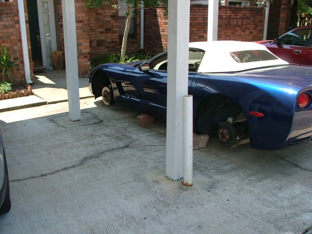

When a I bought mine new back in 2004 the idea of no spare kinda concerned me. Now 2017 and 107,000 miles and the only tire issue I've ever had was some SOB once stole all of them!
Did they do any damage when they jacked it up?
Yep, I think it was about $700 repair and paint rocker panels.
As I recall, total cost including repairs, rims, hub caps, lug nuts. TPm and tires was about 6 grand.
