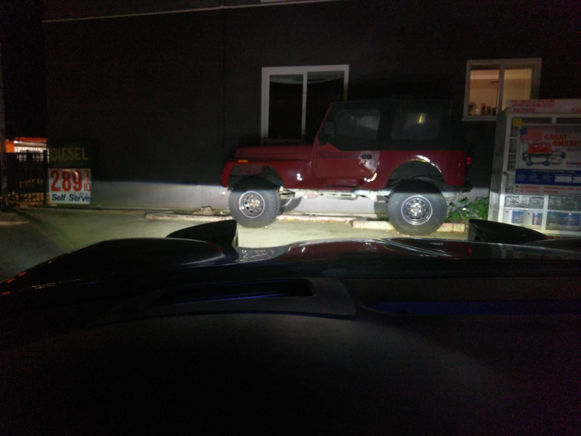

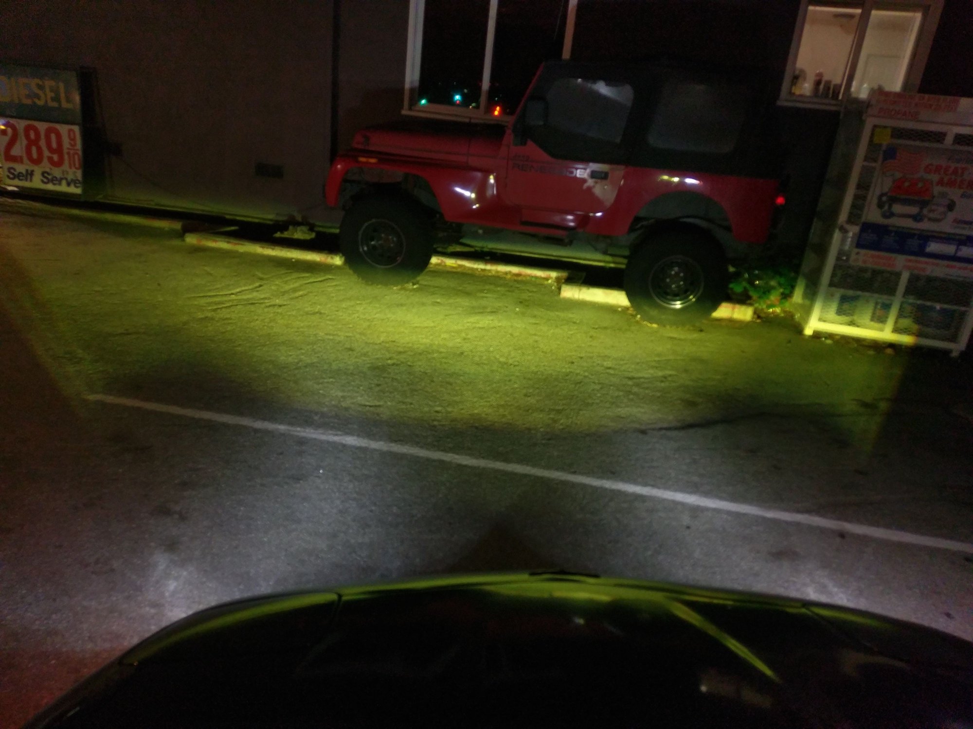

Lucky for you I just took some.
Fogs only:
With FX-R 3.0 55 watt retrofitted ACAs:
FX-Rs only for comparison:
Shot on my HTC 10 with ISO set to 400, everything else on auto.
