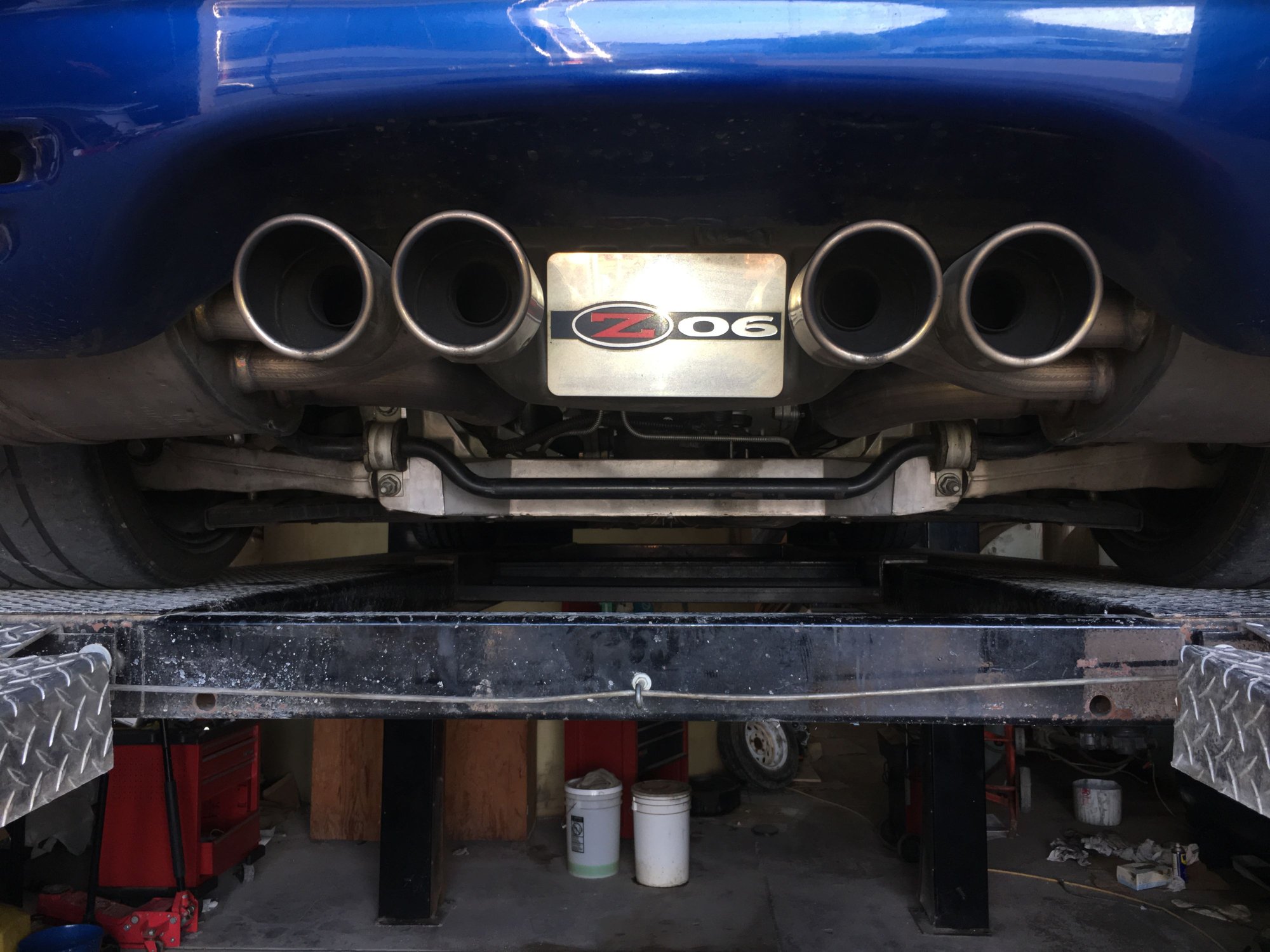

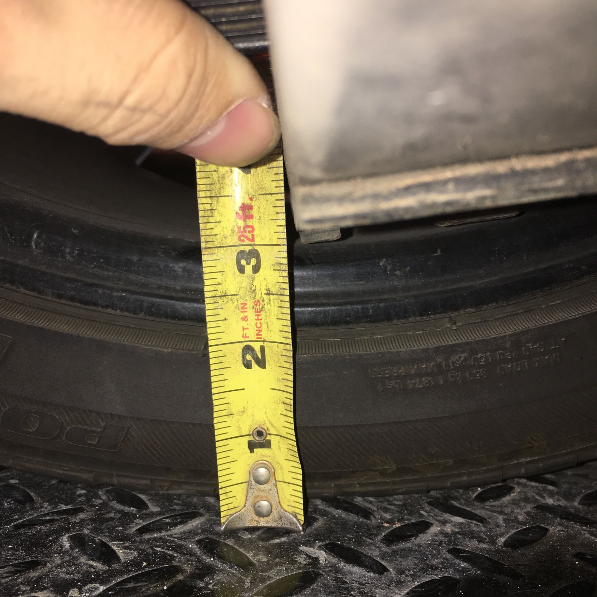

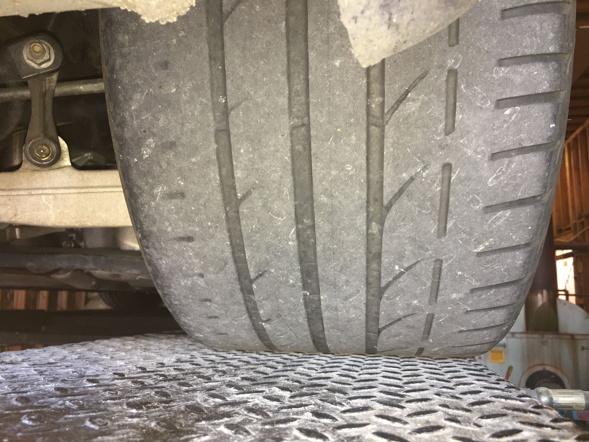

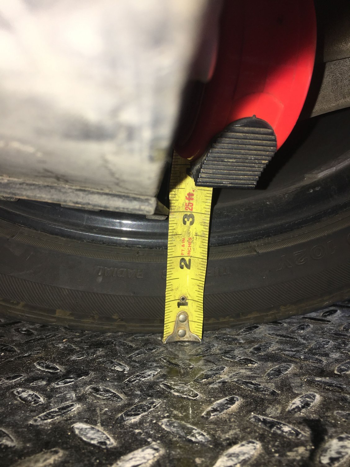

tires could use replacing in the next 1,000 miles, and yes I believe it's the original rear spring. I just put the car on the lift and noticed that the left rear leaf spring side is higher than the right rear leaf spring side. Not by much but you can definitely tell. Also my alignment seems to be off, the left rear tire has an angle away from the car while the right has an angle towards the car.. very weird. Here's a couple pictures for reference

What kind of power you making? Leaf Springs, TCS errors, and tires are the usual culprits, but depends upon how much power you are making. Those tires look like they need replacing. Tires can make all of the difference in the world. Experiencing wheel hop as well?
If your rear alignment is as stated, then you have toe OUT on one side, and (too much) toe IN on the other side. Even though this will indicate the correct amount of TOTAL TOE, you actually have the rear end steering your car under power. This condition is highly undesirable, and will have you fighting the car , which is trying to steer the car in a direction different than YOU are.

those tires are legally bald!! Look at the horizontal wear bar across the tread!!! The inside edge will have steel showing shortly!!
That means they are pretty much slicks now right?
