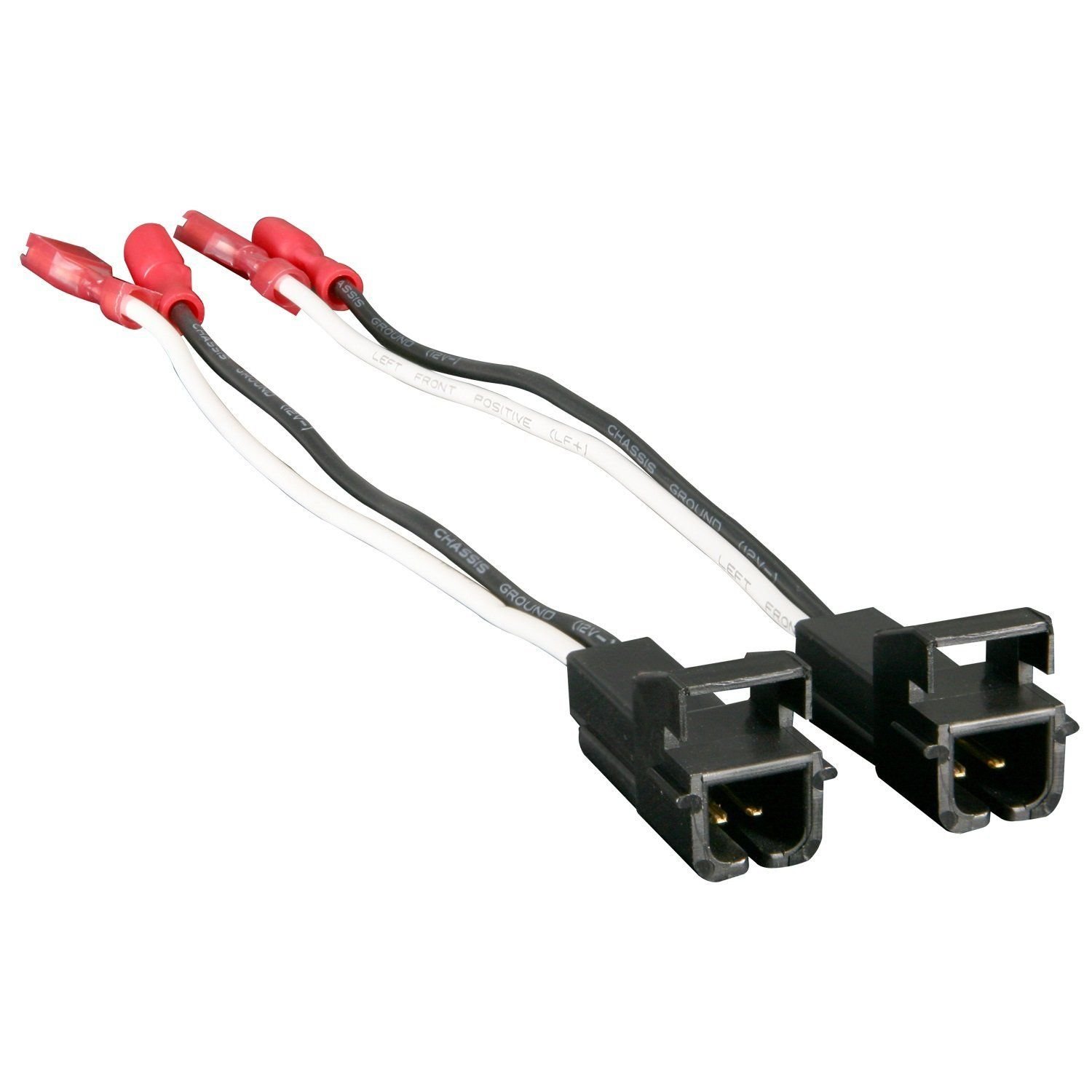

You are going to need
<b>this kit</b> this kit
as well. One kit will do both rears.

Originally Posted by mikeam
Thanks GCG! that is great info.
Will the harness shown work for the front 3.5" twiddlers as well or is some cutting & soldering needed for replacing them?
Old Apr 13, 2017 | 11:03 PM
GCG's Avatar
GCG
Joined: Jan 2009
Posts: 3,275
Likes: 739
From: Miami FL
I was not 100% sure about that and I asked that question in another thread.
The 3.5" front twiddlers are wired into an 8 pin harness shared with the subwoofer amps. To avoid having to deal with the 8-pin connector and still keep it neat, just desolder the 2 cables (black with red stripe and black with green stripe) from the Bose speaker terminals and solder them back to the replacement speaker terminals. Make sure you keep the correct speaker polarity.
