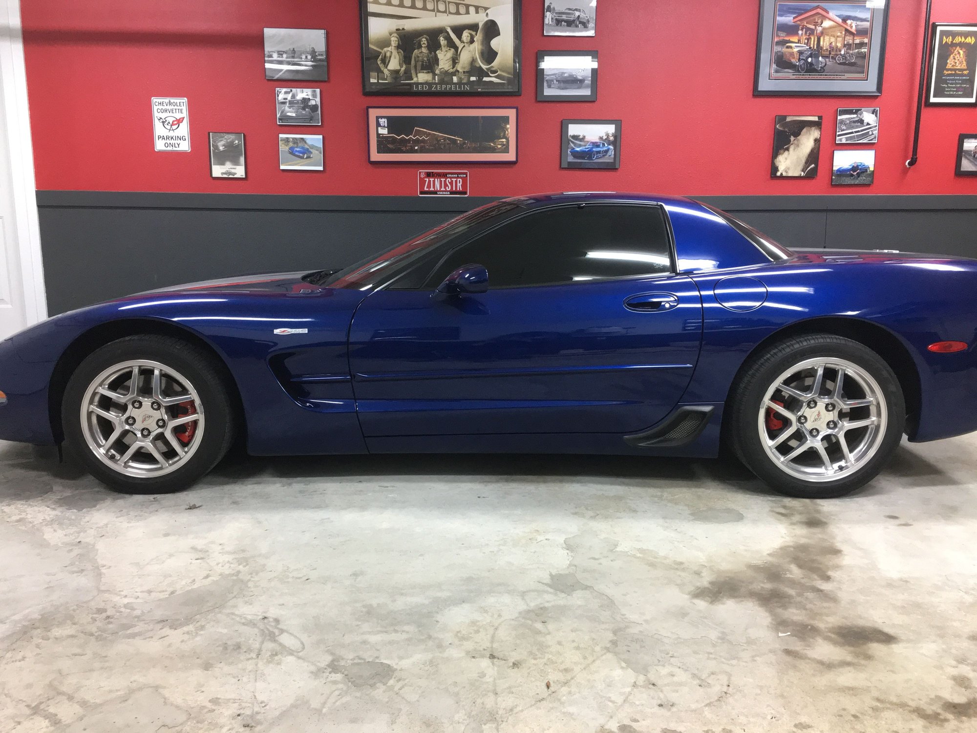

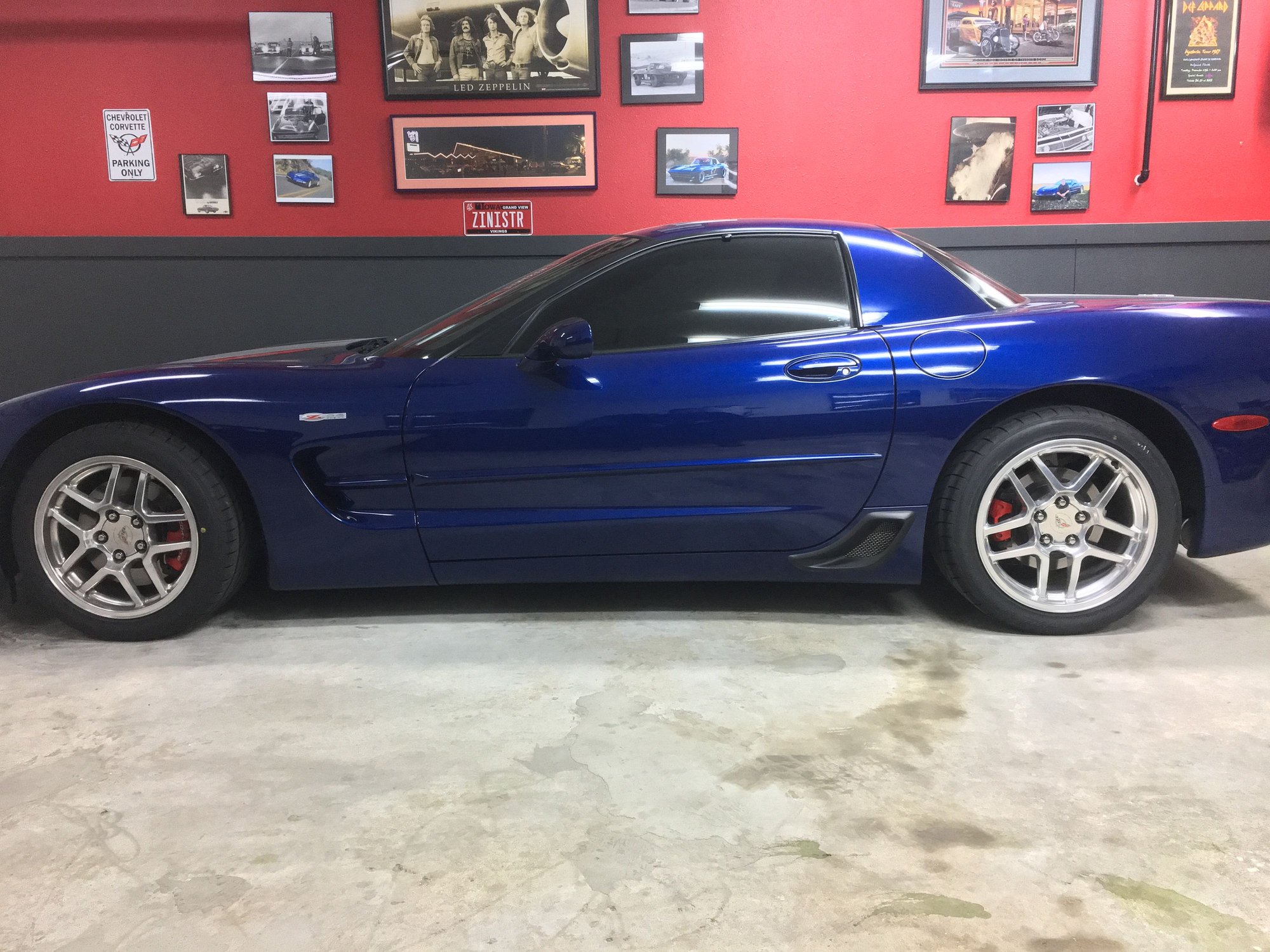

Lowered it even turns on each side, front and back. Need to fine tune a little more but here is where I'm at:
DF 5 7/16" JP and 27 7/16" fender
DR 5.5" JP and 28 3/16" fender
PF 5" JP and 27" fender
PR 5 1/8" JP and 28 1/8" fender
Before:
After:
