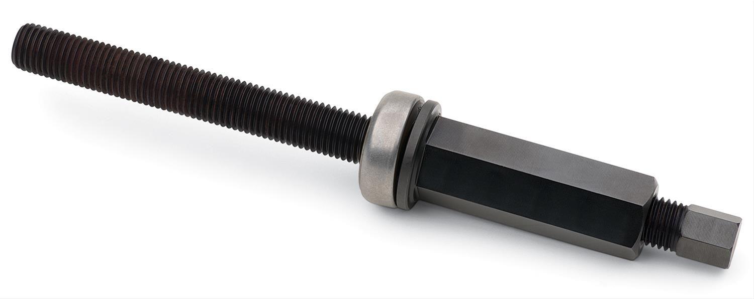

You'll need a balancer puller, if you the stock balancer, get a 3 jaw puller.
You'll need a balancer install tool and locktite.
You dont need the timing cover gasket but you do need a new crank seal.
You need a torque wrench and an angle guage for the stock bolt, I'd wait and find an ARP bolt
This is the install tool you need

That looks like the one AutoZone loans.
I'd much prefer the ARP but I need the car driveable by the 13th as I'm relocating to another state and I don't want to leave it behind. If I can find one to buy I certainly will.

The Autozone installer will not work I learned the hard way but there Chrysler harmonic balancer puller works better than a standard 3jaw.
Thanks for saving me time. What did you end up using?

The local catch all store had a nice long bolt that was the right thread pitch in the future I would have bought two bolts from gm because they are only $4.50 at my local dealer. I was going to use my original bolt but I cut the flange off of it to pull the pulley off.
