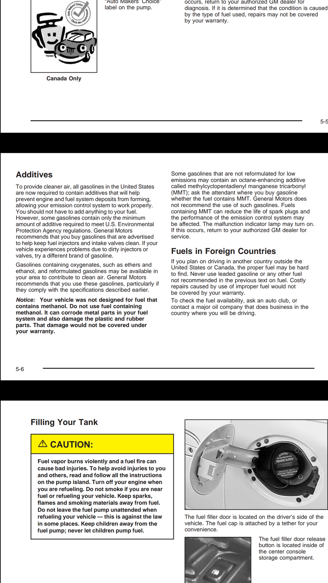

I don't like gasoline with ethanol, if I could get 100% gas I would use it even if more expensive but I believe the owners manual states that GM does not recommend using fuels with the additive MMT, I think ethanol replaced MMT as an additive and MMT is no longer used.
Old Apr 28, 2017 | 11:32 PM
grantv's Avatar
grantv
Joined: Sep 2014
Posts: 5,278
Likes: 539
From: Kelowna BC
Originally Posted by JR-01
No it doesn't.
Yep agreed, just DL'd this from a 2004 manual (not Z specific so I'll do another later), and...:
Ethanol recommended by GM, methanol and MMT are no-no's.
