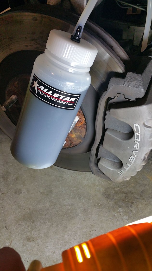

I do mine by pumping the reservoir completely dry with one of these..
and refilling with new fluid. Then I attach my preasure bleeder..
Pump it up to the recommended psi, and open the bleeder valves.. RR, LR, RF, LF checking and refilling the reservoir when it's about 1/4 full.
I can see when clean fluid makes it out to my bleeder bottle, that also has a magnet that'll stick it to the rotor. A one man job, that can almost be done one handed. Since I couldn't figure out any other way to bleed through the ABS pump at home I crank the car, put it in gear, let the pump activate a hand full of times, then repeat the process.
