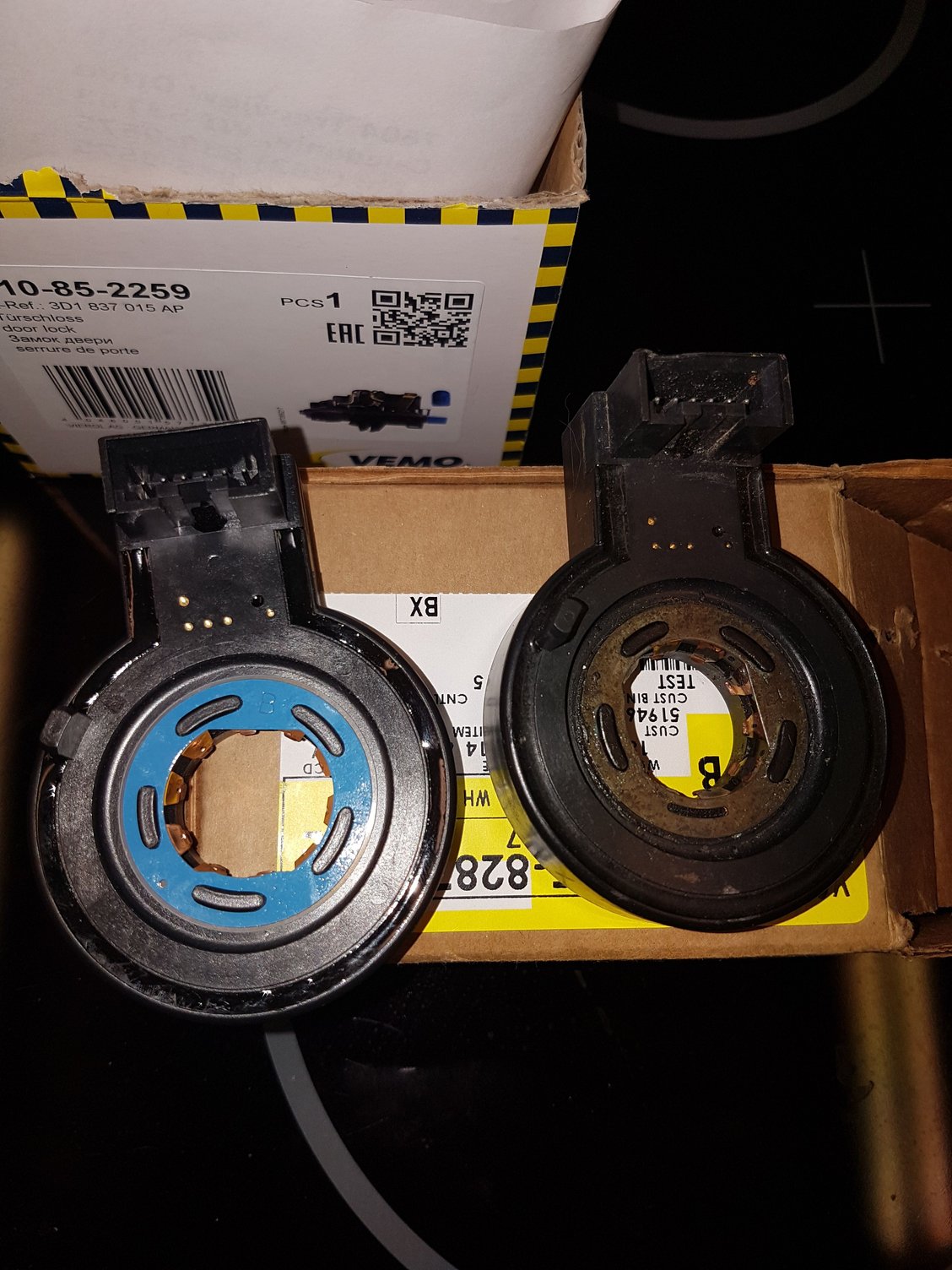

I have a 00 and bought a spare (new) SWPS GM 26058287 Position Sensor for Cadillac Seville ( 98 & 99 mod) This SWPS has the same wiring and same signals according to my manual . It also looks 100% the same when I compare it with a old spare Corvette 00 SWPS (26058286).
The new Cadillac sensor is the left one
Already thought of that one, and I am going to be testing the theory. Just need to hit the junkyard and get one, because I am not spending $200 on a maybe.
