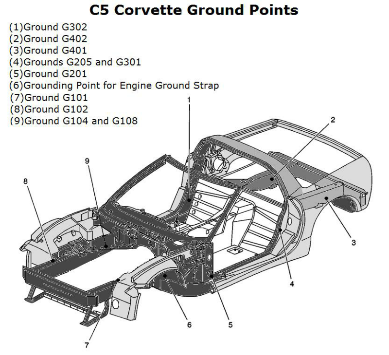

Check your Ground points! do a search, there's tons of info on this little gremlin.
I agree. Pull them off and clean them. Not a big job, at all.

Thanks for all the recommendations guys! I have tried EVERYTHING y'all have mentioned. Checked the fuses, cleaned all the grounds in the engine bay (which were all filthy btw), replaced the battery, but unfortunately it's still intermittent as it has been.

D. Grounding strap issue
E. Frayed Wires
F. Moisture has entered one or more ECUs or Control Modules.
G. A bad sensor or actuator which is not reporting required information or closing a circuit loop
Follow the posts pointing out the grounding straps and loose connection informational replies and go through a process of elimination.
