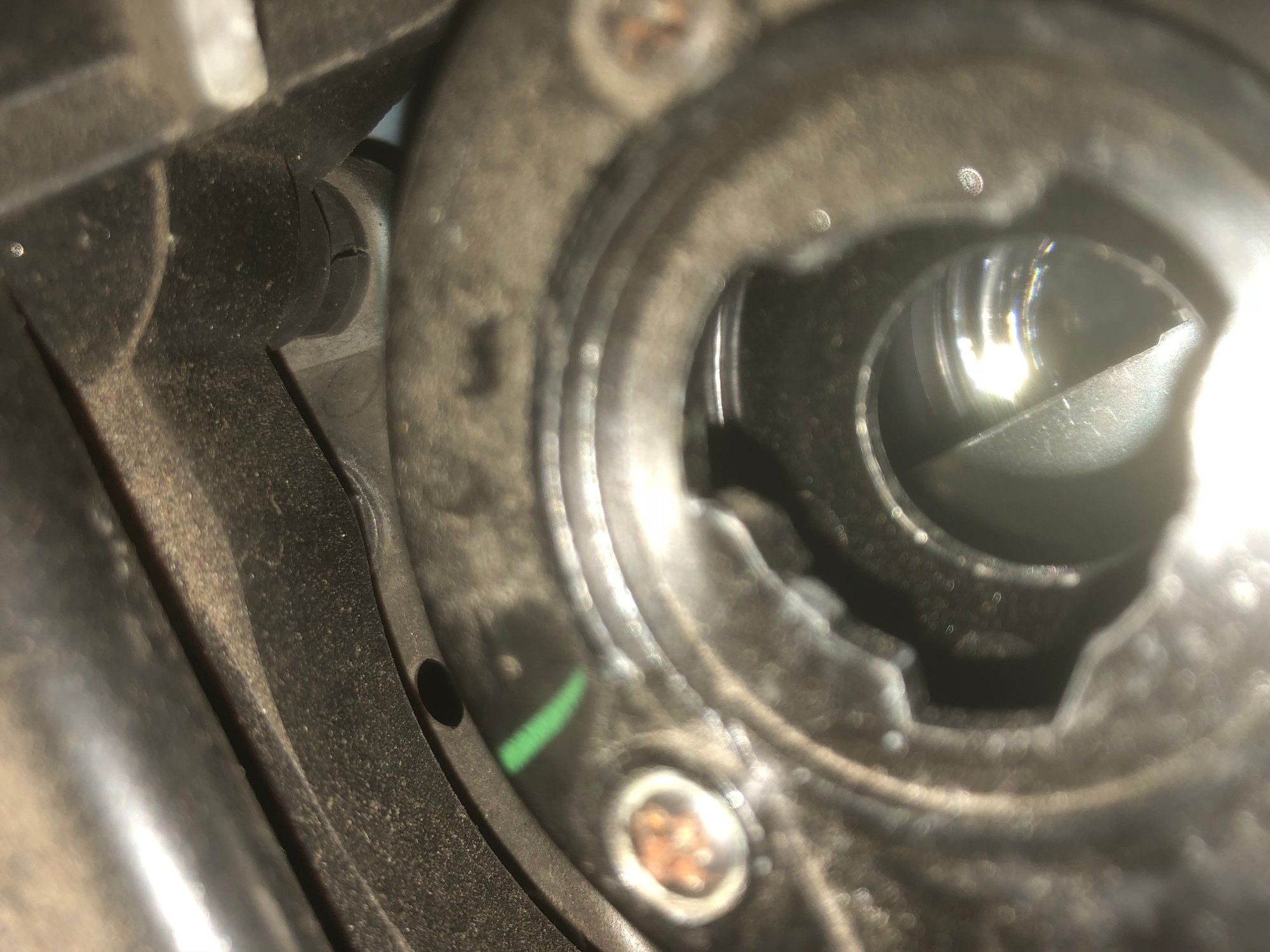

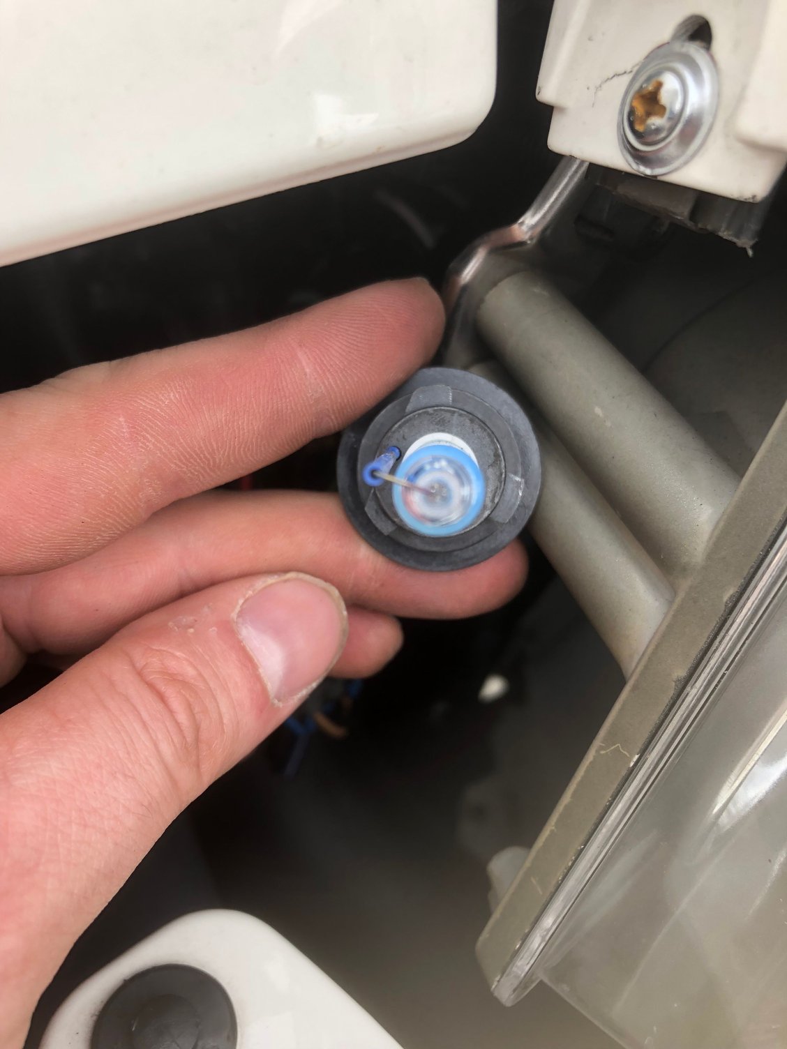

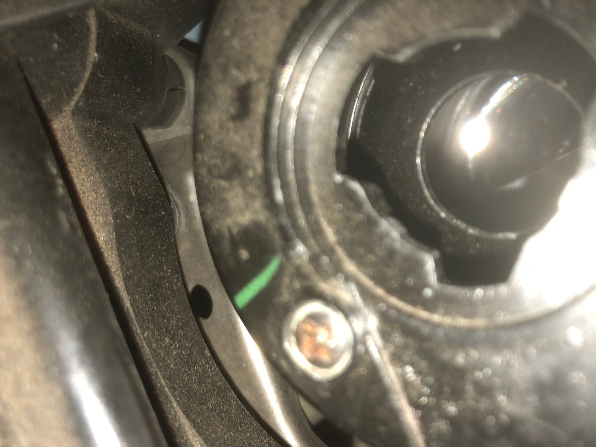

Here are the pics...def not an H1 fit...
This is the other one w a bulb in

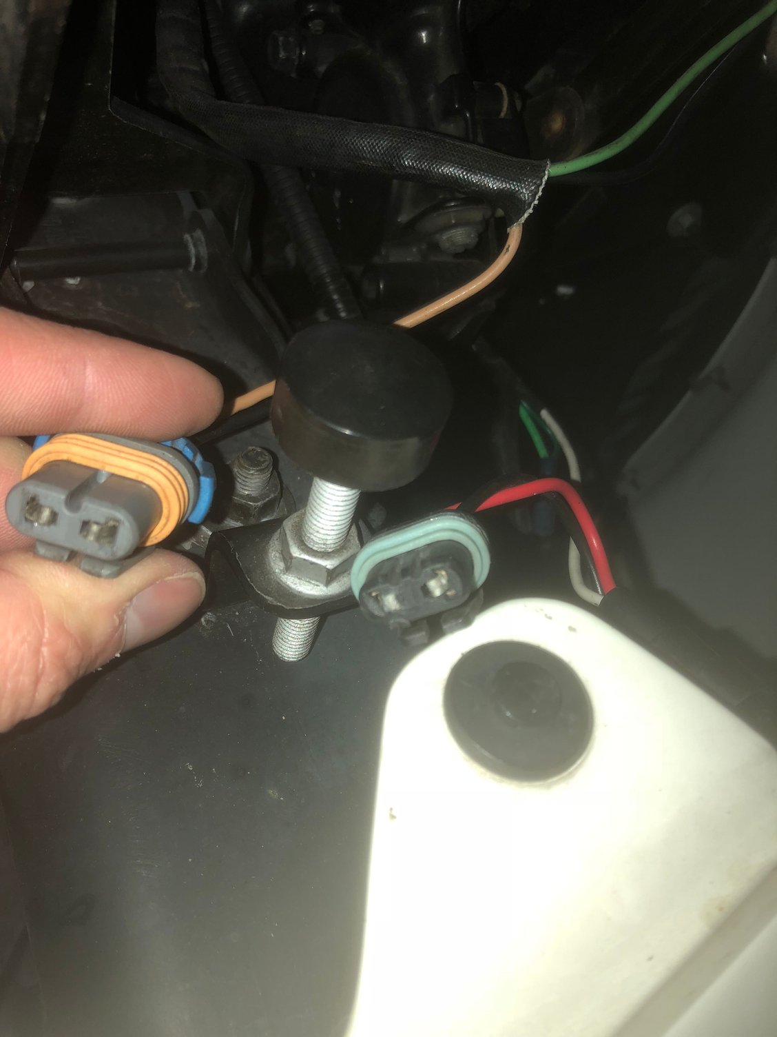

And see the connectors....
You have the replica ACA projectors. Those use a H9 bulb. There should have been a harness supplied with it to adapt 9006 to H9. The harness as I recall also uses relays connected to the battery to enable high-4 operation, and I believe the plug with the red and black wires is part of that harness. I don't recall how it should be plugged, but I believe both stock connectors should plug into the harness, and then the harness to the bulbs. I've cut up my harness to adapt for my own needs, so I can't help much there.

That makes sense thank you for your input. Anyone have any instructions on how to connect? A link? Sure these are replicas? Guess it is an eBay replica? What a bummer!

Replicas were the only ones available after ACA went out of business. The original ACAs used D1S HID bulbs. There are two types of replicas, the $350 Taiwan replicas (which Radioflyer and JWM use), and the cheap $150 Chinese replicas.

Any help on why these bulbs are not locking in to the replica ACA projectors!?? Am I missing something here. They fit in just don’t lock in and jiggle.

A possible cause.............
The HID bulbs that I have used before had an O ring above the locking ears to keep everything snug

Is this the O ring? I tried it before and it seemed to not fit so I took it off....then was too loose. Maybe it is on backwards if this is what is needed?
