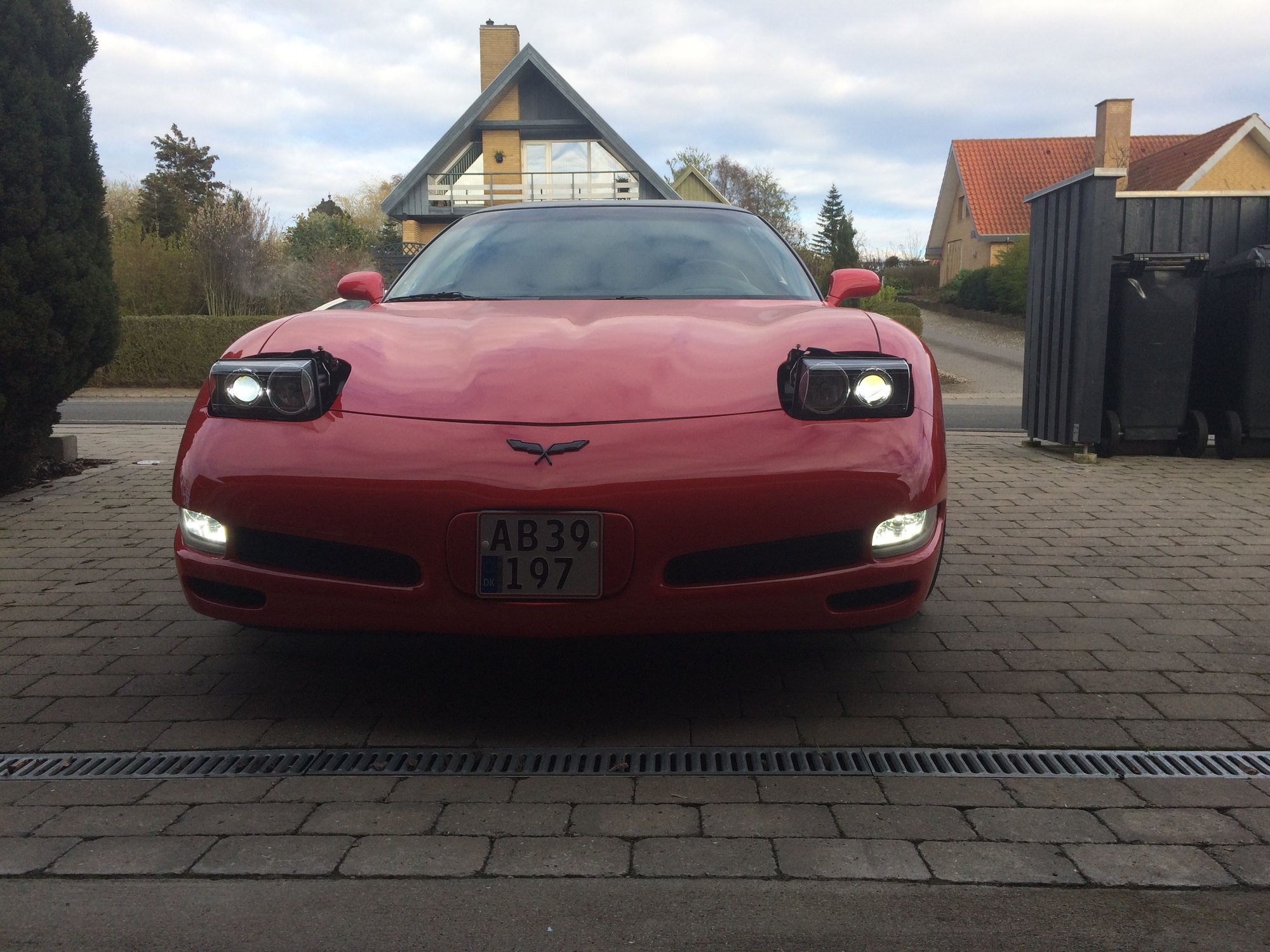

This is the modified ACA´s from RadioFlyer with 6K LED´s in both low and high beam. George provided a resistor to the harness in order to have enough draw to raise the head lights. Everything works perfect

How well is the output? Id have these rather than the hids, but cant justify paying $600 for them when I can get the halogen ones for $230 including shipping.

I dont know the output compared to HID´s - as I went from OEM head lights to these. But these are a huge satisfaction over the OEM´s and really lightens up the road. These ACA´s from RadioFlyer is also modded, as George repositions the hi-beam lens so it´s actually functional.
You could email George if he doesn´t see this thread - I´m sure he can inform you about the light output compared to HID´s.
