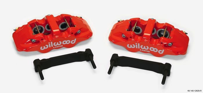

If you're around on Monday and would like to take a look at what makes big brake kits both different and superior to the stock C6 parts feel free to swing by. *A hectic day however as I'm out for a double race weekend right after that.
From Aero6 caliper kits on stock rotors to full on 14" and larger big brake kits you'll find the benefits worth considering. And not nearly at 3X the price.

Wilwood makes direct replacement calipers and rotors for C5's that will be an improvement without breaking the bank. Check out the current issue of Vette magazine.

* True
However know that the SLC56 caliper kits fit only the stock 12" rotors and are not a track use application. Nothing wrong with that...just understand their purpose in life: a nice replacement for the aging stock caliper.
Because the OP was discussing C6 Z06 brakes I'm making the assumption they are after brake performance gains not just replacement parts. The Z06 offering the larger six pot caliper on a 14" rotor. In that size class you'd be moving into the more serious model caliper the Aero line and possibly full size BBK with 2pc hat and rotor.
Both very good products, but both in entirely different markets.
