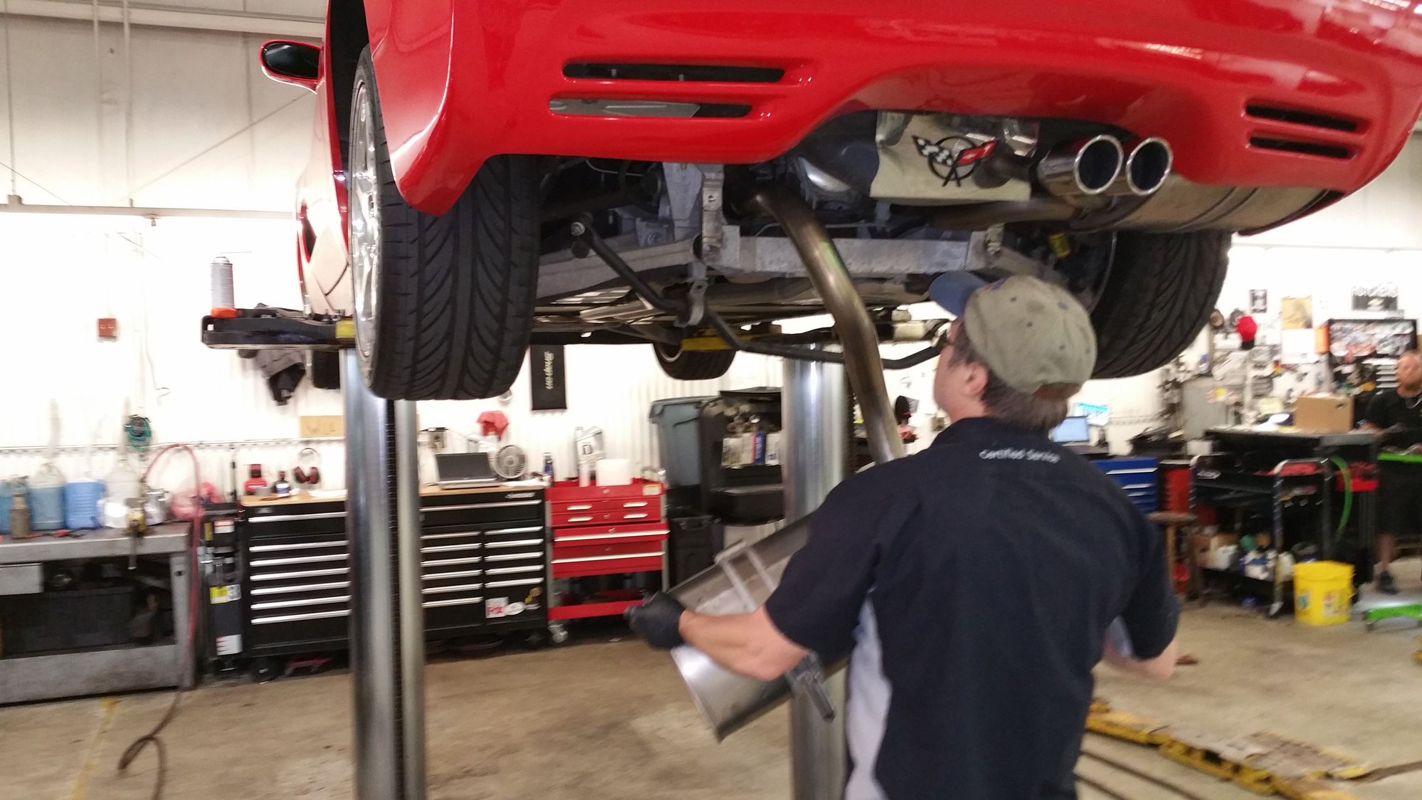

Yes and 2 flange bolts on each side at end of pipe
see pic above...
