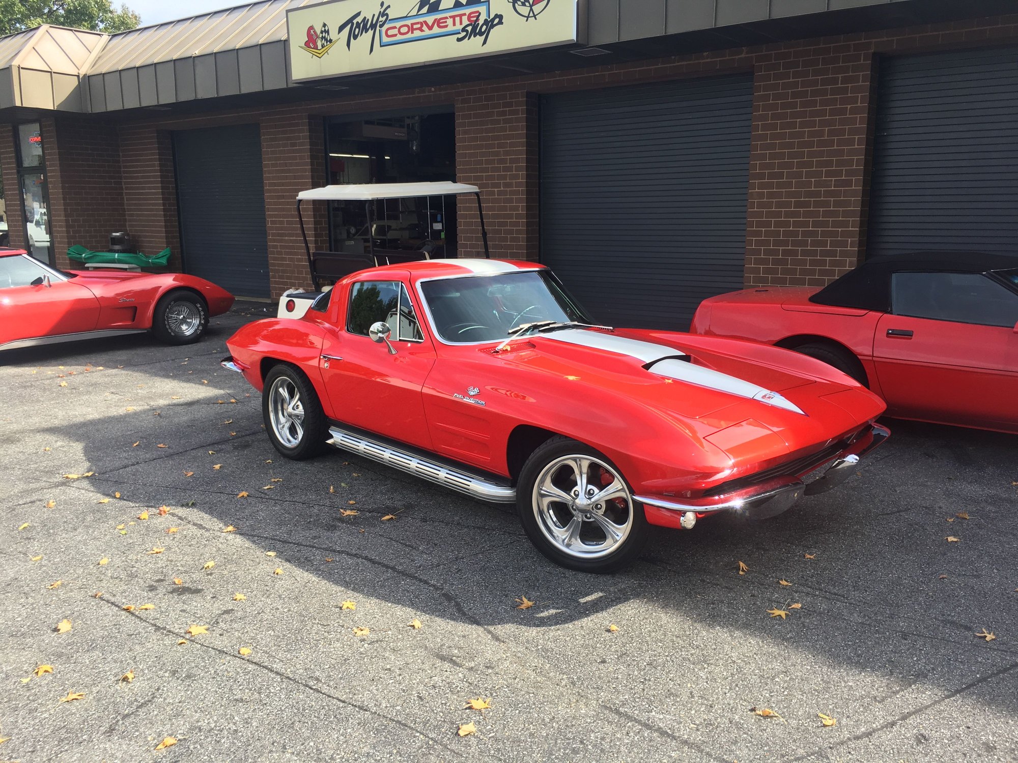

Also got to see this beaut while I was dropping mine off. Love it

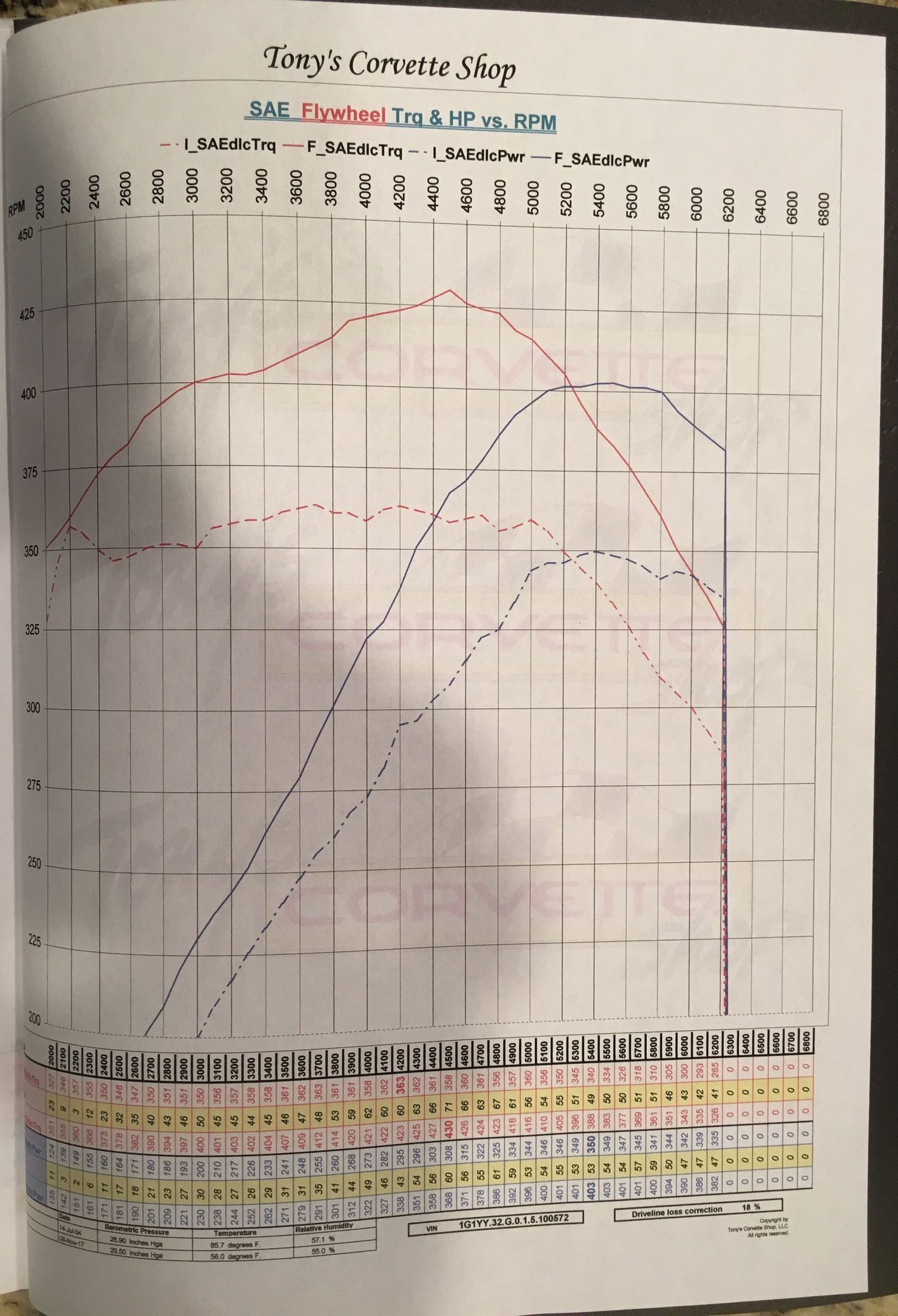

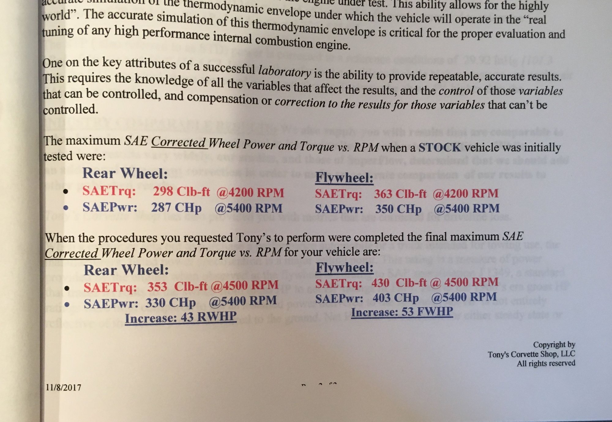

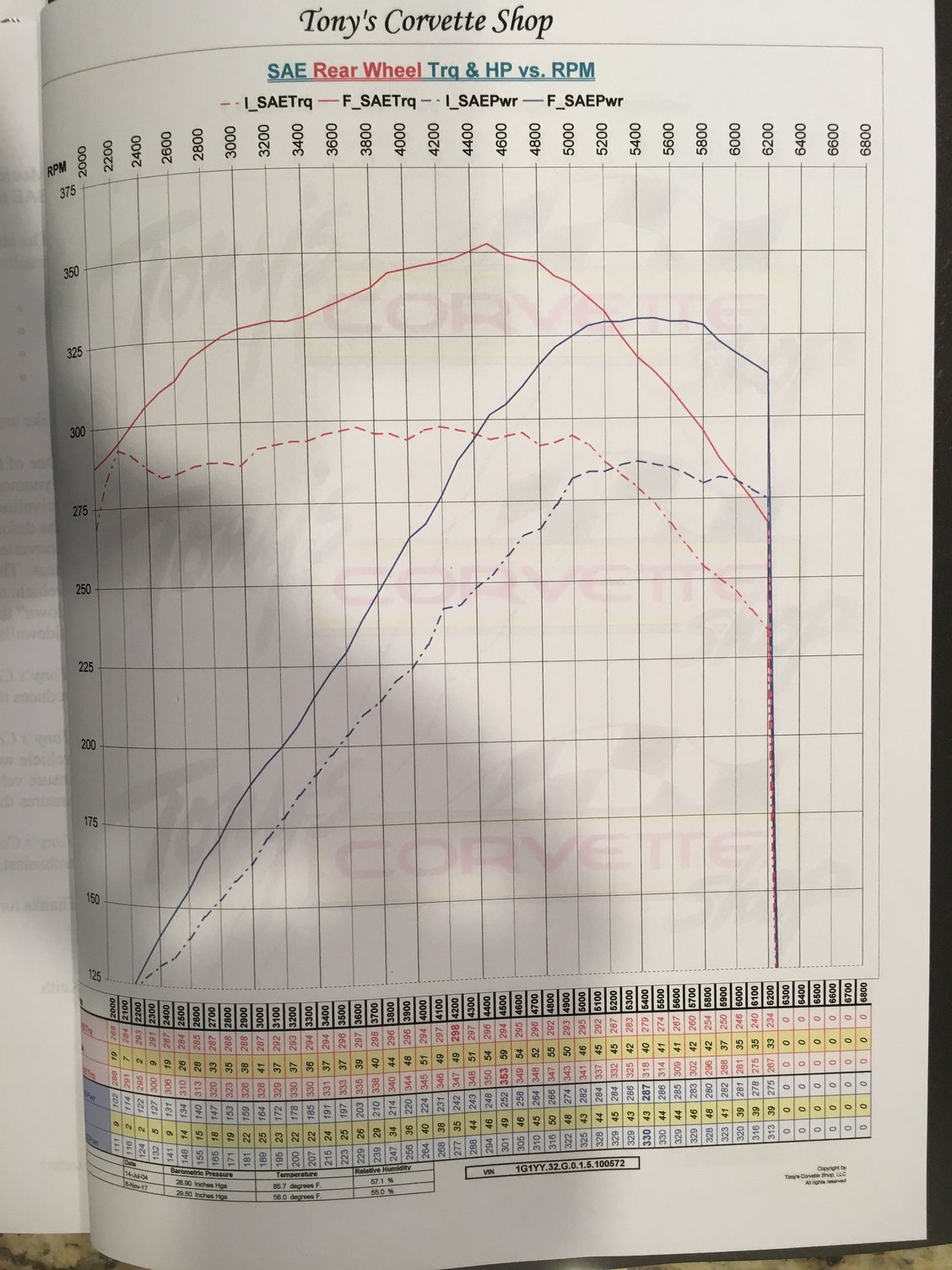

Just got my vette back from the shop. I went ahead with the mods noted. Stainless AR headers 1-7/8”, 3” LT and X-pipe. I was impressed by the results. Supercharger is next for A&A. I didn’t want to be that guy that didn’t post his results. So here you go.

Nice work. Is that with or without changes to the factory tune?
Old Nov 9, 2017 | 02:11 PM
  #40
Bmore2OC's Avatar
Bmore2OC
Joined: Feb 2017
Posts: 100
Likes: 12
From: Baltimore Maryland
I’m the 3rd owner so I’m not 100% sure but I believe other than the Corsa catbacks, everything was stock. The first dyno I think confirms that, maybe someone else can chime in on that. I think that’s right where they should’ve been straight from the factory.
