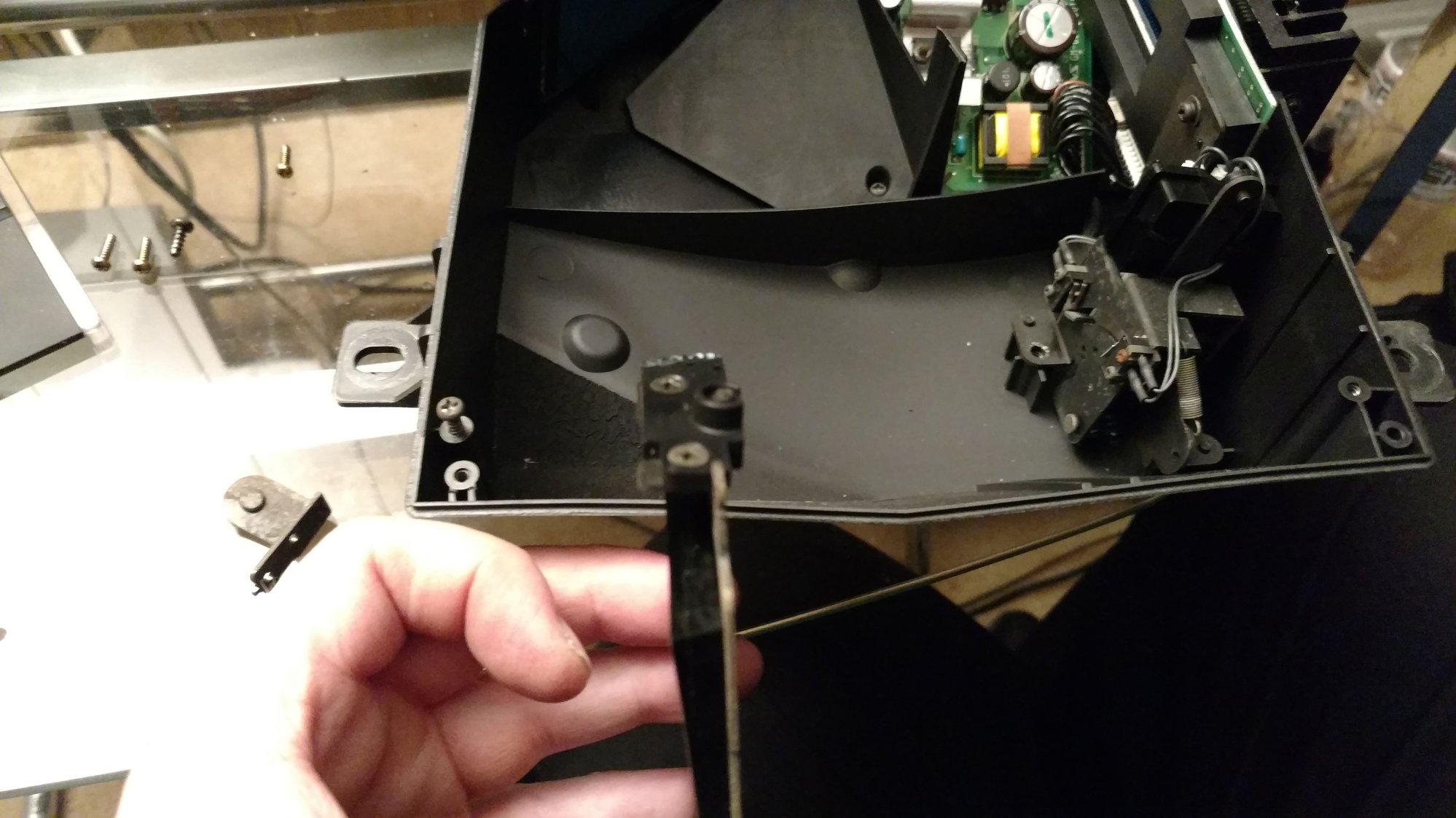

Hello forum. I own a 2002 Z06 and just got the dreaded HUD drop. So I'm looking for help to fix this. Or someone that fixes these for people in my area or a hundred or so miles. I'm in the upper West Ohio area Findlay

If you're somewhat mechanically inclined it's not a hard fix. It's just taking all the stuff out to get to it. Here's a start.
https://www.corvetteforum.com/forums/c5-tech/2453423-diy-fix-for-the-dreaded-falling-hud-display.html

This is a very well documented fix. I used the above for mine about 6 months ago. Just give yourself time and go slow. Could probably add a double din HU while you have everything apart... LED upgrade would be good too since you will have the instrument cluster out.
When putting back together, test. After fixing the HUD, I plugged it (and the instrument cluster) back in and started the car. Wanted to make sure that I lined up the mirror correctly. My fail was not connecting the emergency flasher plug... Got everything put back together and had NO blinkers...

Default Dash out HUD out
Thanks for the info took about an hour to get the dash and HUD out, now looking for a screw to put in place of the worn out pin.

Default HUD in and working
OK my HUD never worked like it does now it goes all the way up out of sight and all the way down. The job was very easy and did it by myself took around an hour to take out putting it back in I'm taking my time. Once again thanks to everyone on this forum for all your help.
