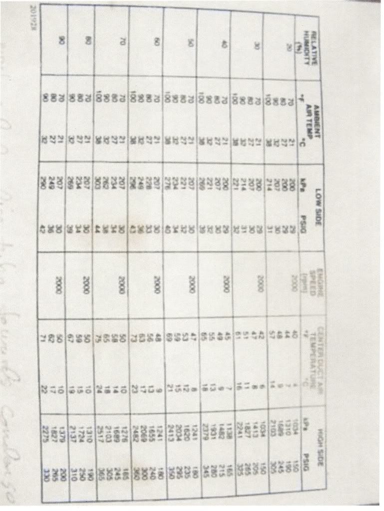

I, personally, would never blindly add refrigerant just looking at the low side pressure and not knowing what's happening to the high side during the process.
Refrigerant pressures depend not only on the ambient temperature, but also on humidity and the RPMs of the engine.
Take a look at this post. It has detailed instructions to check/add refrigerant and a pressures chart that take into consideration all relevant parameters.
I honestly never thought there was that much to a system. I either had cars that never had a problem or never had ac. Thanks for the info I'll keep that in mind.
