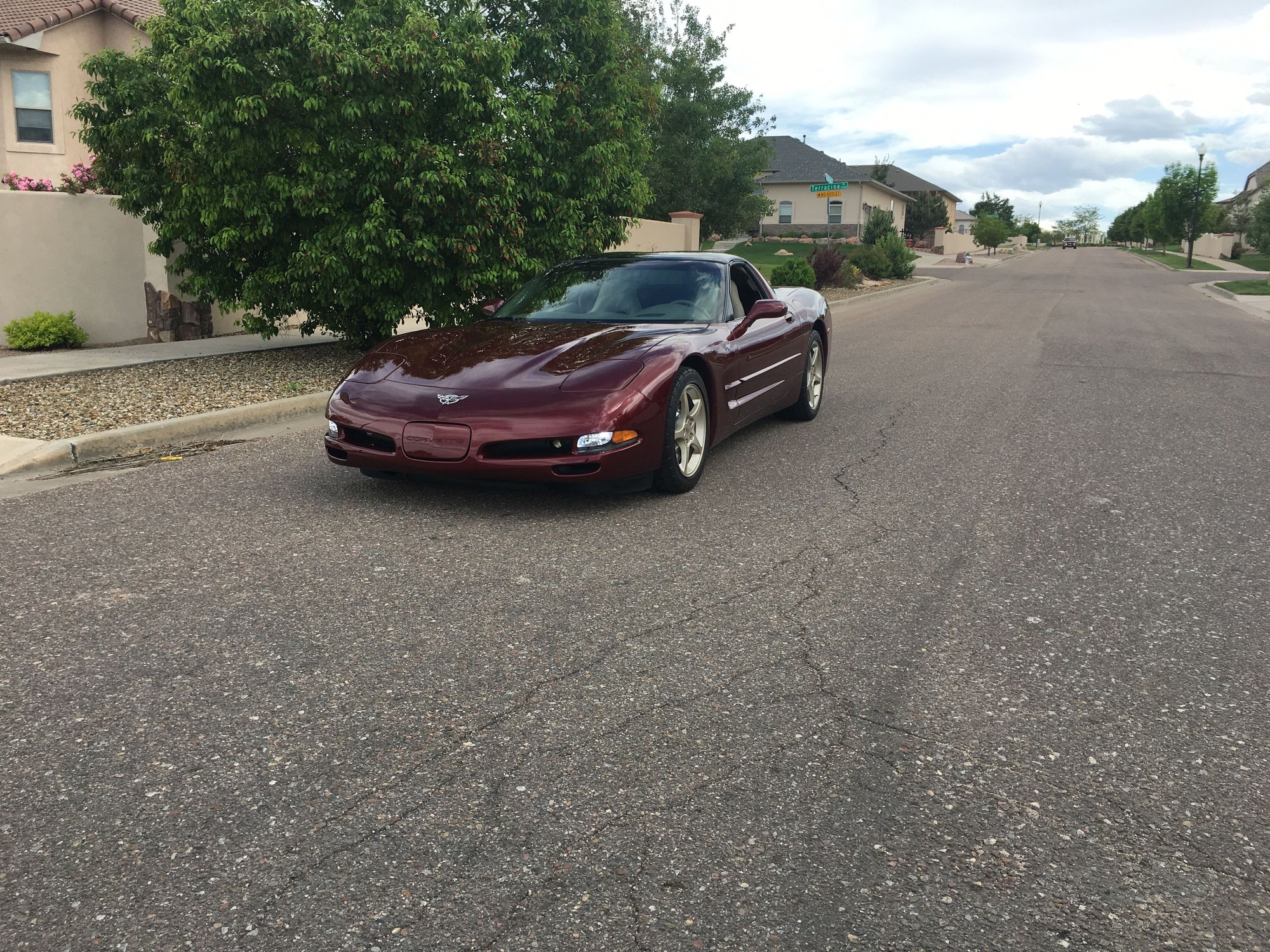

I loooooove mine. Totally optioned out Radio Flyer Innovations parts George makes some amazing stuff, you should check out his website. Plus, he is a forum vendor
I have had mine for years. I have lots of other pics if you want me to post them. Most from when I was mostly stock.

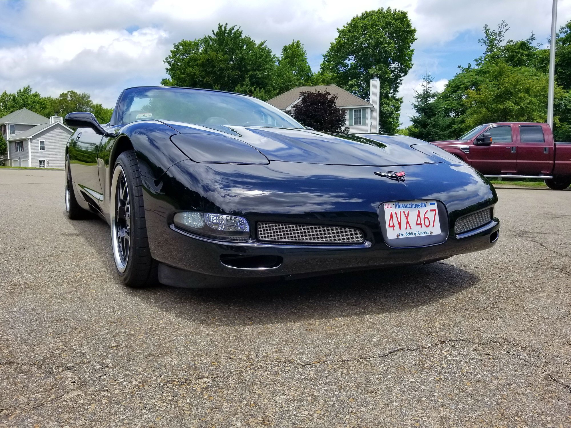

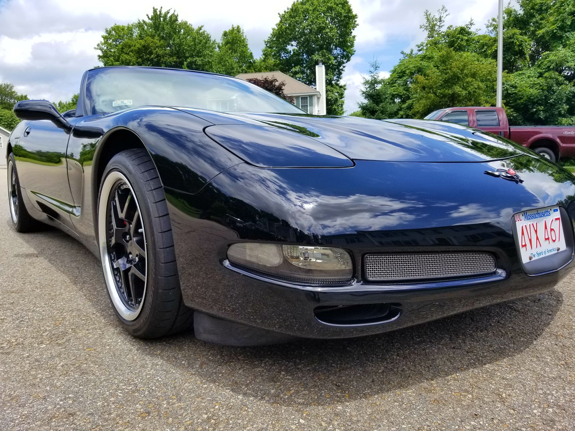

I don't have any amber bulbs. My side marker lights are just side markers. From the factory they were amber, but I used a clear LED there. This pic is with the lights on (only parking lights are on)

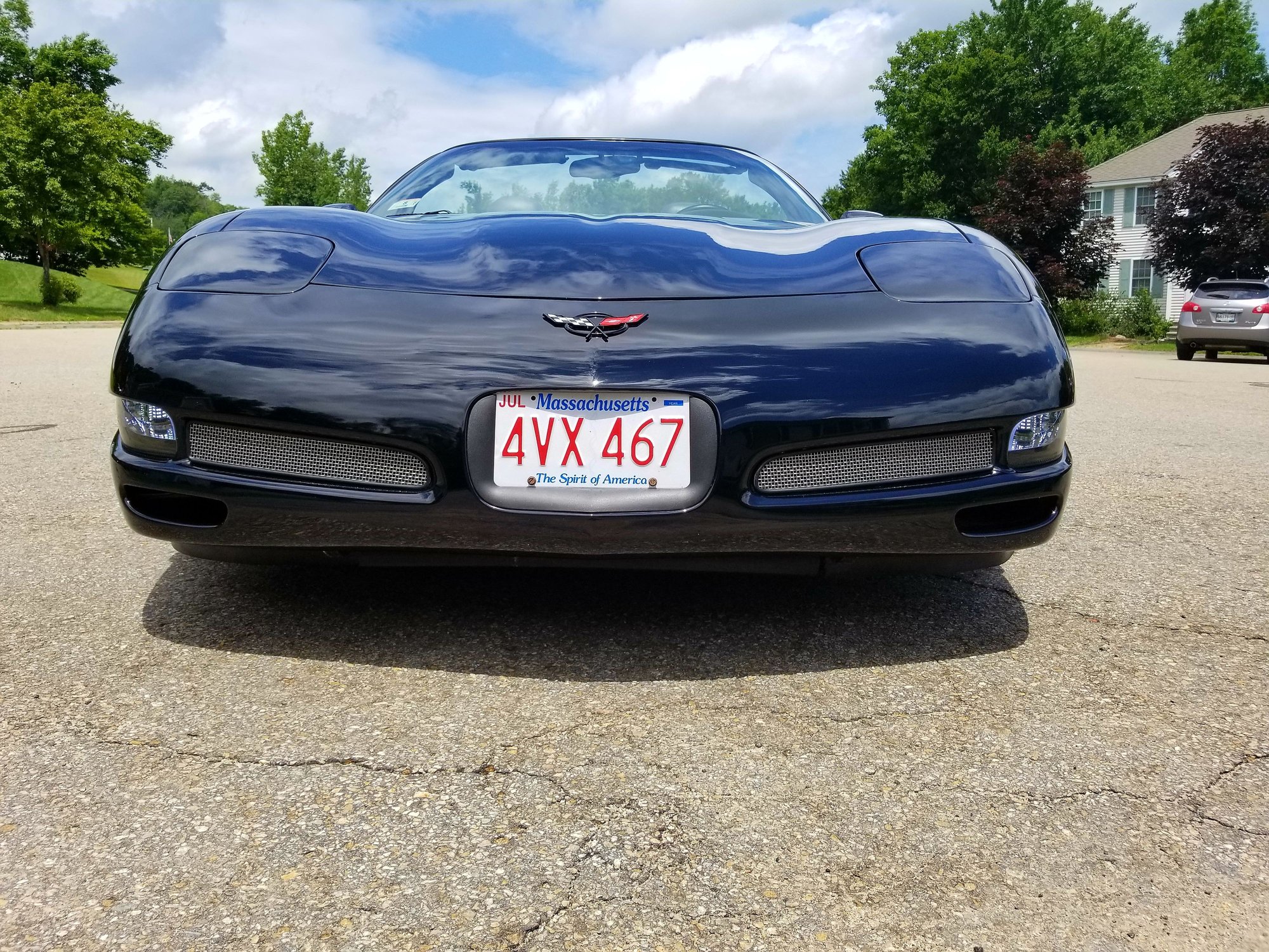

The DRL is the switchback LED. When in DRL mode, it's amber, and will blink amber for the signal (when the lights are off). Shown here:
When the lights are on (show above in the first pic), the signal then switches from clear to then blink amber. I don't have a pic showing the amber signal WITH the clear side marker LED.

I see what you're saying about ErikwithAK's picture. He has his lights on (indicated by the fog's) and he's got the amber/clear vs mine with all clear with lights on. Mine are only amber when in DRL mode, and ALL signals (lights on or off). My side markers don't blink, ever. They are as strict in MA about the side marker being amber (although they were and probably should be).
