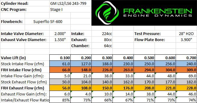

Originally Posted by sean.b
if you're adding the springs and doing the machine work and cleaning.. thats not bad. thats closer to $500 for the p/p. do you have flow #s for 241 and 243 heads you do?
sean.b,
You can expect 6-8 less cfm with the 241s. Our 241/853 program is absolutely no slouch.
-Russ

thats more than PRC 2.5's from the factory, and for $300 less. dayum.
so if i sent you some heads, and wanted to flow bench them after you're done, you'll guarantee (give or take a %) results like that?
if thats the case, this is a no brainer service.
sean.b,
As much as I'd love to, if I did it for you I'd have to do it for the world. I don't have the manning for that lol. Also, our retail is $1150 for this setup but since I made a typo, I'll eat the $100. We just finished our $1050 sale so it basically became habit lol.
-Russ
