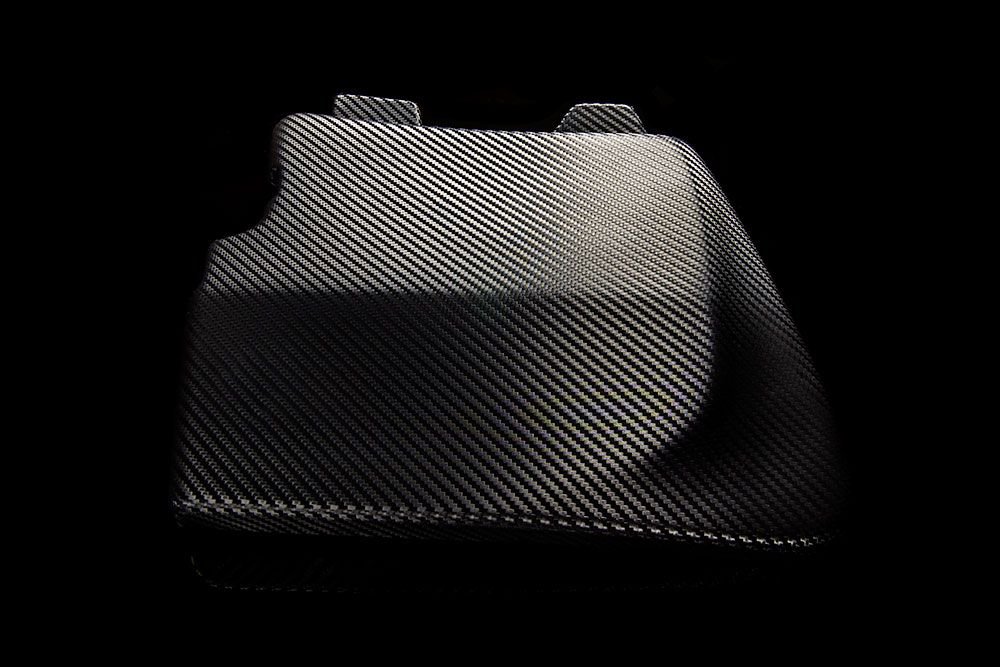

Picked up a battery cover from American custom industries when I was in Carlisle a couple years ago. Finally painted it but can't figure out how it should be attached. It has 2 tabs but I'm not sure how that figures into the equation. I tried double stick tape but that didn't seem right.
Here's a picture of it.

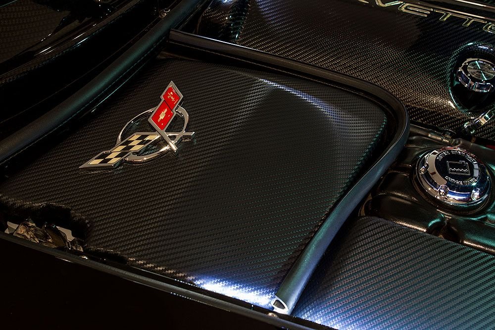

I have the same cover. You got the Velcro part right. Those two tabs slide between the cowl and the hood release cable, just for stability.

Between the hood release cable and the cowl...ok. I though that might be a possibility but the release cable was so tight I kind of weinied out of wedging it in there. I'll give it another go.

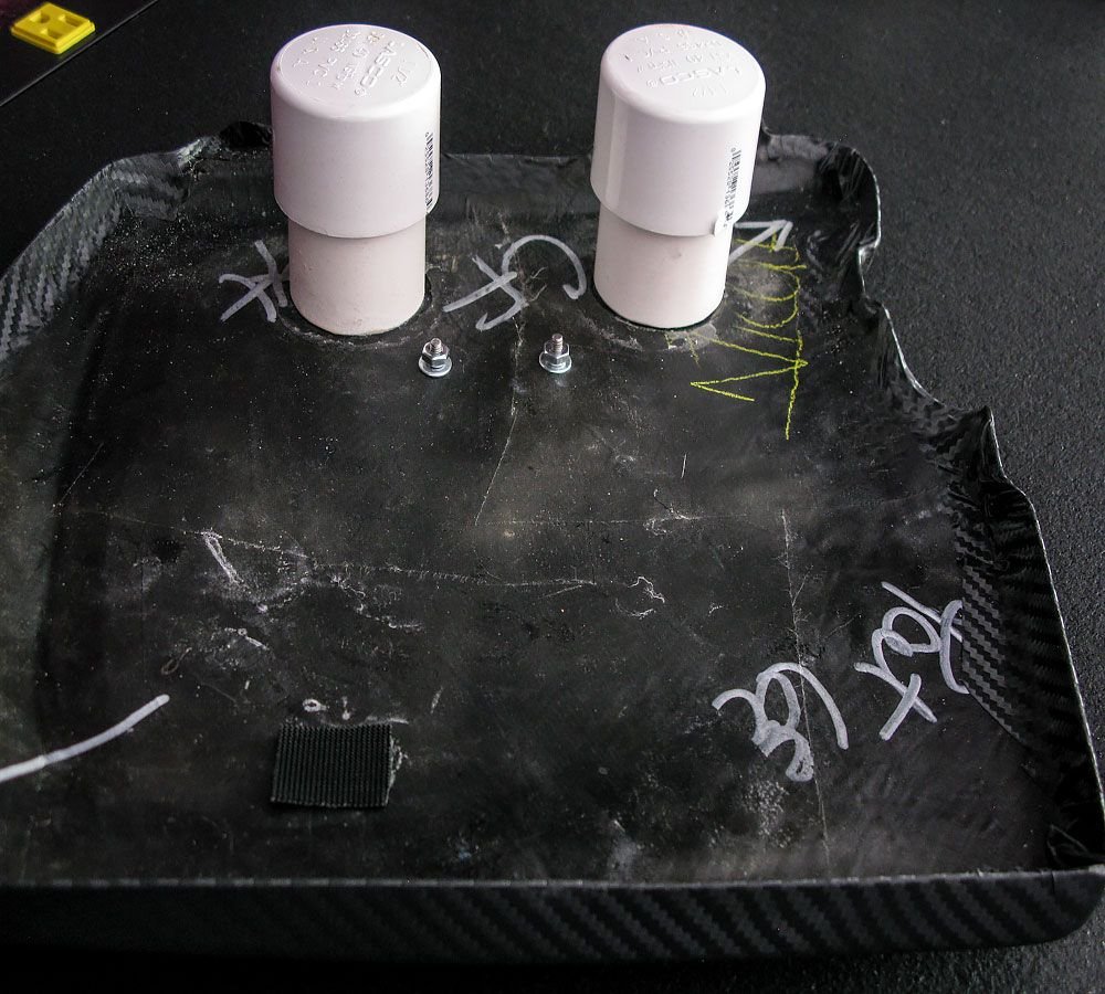

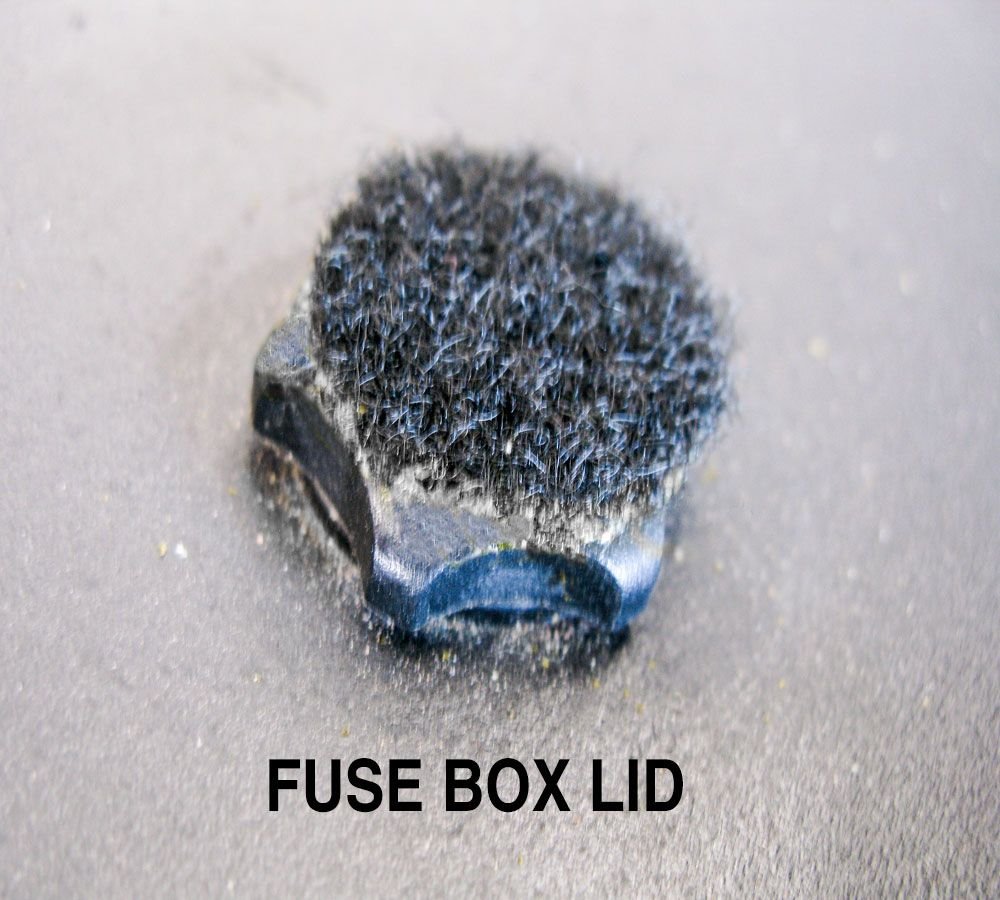

Looks like the same cover I have. I did not want to try to wedge the rear tabs under the cable, so in my case I epoxied two short PVC pieces of 1-1/2" pipe with PVC end caps to the bottom of the cover so that they rest on top of the battery at just the right height and only applied velcro to the fuse box removal **** on the front. Has worked perfectly for several years and allows quick removal. Don't actually have any pics of the bottom of the cover, but can post some if needed...

I was half right. I came across a diagram I made many moons ago about this. I used Velcro on one of the tabs, too.
