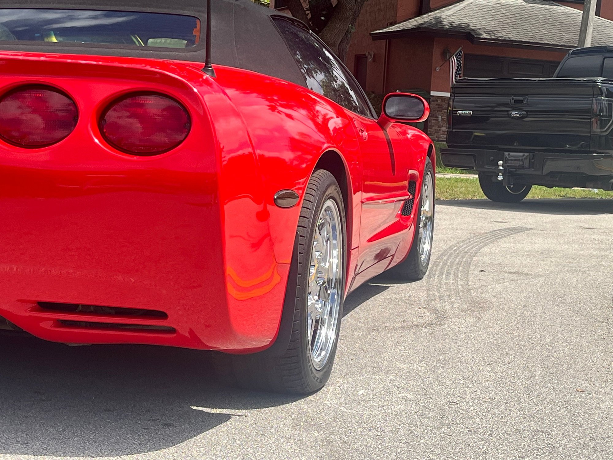

Default Just installed
I applied some heat to them to form them a little better to the body, after they where installed

Going to paint them glossy black later on.
