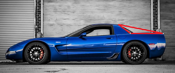

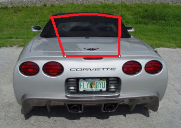

a roof extension (maybe out of alumilite?) could mimic the coupes aerodynamics (and maybe improve on them)
sorry for my quality
essentially trying to move towards a look similar to this:

Thank you for those articles gives me more to think about. Really the FRC is not a good starting point for Aero. Oh well gives me something to do over the winter and test in the Spring. Wish I had a wind tunnel close.
