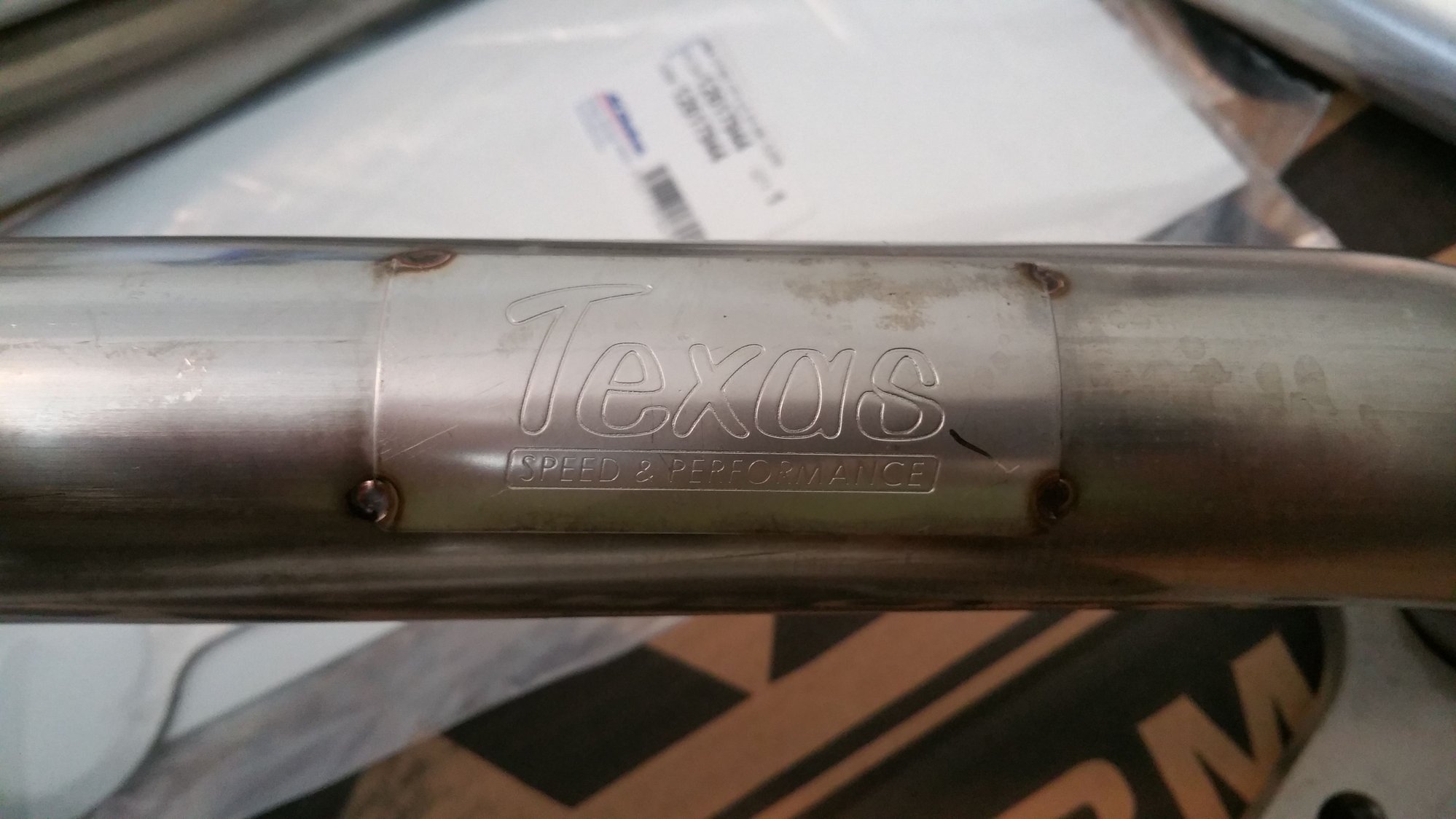

Nice Texas Speed plaque.

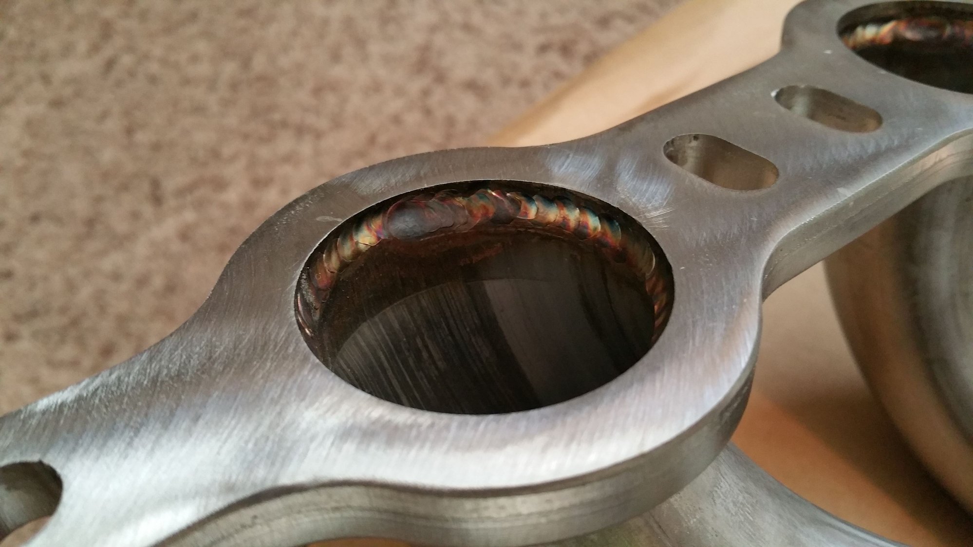

Nice welds on the primaries to the flange. Nicely flat and finished flange also.

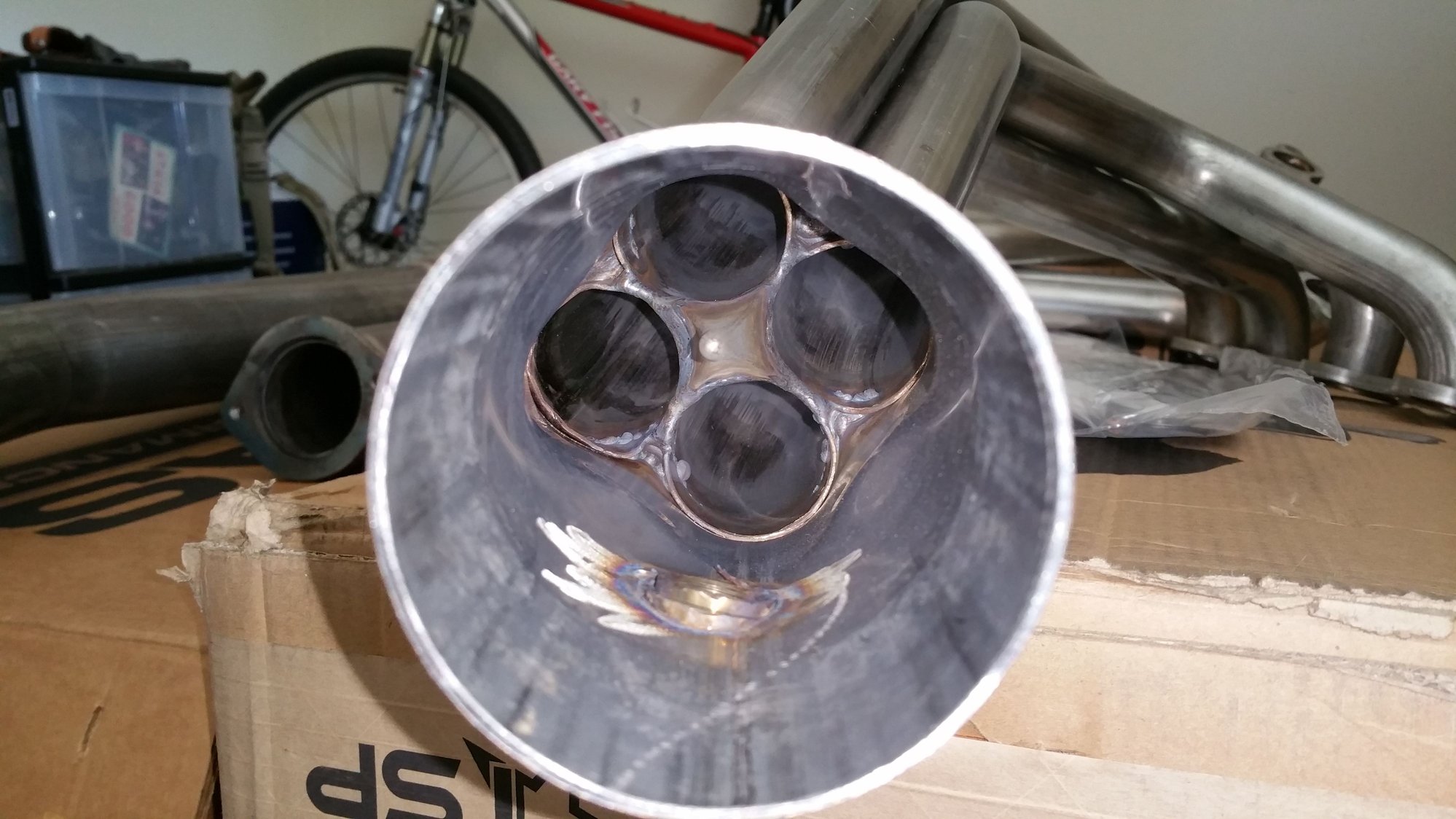

Collector spike in the collector.

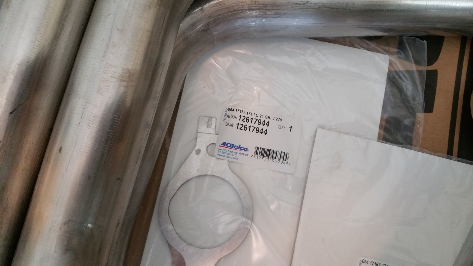

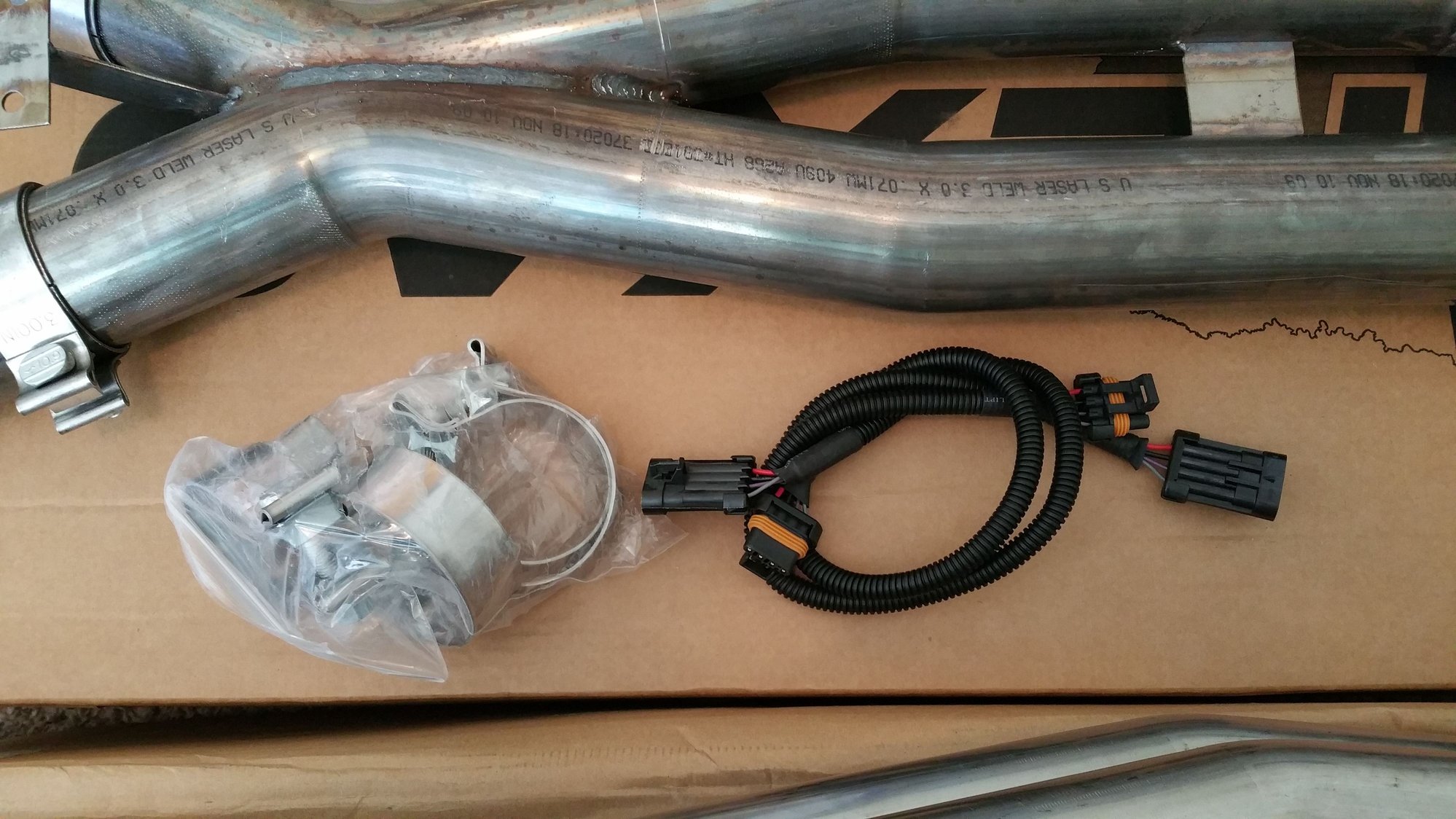

The headers come with AC Delco gaskets and O2 extensions. There are no O2 bungs in the X-pipe but that really doesn't matter as most people just disable those.

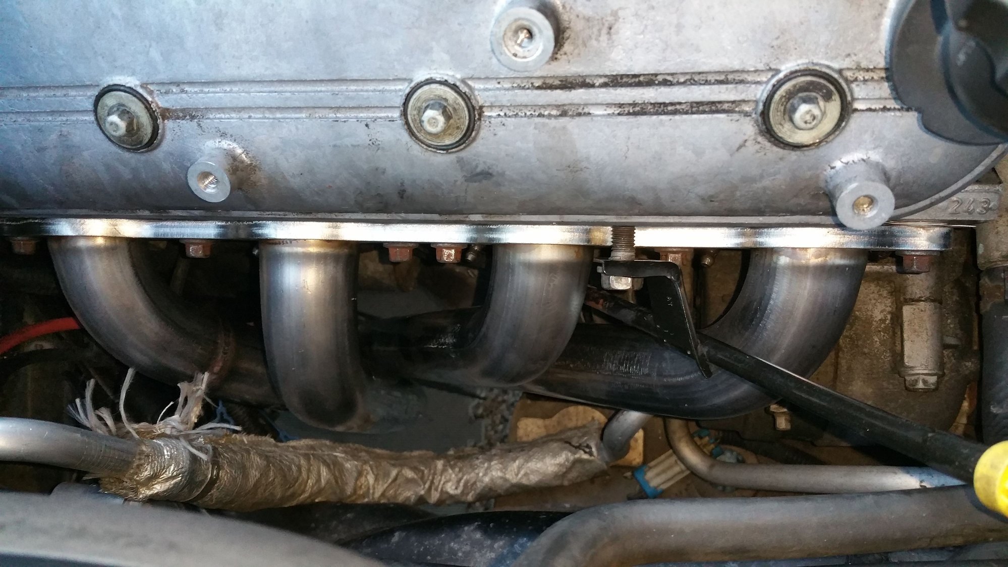

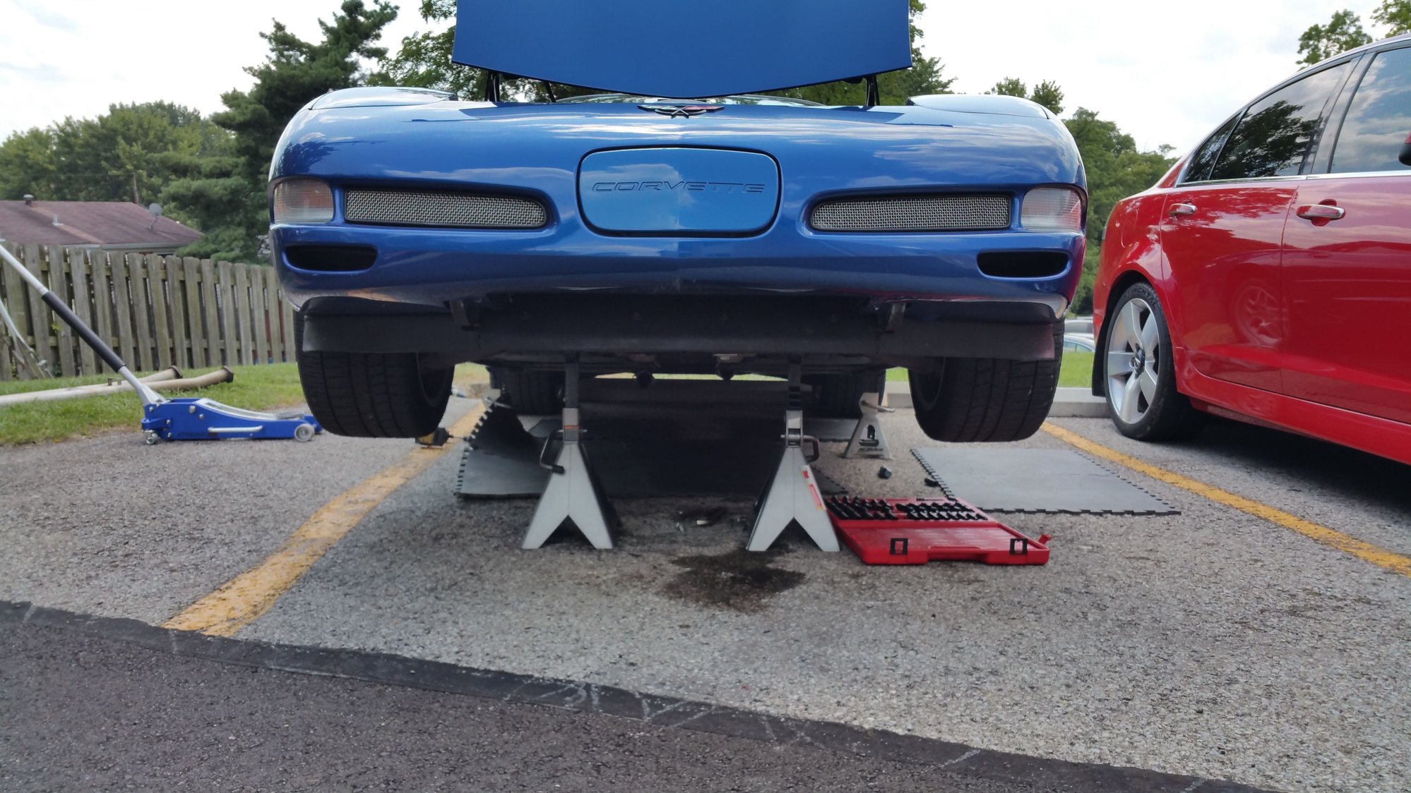

I got as far as installing the left and right headers which is the hardest part. On the driver's side, I did not disconnect the steering shaft but I did remove the lower engine mount bolt and jack the engine up about and inch. Along with doing this and removing the driver's side valve cover, I was able to just barely get the header in from the top.
Plenty of clearance from everything and no interferences with anything. Nice!

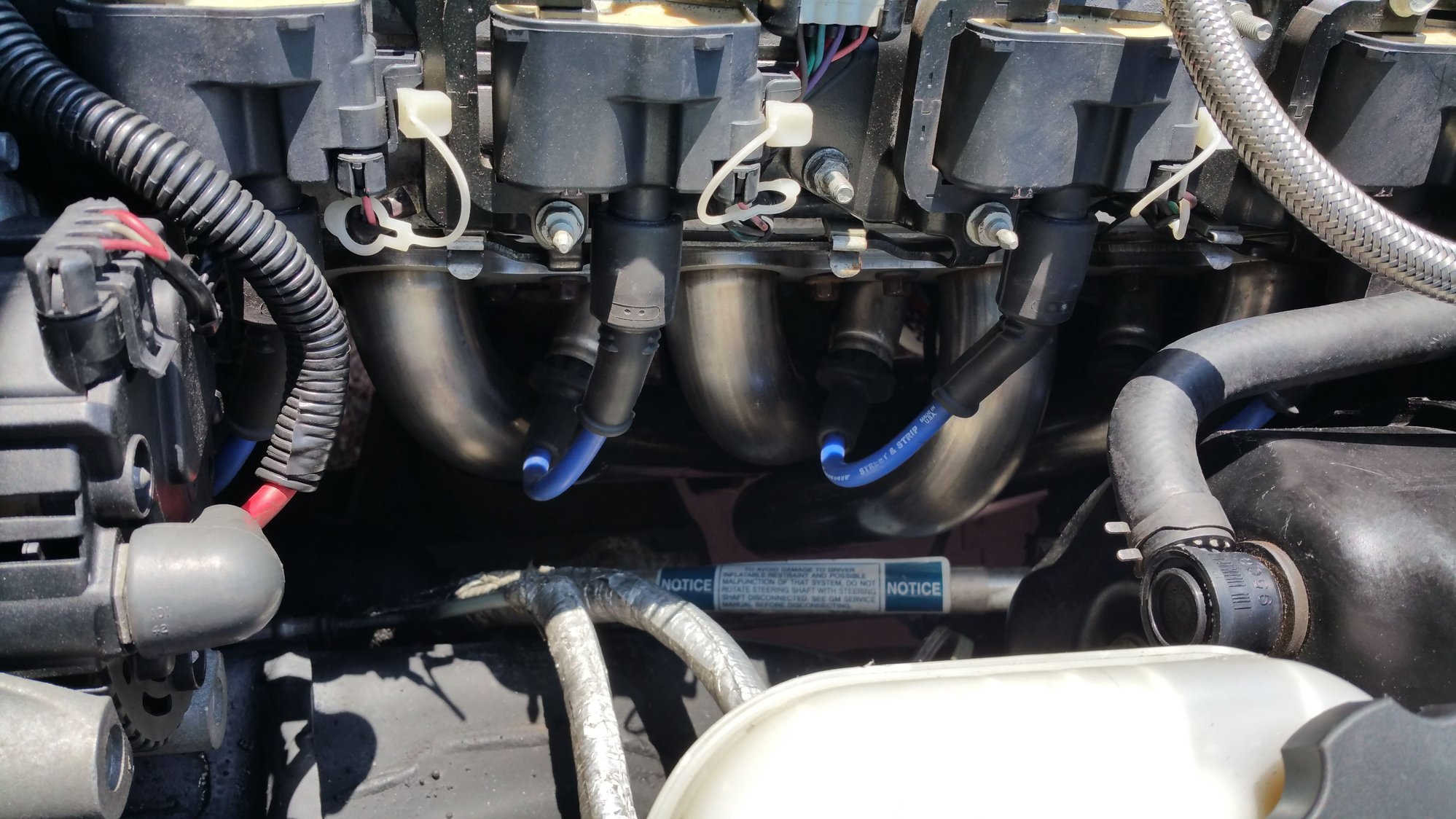

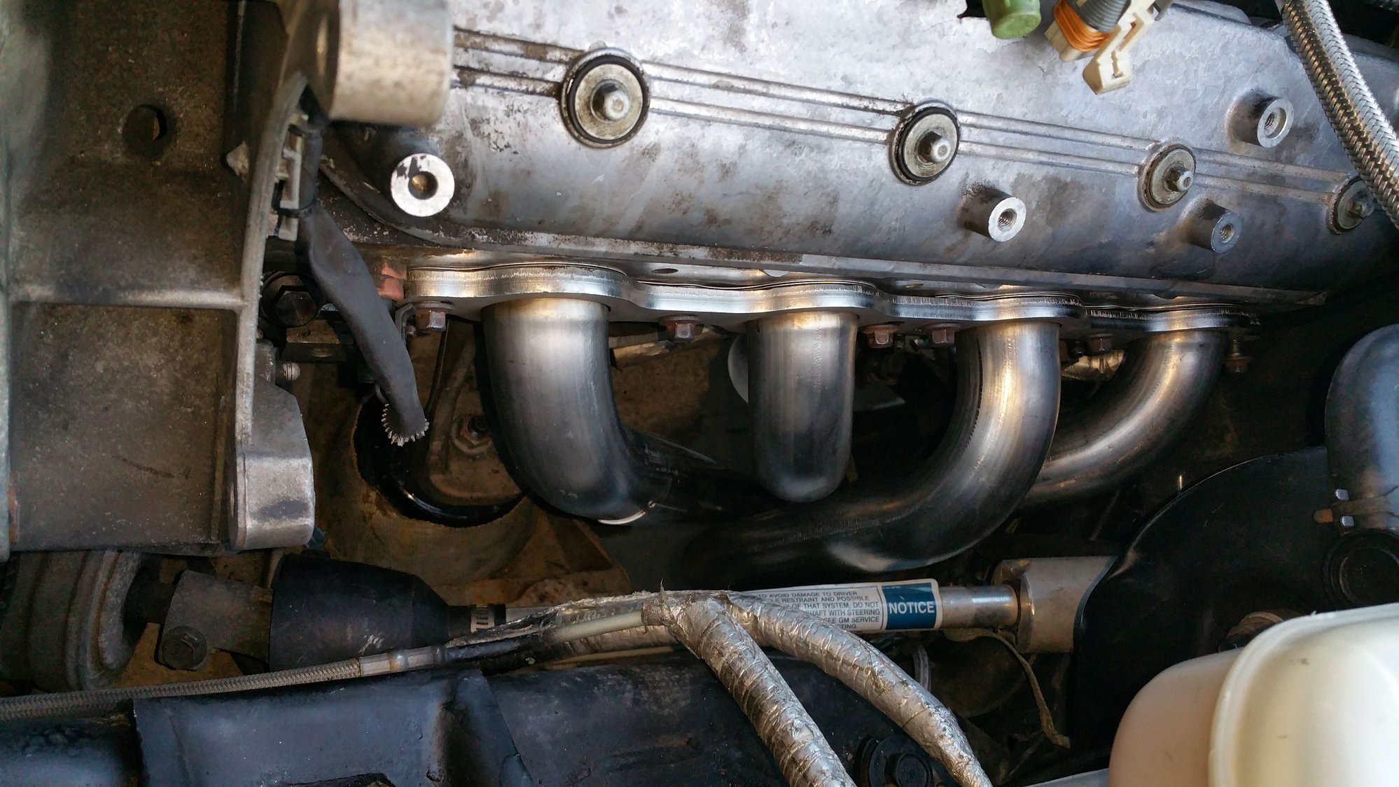

Passenger side also went in from the top. I unbolted the starter and moved it out of the way and also the valve cover. Went in pretty easy. Again, no interferences with anything and plenty of clearance all around.

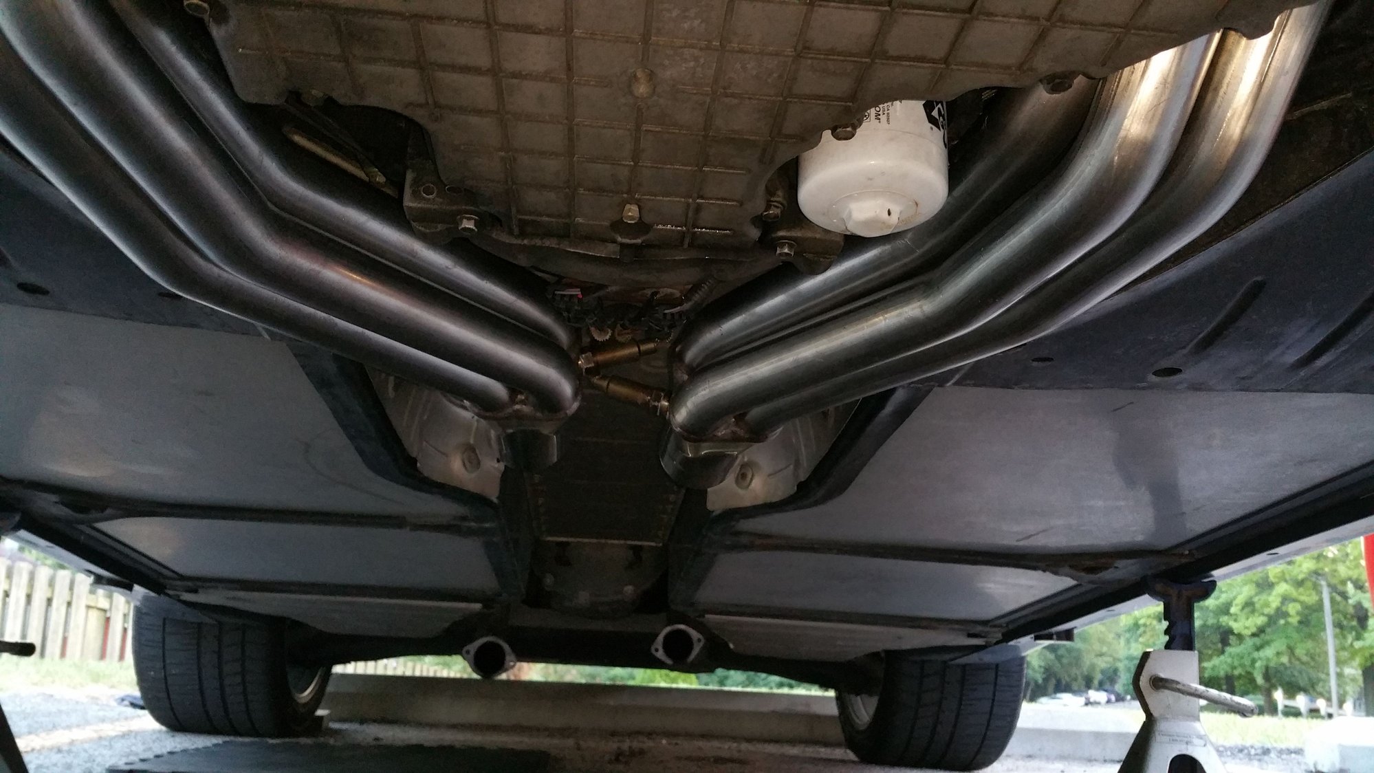

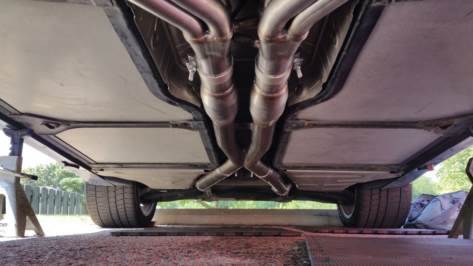

View from below. I have not tightened up the header bolts yet. I will install the rest of the system first to get everything lined up. Looks like there will be plenty of ground clearance. O2 sensors have plenty of clearance.

Good job man! It feels great to do it yourself! They look pretty good! My ARH werent tig welded from the inside like yours!
Someone on this forum said the TSP longtubee were ****, but from wat your pictures show they look good!

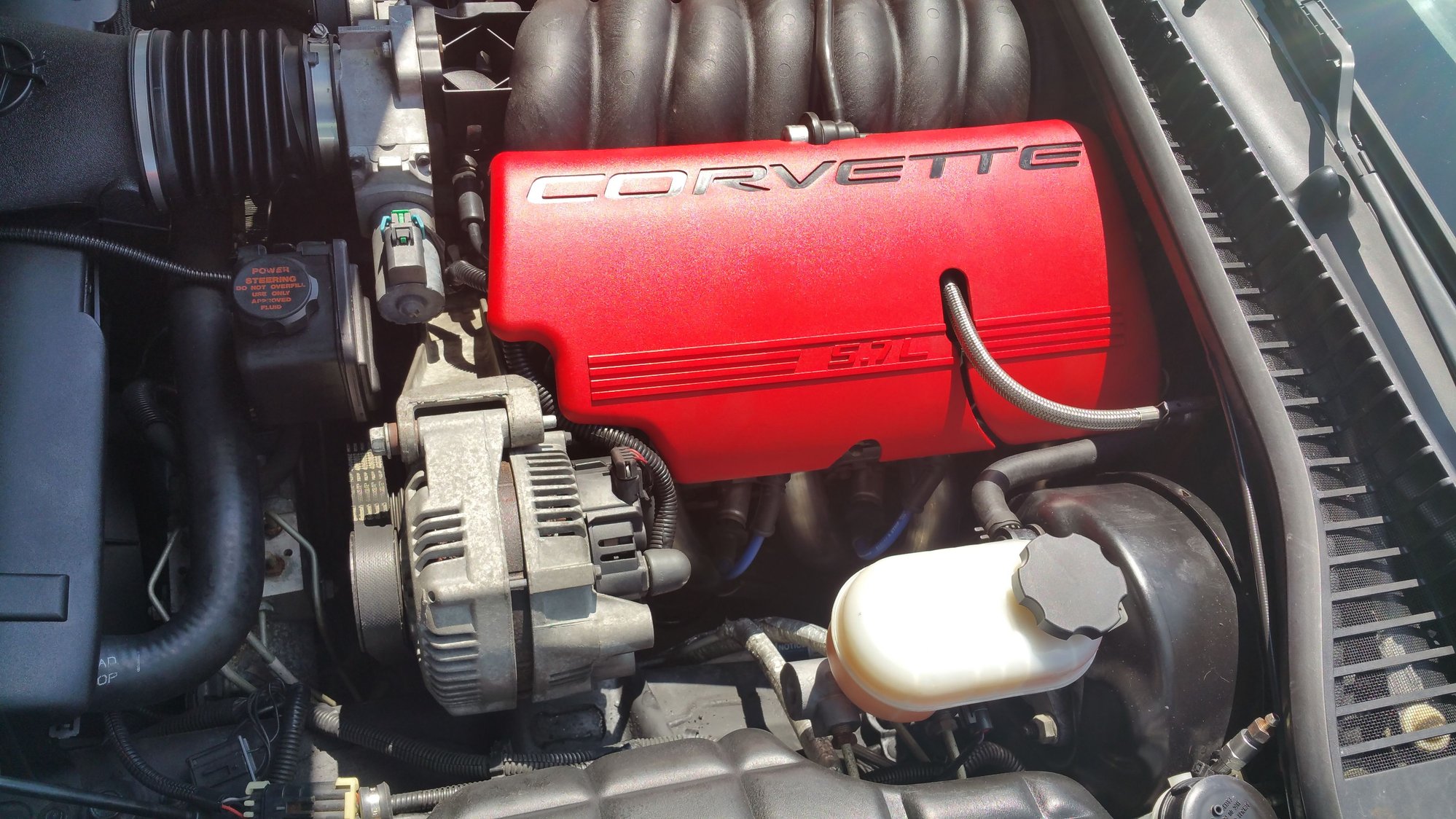

Finished installing everything today. I also completely removed the AIR injection system. What a convoluted system of tubing the AIR system is. Engine compartment is much cleaner and its so much easier to get to the plugs and wires.
I only did a quick test drive to make sure everything is okay. I haven't really opened her up yet but on the initial start and short drive, the sound is awesome. It is relatively quiet but there is a nice subtle bassy rumble when idling. Cruising is only a little bit louder.
I will go for a long drive later today to full test everything out. Thanks.
