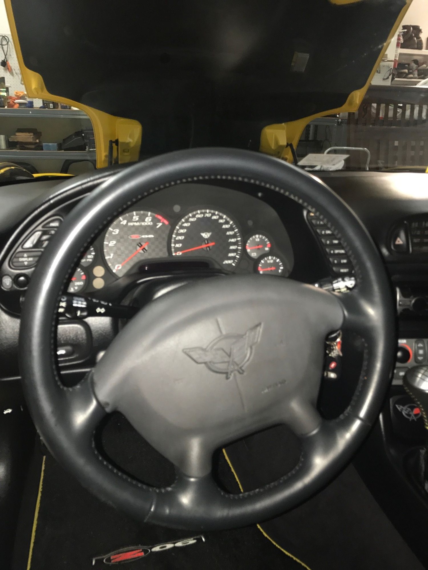

Not a huge issue but the airbag part of my steering wheel has become very sticky, almost like it's slowly melting. I don't know if this is one of those common c5 issues but I really don't know what to try to somewhat restore it. Putting an interior cleaner on it does nothing. Its always very sticky and kind of gooey if that makes any sense

Update : stopped at my local Family Dollar and saw some auto cleaner/degreaser that said was safe to use on interior so I grabbed a bottle, it was only $1 so I figured I would give it a try. It took alot of scrubbing but it all ended up coming off. At first it was really dull looking after the scrubbing but after putting some Mother's VLR on it I'm very happy with the results. Here are a few pics.
