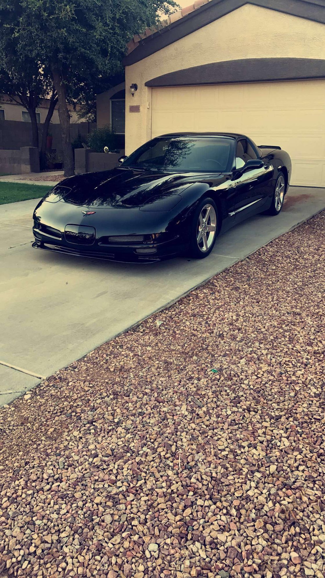

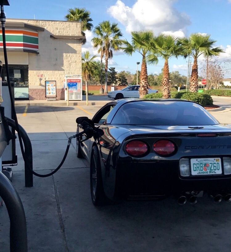

Old Jun 24, 2018 | 01:36 PM
kevbot's Avatar
kevbot
Joined: Jun 2016
Posts: 133
Likes: 46
From: Florida
Not the greatest photo (as I didn’t have them on for long), but I bought a set of C6 base wheels and the rears has Goodyear Eagle GT 325/30/19s crammed onto them. I’m running 25mm adapter-style spacers on the rear and these barely fit without hitting the inside of the wheel well. In this photo I was not as low as I am now but they’d definitely come in contact with the fender if it sat any lower. Didn’t notice any drivability issues but I can’t imagine they’re too safe which is one of the reasons why I ditched them.
