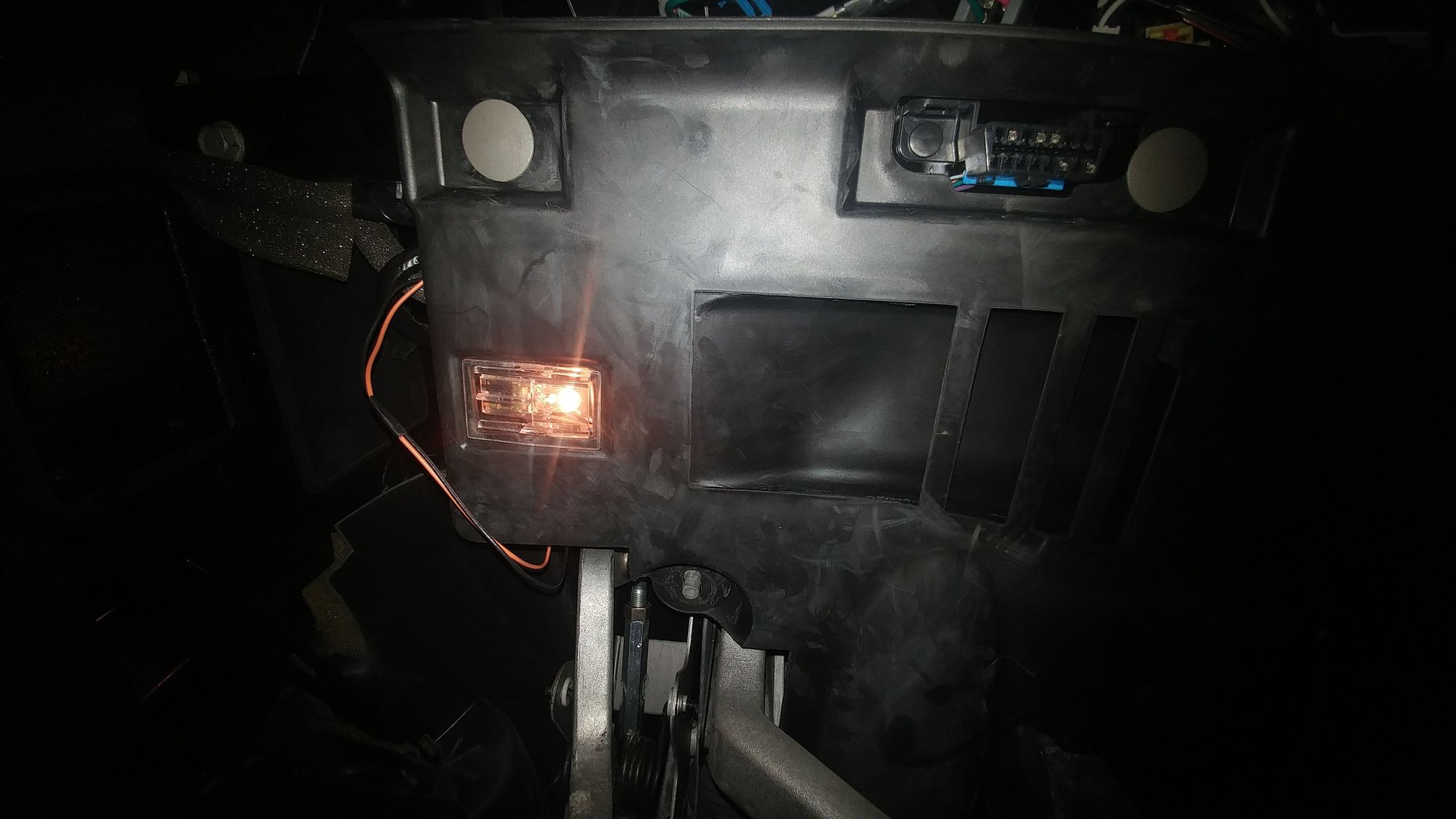

Its behind the knee bolster panel.... above the pedals.

There are 2 black circular plugs (shown in same pic) holding it in. Pull those out and it will come off.

Thank you.
