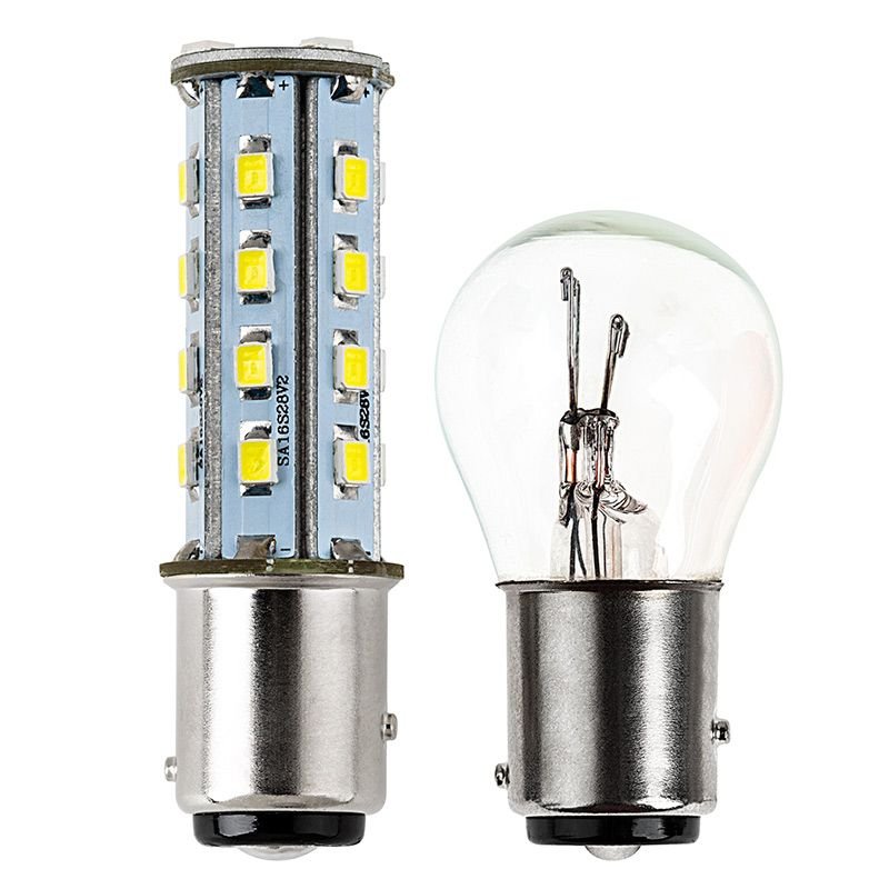

Thanks, how tight is the fit in the reverse light housing? I know I'll probably have to take it off myself to measure, I found one that seems pretty respectable from SBL here but it's rather long. Based on this pic, you think it would fit?

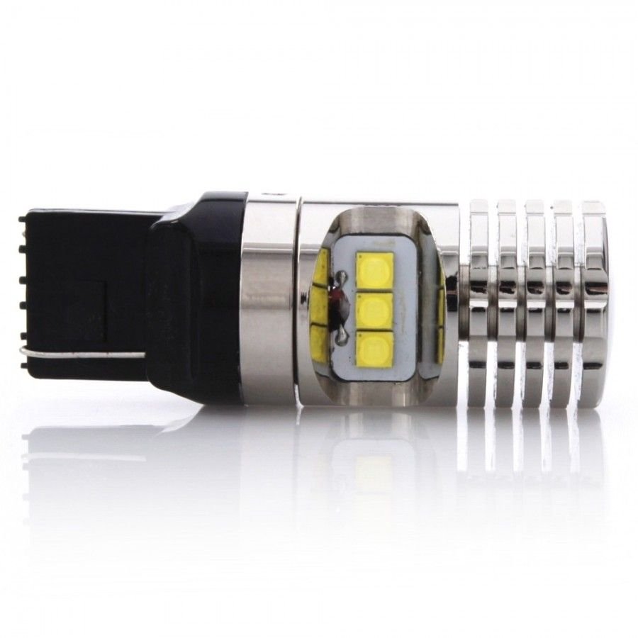

These are the VLED ones I would've liked to use, I swear I never see anyone else build such beefy looking LED bulbs. Each of those emitters is a 5W LED, compare to the one above where each emitter is .5W LED. Difference is the above is a 675 lumen bulb and below is 1500 lumens.
