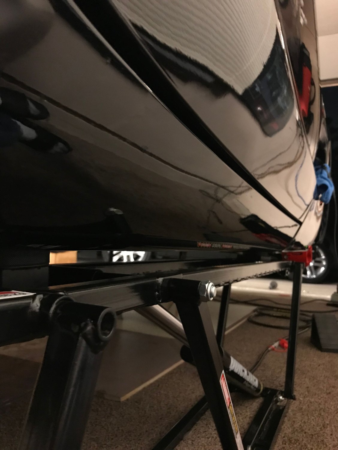

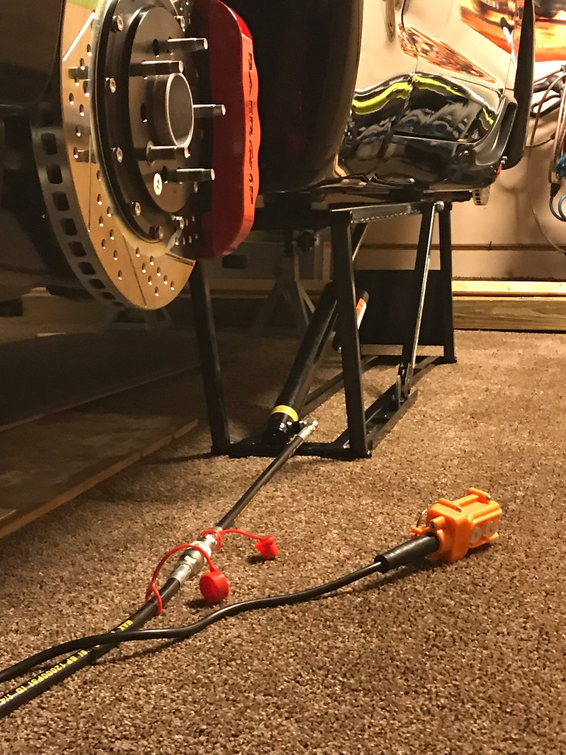

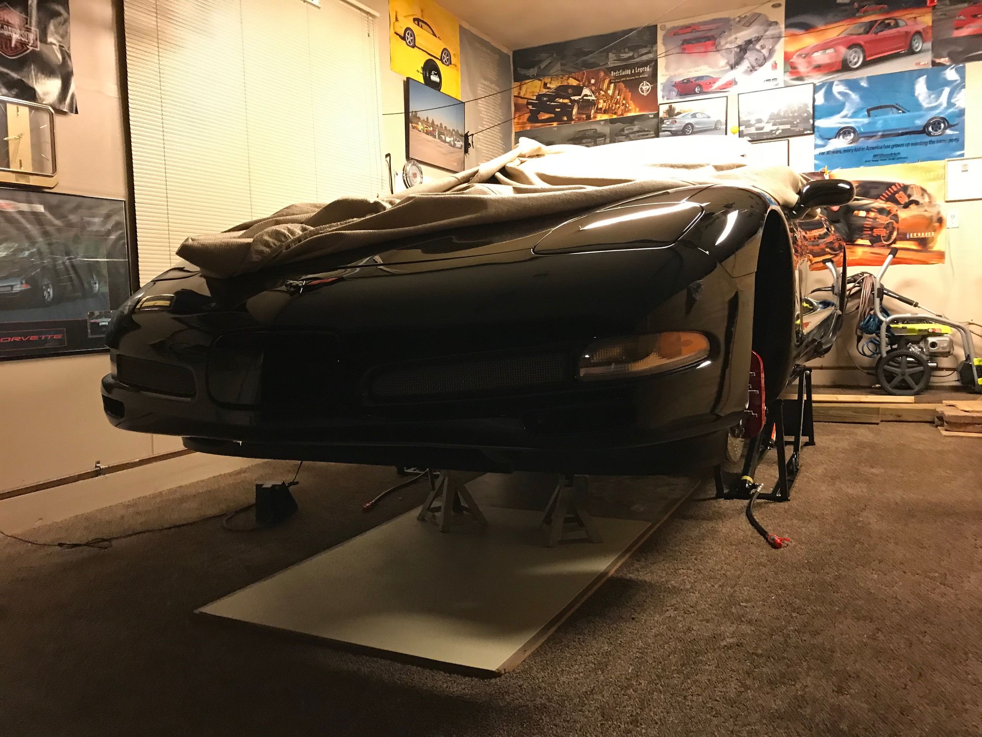

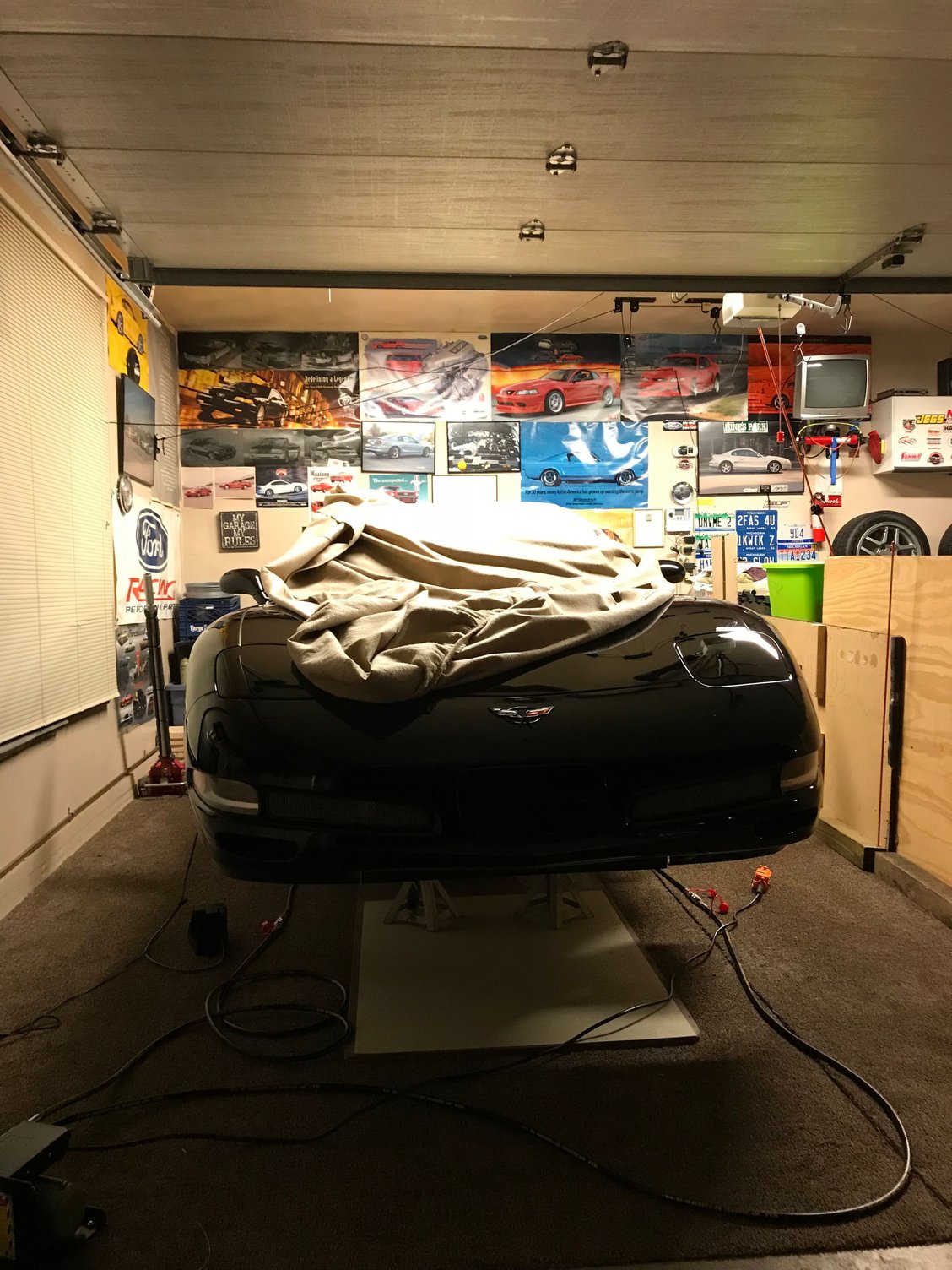

I’ve been debating on purchasing a Quick Jack for some time now. Last week I said I’ve had enough of messing around with my floor jack and using 2x4’s under the tires to get the clearance I need to get my floor jack under my lowered Z so I ordered one. Got the 3,500lb unit and put it to use right away.
I can’t say enough great things about it. Well worth the money in my opinion.
Jack stands for piece of mind while I detail the bottom of my car!

This is a fantastic post with the pics. I was just looking at one of these the other day. I especially like the new safety-catch feature. While I have the space in my shop for a full-blown BendPac, I don't know if I want that monstrosity in there. Plus, with the two-post lift, it would be tough to get in and out of the car. A couple of questions...
1. When not in use, have you figured out what to do with it? Is there enough clearance under the car to just push them together and drive your car over them, leaving them on the floor for storage?
2. You didn't show any pics before you lifted the car. Is there enough floor to lifting puck clearance to just slide the lift between the tires?
3. What was your price, all in? Shipping, hydrolic fluids and whatnot, too.

Dude, what is up with the carpet?

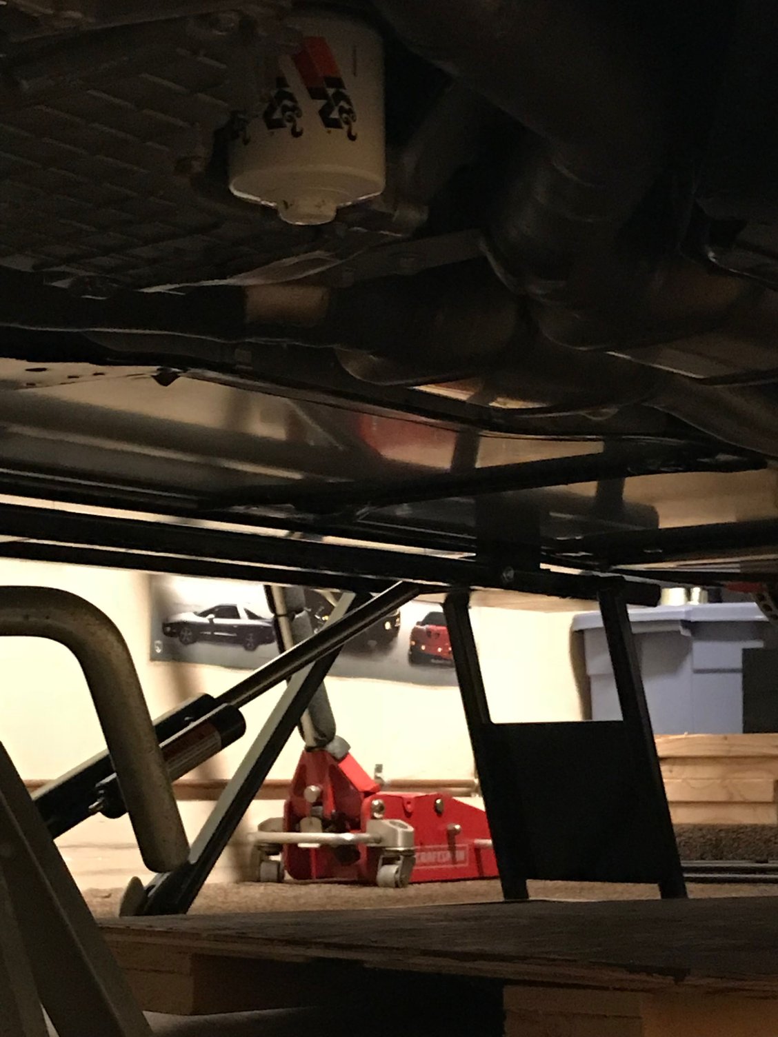

I saw this on display at Carlisle. I've got to get one. Is using the jackstands too your idea or do they recommend this when leaving the car on the lift for a long period of time? Lastly, I see you are using a K&N oil filter and you say your car is lowered. I tried one once on my lowered Z. When I removed it at oil change time it had scrapes on the nut. I'll never use one again.

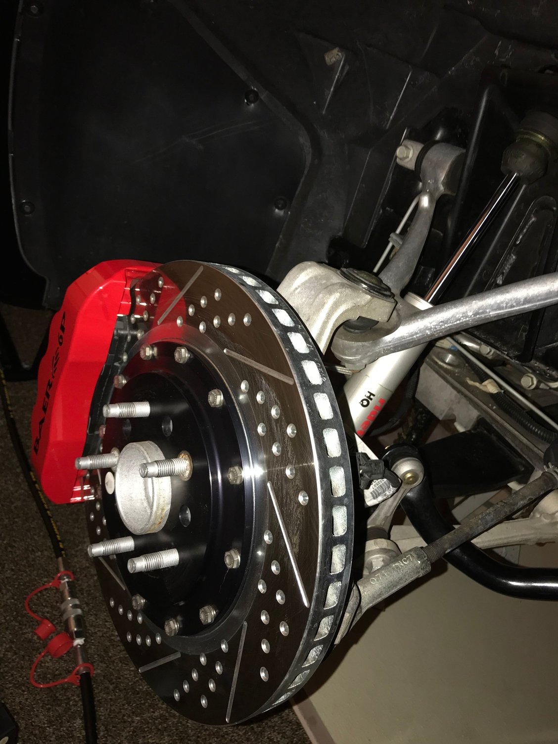

Nice brake system you got there too !!!
You could push them together and and center them under the car (collapsed height of only 3") but I don't want to risk running them over when backing into the garage. I will put them at the back of my garage, behind my Z06, when not in use.
My car was up on jack stands when I received the Quick Jack because I currently don't have rims/tires for my Z. I sold my Forgestar wheels several weeks back and ordered a set of Forgeline wheels. I should have them in a couple weeks (I hope...) Anyway, my Craftsman jack has a collapsed height of roughly 3-3/4" and the Quick Jack has a collapsed height of 3-1/2" with the short rubber lifting pads. Sliding them under the car to raise it will not be an issue.
Total price was $999.00 w/free 3 day shipping to my door via FedEx. plus, 3 qts. of Dexron III fluid was $21.00

You like?
Only my Z06 is parked in there and it is driven on nice days so I have no need to worry about road grime, oil, gravel etc... being dropped onto the carpet.

[QUOTE=striper;1595603540]I saw this on display at Carlisle. I've got to get one. Is using the jackstands too your idea or do they recommend this when leaving the car on the lift for a long period of time?
I put the jack stands underneath the car while I was cleaning the underside. BendPak/Ranger/Quick Jack state that the car is more than safe enough on the lift alone; especially when in the "locked" position. However, for piece of mind I'm using the J/S's only while I'm under the Z. The mfg states the 3,500 lb vehicle can stay in the up and locked position indefinitely if you so choose to leave it like that (less jackstands too!)
