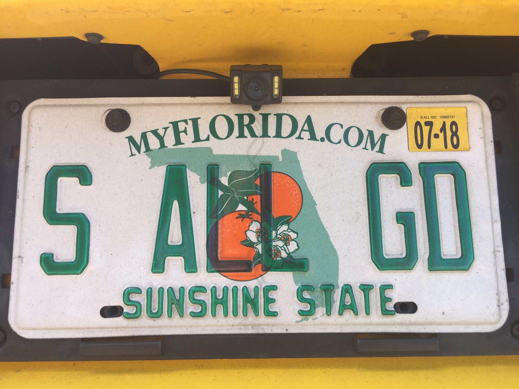

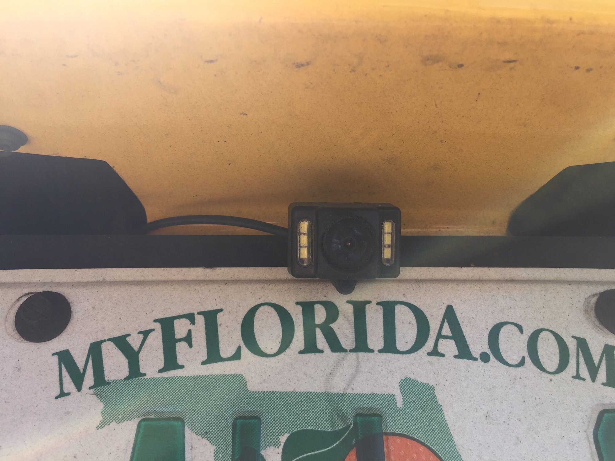

From: Northville MI
Boyo back up camera VTL375HDL license plate frame with LED. Multiple camera angles with control puck on console.
