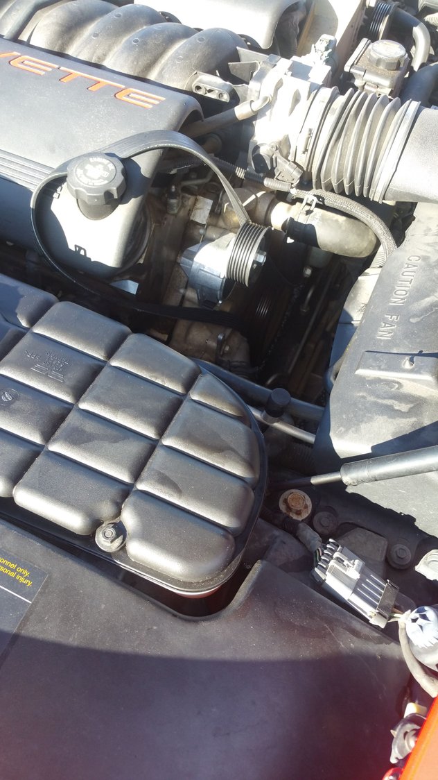

Driving back from L.A. to Phoenix the new idler pulley flew off and all that is left is the spacer/washer thing that went on the backside.
I heard a loud knock thud and knew belt must have come off, voltage Guage went down and dic sent overheat message, pulled over quickly.
I'm missing the pulley, the bolt, and can't remember if there is a spacer/washer that goes on the front.
Waiting on a tow truck to take us into Blythe.
I know the pulley and bolt and that washer has to be on the road, I walked a ways back looking, but it's 100 degrees out here.
So I came back to car.
Would anyone know if the bolt and washer thing would be the same on other gm vehicles like a pickup or a van, guessing auto zone won't have it.

Broke down off I10 about 40 miles west of Blythe California, heading east.
Any help on the bolt and spacer where to find would be awesome.
Not sure if bolt broke off or just fell out.
The idler pulley on main belt.

This was all that was left.

I looked at the one just above the water pump and also the one on the other side and neither one of them had a washer on the front....just the bolt.
Oh and think that autozone would have the entire assembly.

Just got it back together bought new pulley again, and the autozone guy had me buy a pulley with a bolt and a sleeve thing that worked with the bolt.
This is just to get home, then I'll buy the correct spacer piece and bolt.
