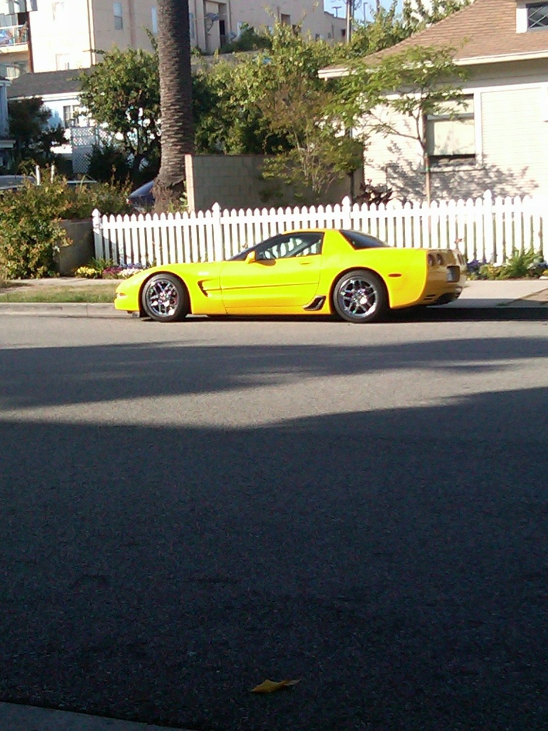

​​​​​​With that image now seared into your minds, a couple of years ago I got the LG Motorsports GT2 adjustable coilovers to compliment my T1 sways. I got them from Andy and asked him to make sure the car was nice and low, which he did:
So low in fact, that this happened soon after:
I still don't think the driveway of that building is up to code.
Notwithstanding, I still like the car low.
However, if I don't have my seat belt on, I'll get launched out the window if I go over a bump at high speed. I have the fronts at their firmest setting and the rear on one click down from firmest.

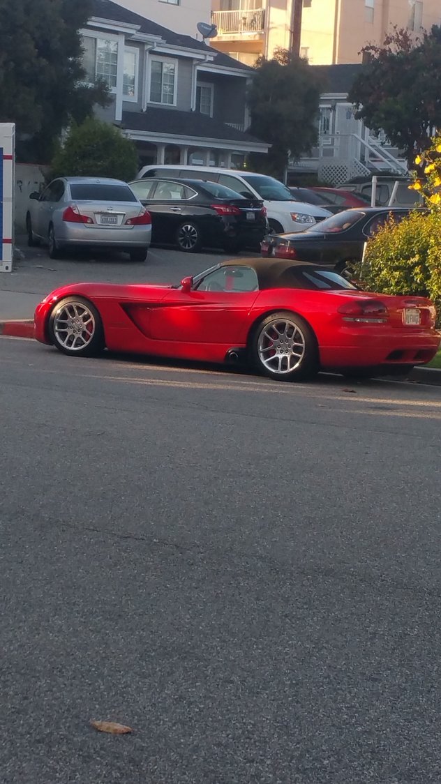

Meanwhile, on my viper, I have the KWs (I believe V3s) and it too is LOW:
But it rides like a dream; stiff, no body roll and very tame over bumps at speed. Plus, I have a bunch more room to make them even stiffer.

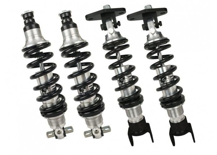

The GT2s have a VERY firm and some consider a harsh ride...
A great option is the Aldan American setup which IMO is an AMAZING deal for the price... $1199 Shipped to your door, Made in the USA, 100% rebuildable, and we can customize to your specs. I 100% guarantee you'll love the performance and ride of the Aldan's... we offer a satisfaction guarantee or you can return them
Click here for more info...
http://www.tpsmotorsports.com/aldan-...-corvette.html
