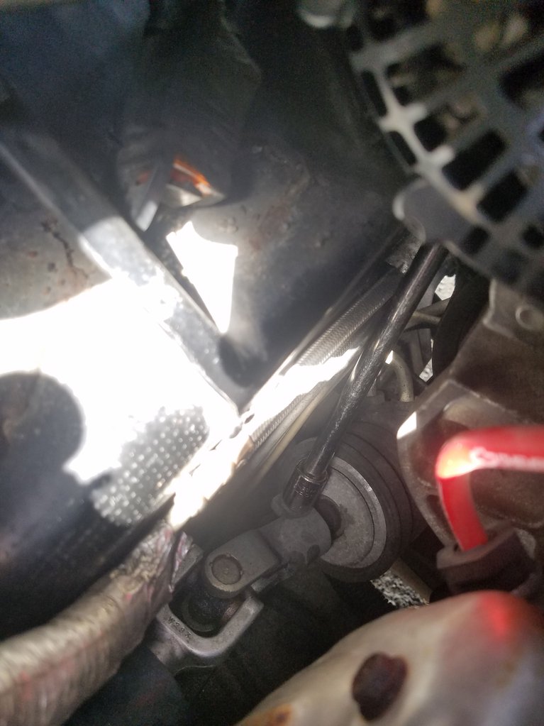

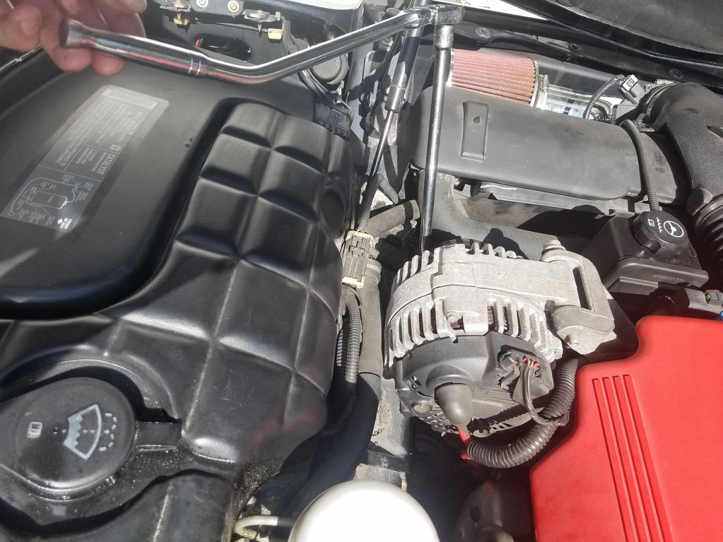

Originally Posted by Rob 02
I need to do that too. Was there a cheat or did you have to remove the rack?
13MM socket and a long *** extension. Or a couple extensions chained together. The best route is right infront of the alternator pulley, You kinda rub on the serp. belt but its a good angle overall. No rack removal necessary, it's part of the shaft into the rack anyways.

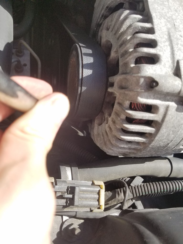

Is your ABS not mounted directly in top of that bolt? Mine is an '02.
See these pictures. Took a few snaps while out messing around with stuff. Socket is directly ontop of the bolt. Might have to mess with your steering wheel to get the perfect angle. Do not attempt to tighten unless you got a direct line. Rounding that bolt would be a bad day!

Sorry, I thought you were talking about the tensioner on the gear box.
The pix cleared up the confusion.
