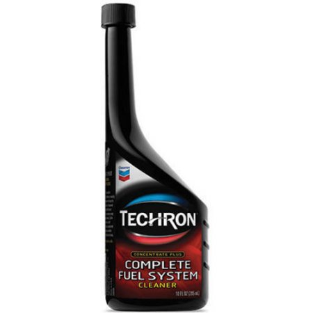

$1600!!!!!!!!!!
Go buy a couple bottles of Techron and use one in a tank. Repeat at the next tank full. That has worked for allot of us.

On my first bottle no change, will try second.

Be patient with it. Mine actually took about 6 months before it was working normal again. The longer it sits in the tank, the more it will work to disolve the build up on the unit. I also added 2 bottles of techron on each fill up.

I'm with above posters, Techron into a tank of Shell Premium, keep at it for a while. Good chance it will work out, worked for me. I now stay with Shell Premium, 2nd choice is Chevron Premium. Bottle of Techron every couple of months as maintenance. Good luck!

I'll agree with trying some Techron in the gas. Plenty of positive stories about using it here on the forum and I add a bottle to my gas tank about twice a year.

Chevron gas also has Techron in it.
