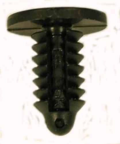

Greetings,
I have a 98 corvette and I am looking for the push pins that secure the plastic interior roof trim that runs between the removable top and rear window. I am not certain what the plastic piece is called. I have researched these push pins but there seems to be several kinds.
Any advice is appreciated.

I found that these pins, when acquired used are beat , as in broken tabs along the pin and don't hold as well as new ones.
I purchased these a while back. Parts manual called for this part number.
GM 20538173 Weather strip interior trim panel- fastener pin- retainer -xmas tree
http://www.ebay.com/itm/250993328013...%3AMEBIDX%3AIT

I had to go to the local paint store and had to buy a box of 50 for about $7. If you need 4 of these, pm me.

The one I posted above is shorter then the one needed for the lower A pillar trim. The retainer your looking for is part # 20540336
#50 as indicated in the diagram.
https://www.ebay.com/p/1997-2004-Cor....c100005.m1851
