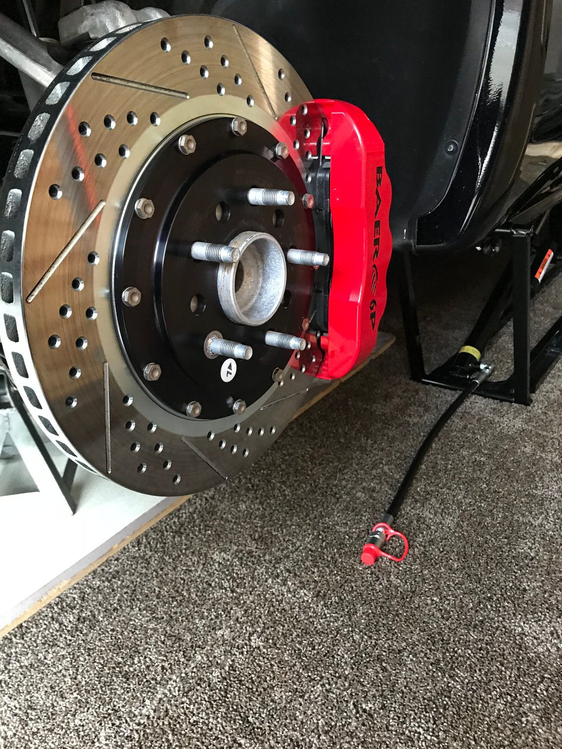

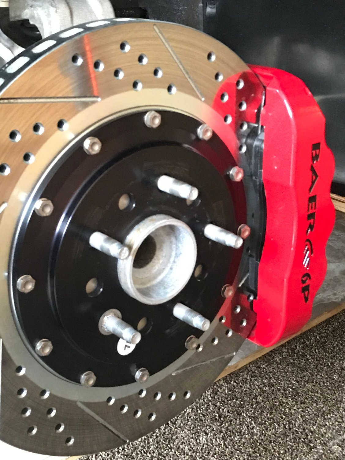

You know the old saying... “you get what you pay for”

Regarding "you get what you pay for"...I get it, but I also am not spending 5k on Baer/Willwood brakes if I'm not tracking it that much or at all. Don't get me wrong, that looks incredible but that would be 20% of the cost of the whole car.
