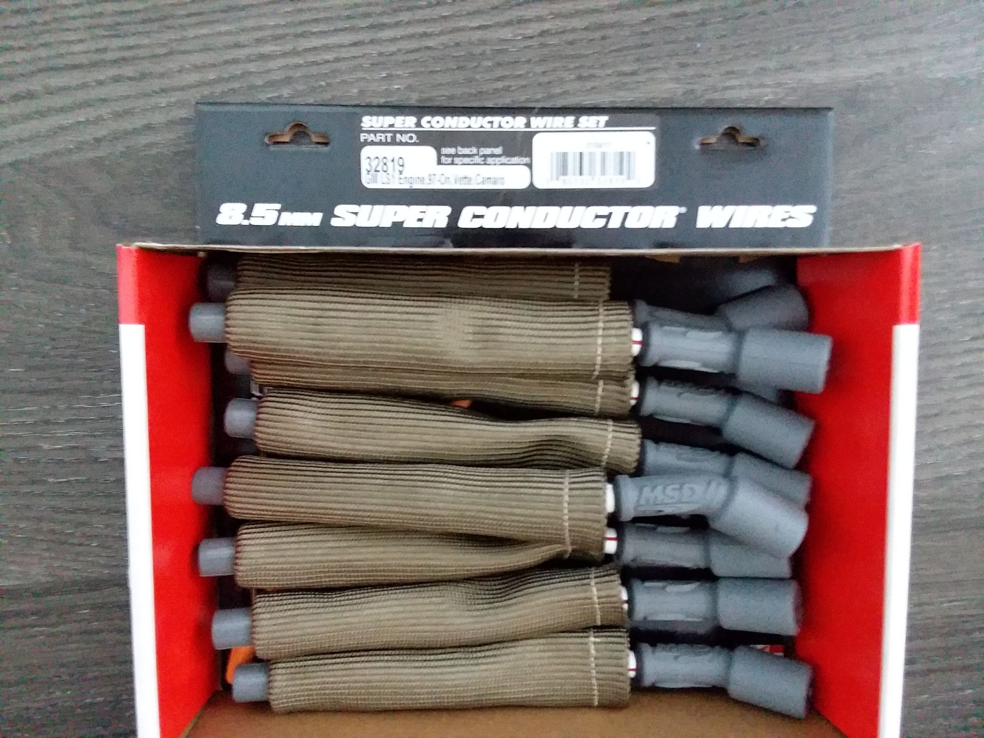

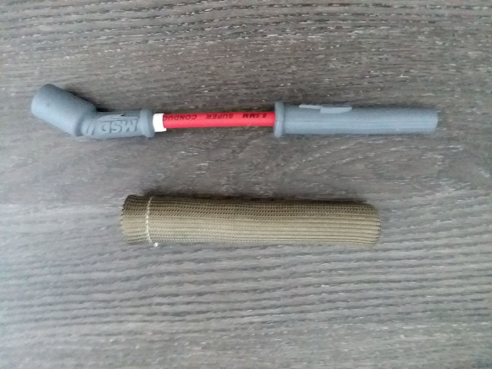

The gap is .040 and wires are up to you. I personally have Autolight iridium XP plugs, MSD Super Conductor wires and DEI titanium sleeves. I hear the GM performance red wires are also good.
Steve
