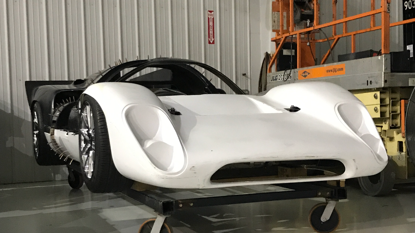

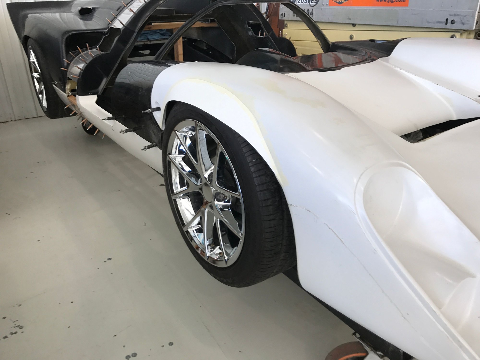

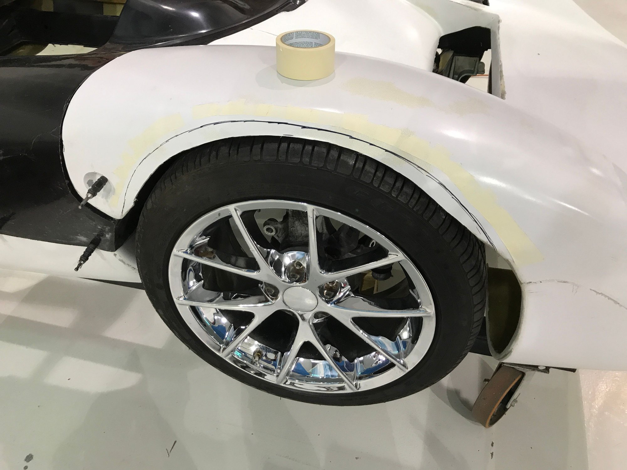

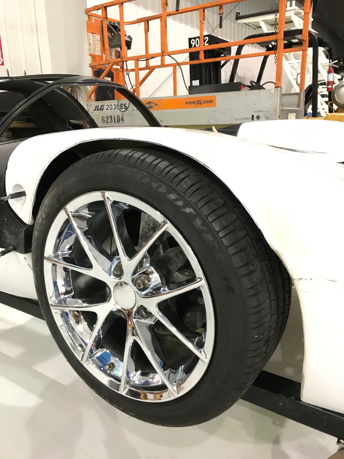

Well, as much as I hate cutting up a beautiful shape....
With 18”wheels ya gotta make some serious room.
Here is my old-school style flare pattern.
This is set at about where it needs to be.
Now I’ll mirror the other side to this & begin fiberglass work.

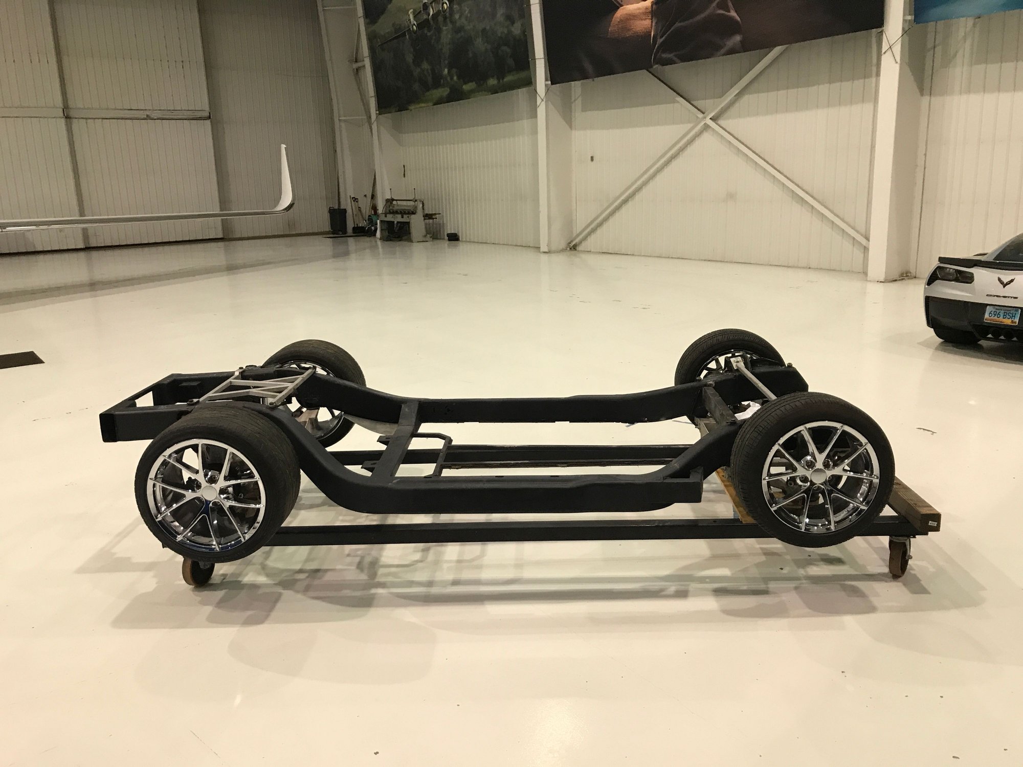

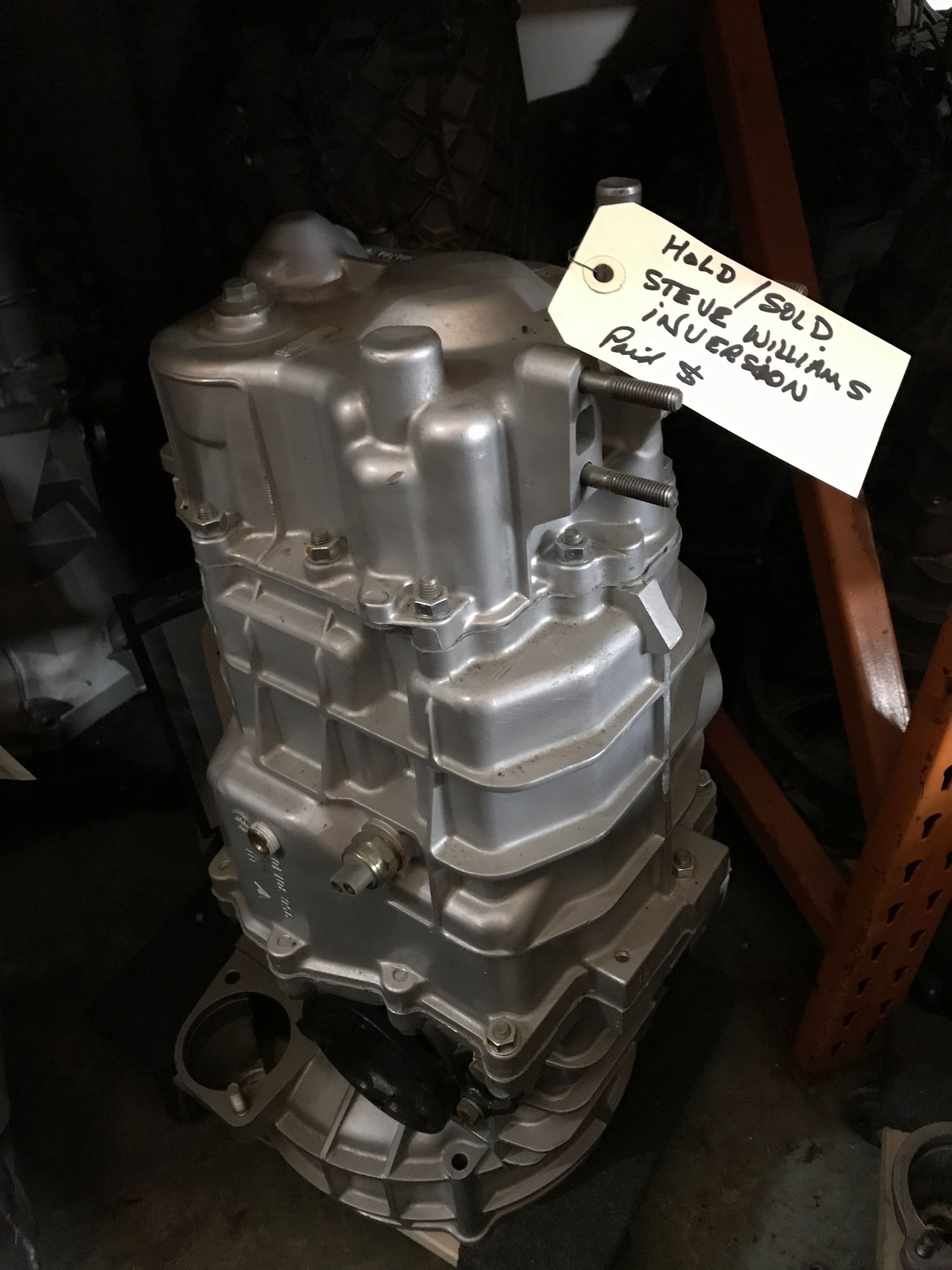

Any pics of the chassis before the body went on, by chance?
Old Oct 13, 2017 | 09:12 PM
RSILVR1's Avatar
RSILVR1
Joined: Jun 2015
Posts: 256
Likes: 341
Why sure!!!!
Lets recap!!! 700hp 418” LS
1-Lola T70 body found on an old race-cars website.
Inverted G50 with a few 930 parts & LSD thrown in.
C5 chassis that I stripped of all the old stuff off of from its previous life as Falcon F7 mule duties..

I blew up many a G50 behind an LS. Ended up using a couple Ricardo's, then Mendeola came out with a great transmission for the money. G50's will milk ya dry.

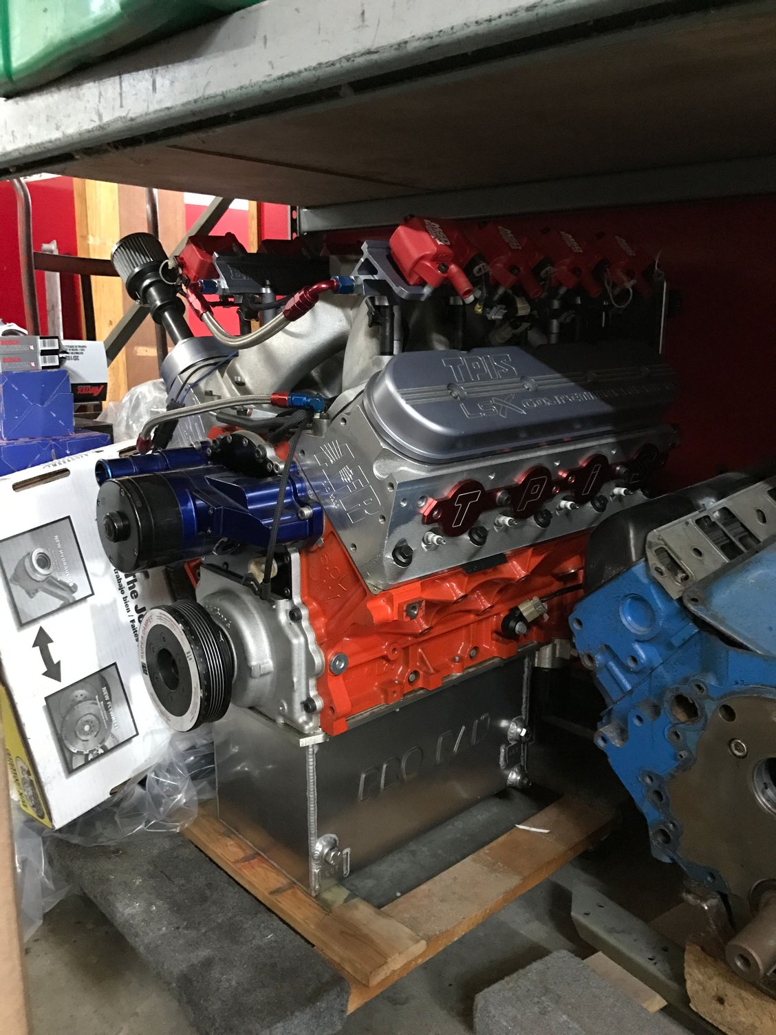

cool project, I have to ask what kind of oil pan is that monster and what does it hold 5 gallons or so?
Old Oct 14, 2017 | 01:32 PM
RSILVR1's Avatar
RSILVR1
Joined: Jun 2015
Posts: 256
Likes: 341
This pan is a Dyno only pan..
Im using a real-flat pan with 3-stage dry-sump.
