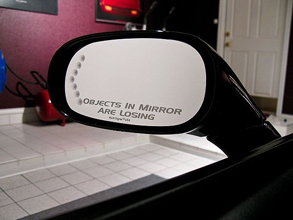

I replaced mine with MUTH Signal mirrors about 12 years ago - one of the best upgrades I made. They are heated, but not auto-dimming...

So do they make them custom (the writing on your mirror)?
That is just a $2.00 set of frosted stick-on letters you can buy on eBay.
Does the passengers side have the "objects in mirror are closer than they appear" on it?
Yes...
