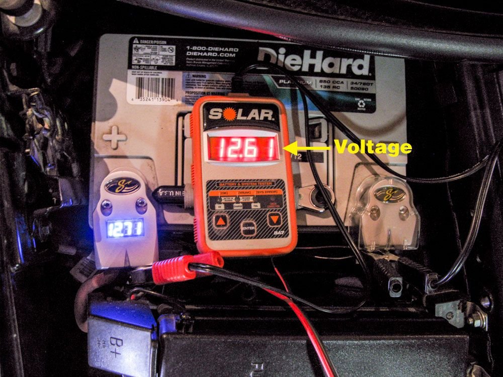

This is the best diagnostic tool I have found to show the true condition of your battery. Solar - about $99 retail...
