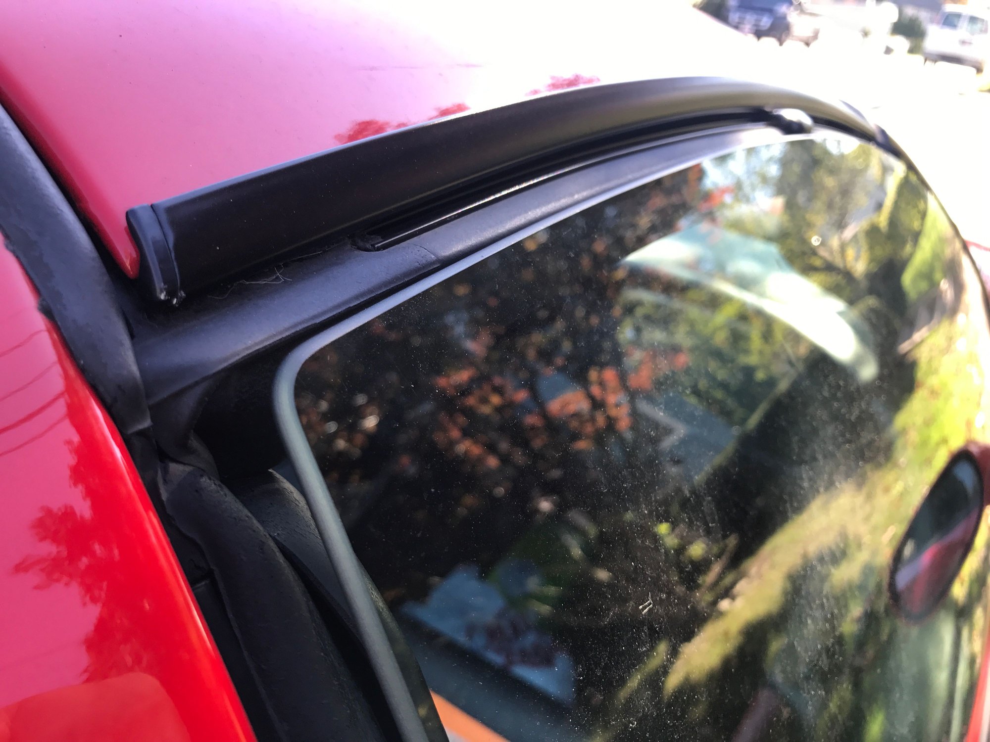

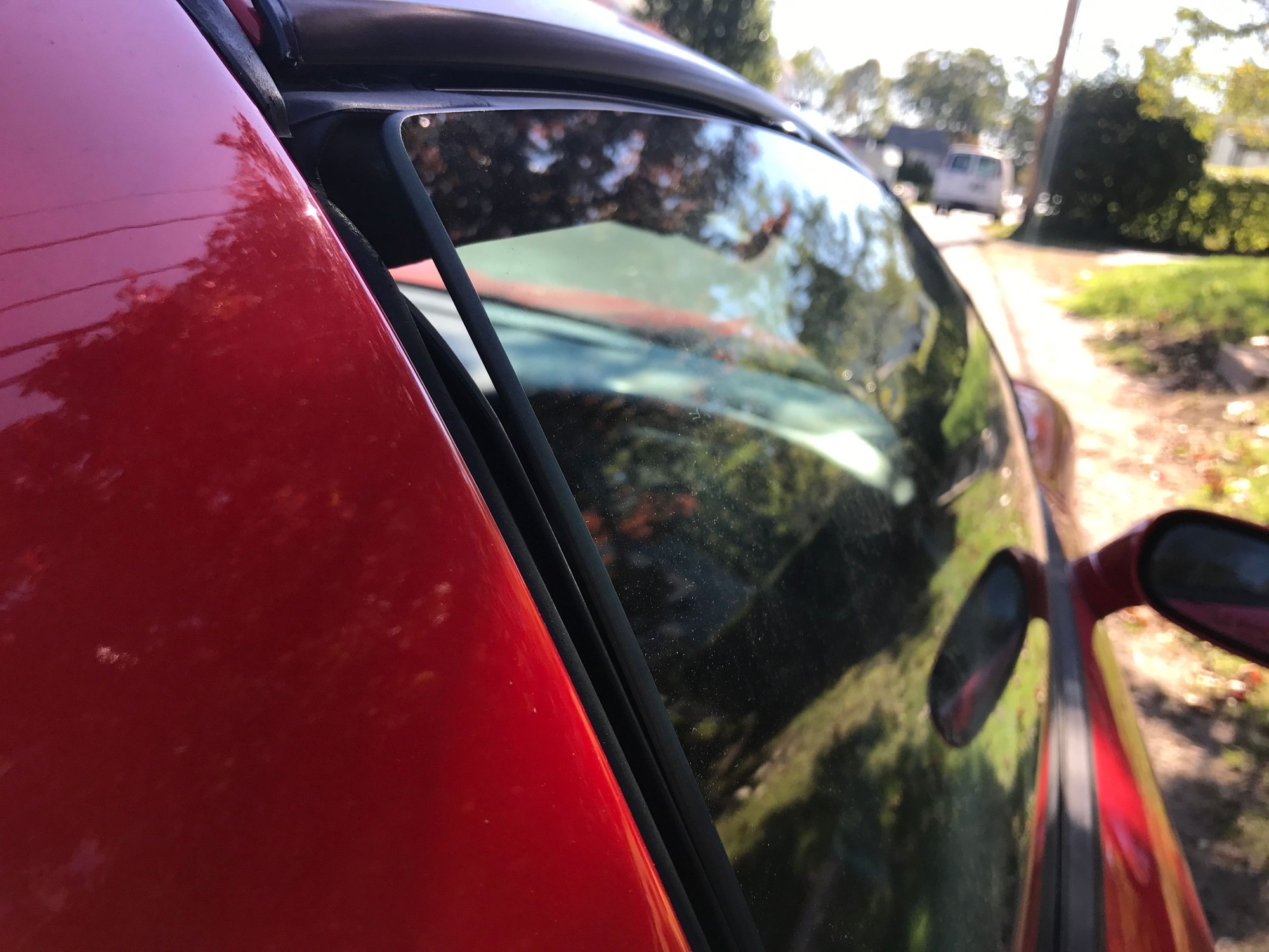

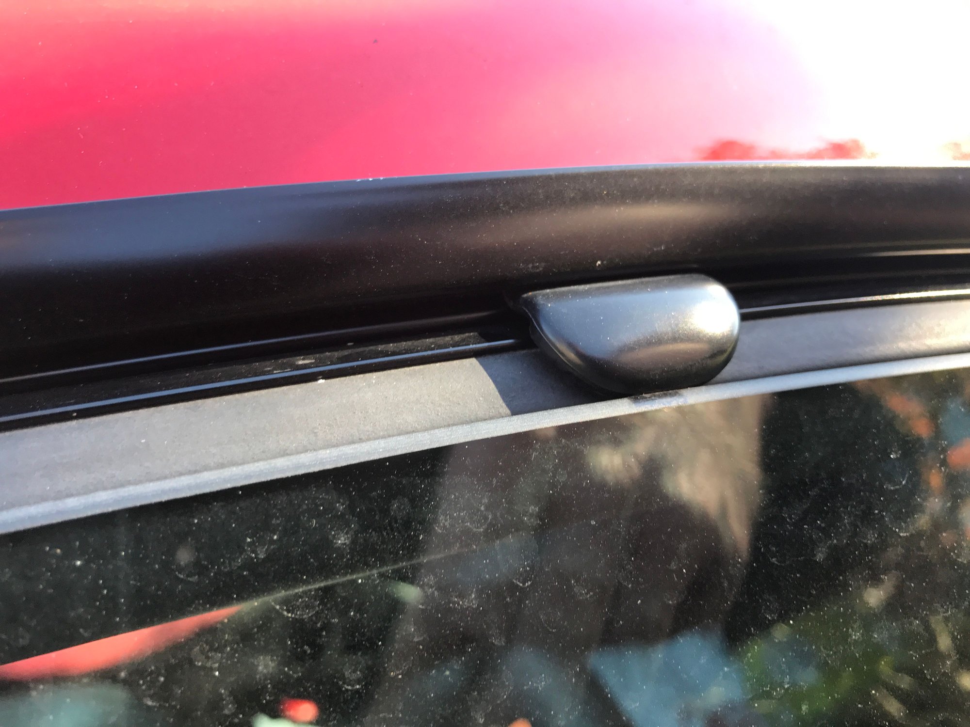

A while ago, I noticed my car ( 2004 Base Coupe) has this weird issue with the passenger side window: When ever the window is fully up (closed) everything seems alright, but after a while, it seems to pop out of the gasket. Even if the window is only 95% up, it stays in place (although you can sometimes see it starting to come out - but it stays in place).
Has this ever happened to anyone else?
