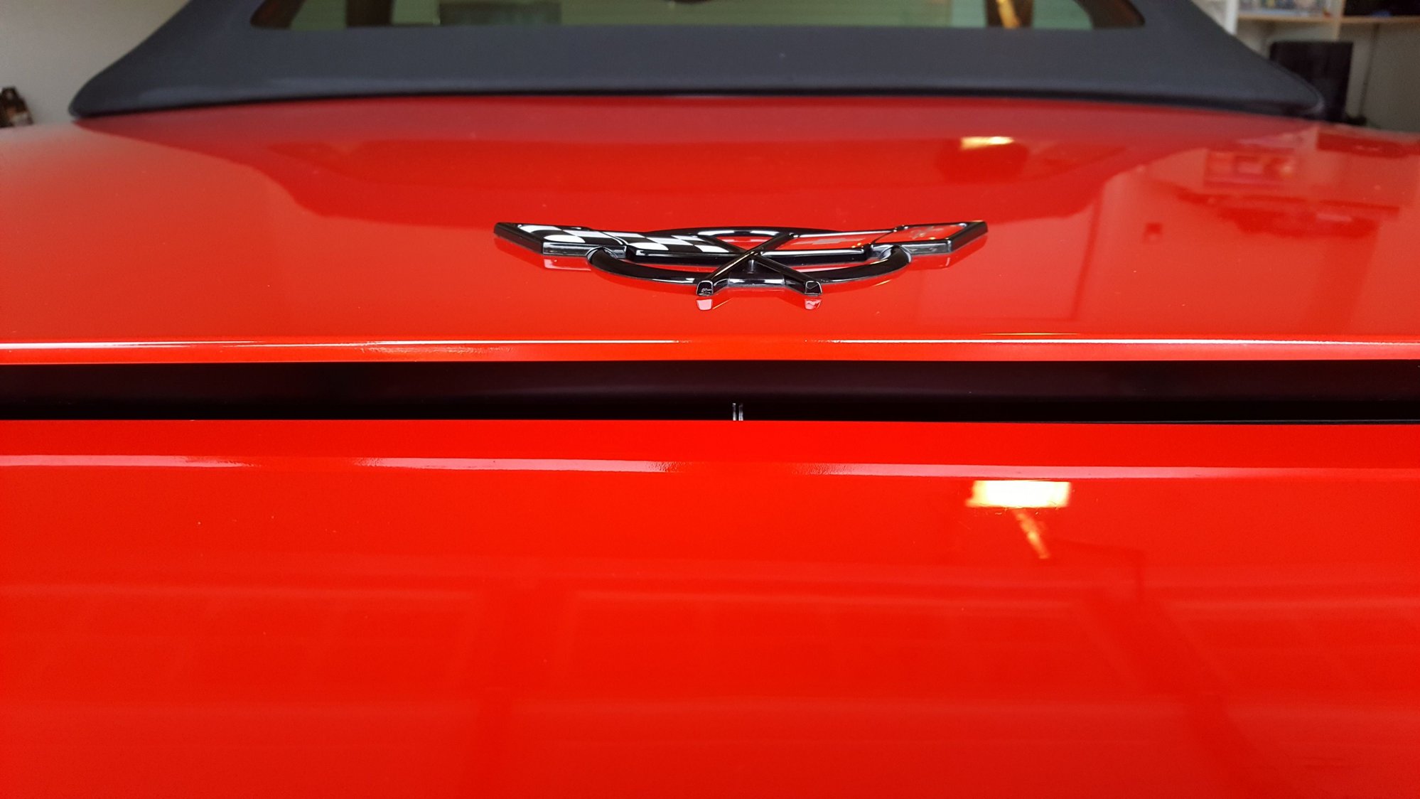

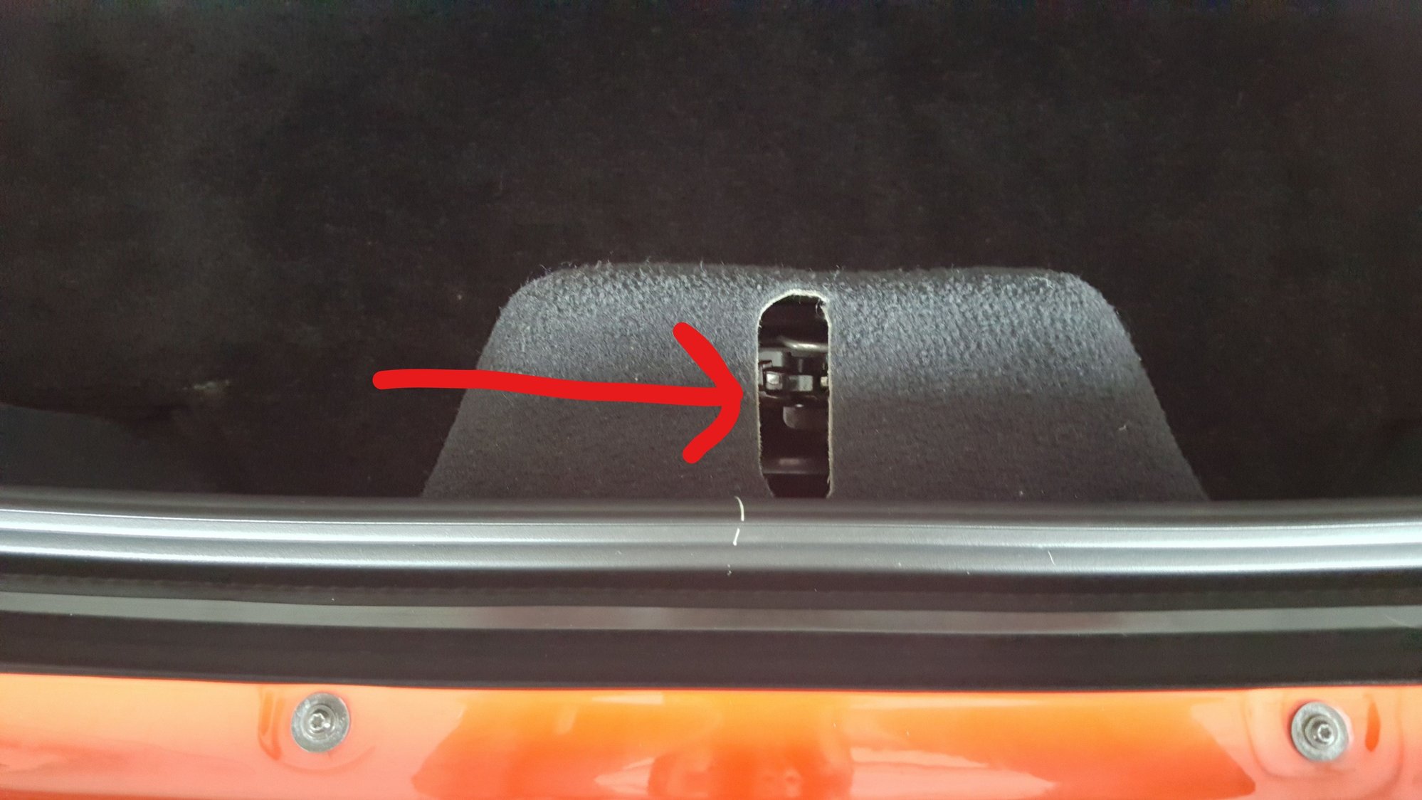

I just fixed this on my Vette.
Spray all the pivot joints on both sides. Also - spray some lubrication where the lid latch comes down into - See picture below.
Once I sprayed that area my trunk opened ALOT more than before. Below is the distance my trunk opens now when pressing the FOB.
