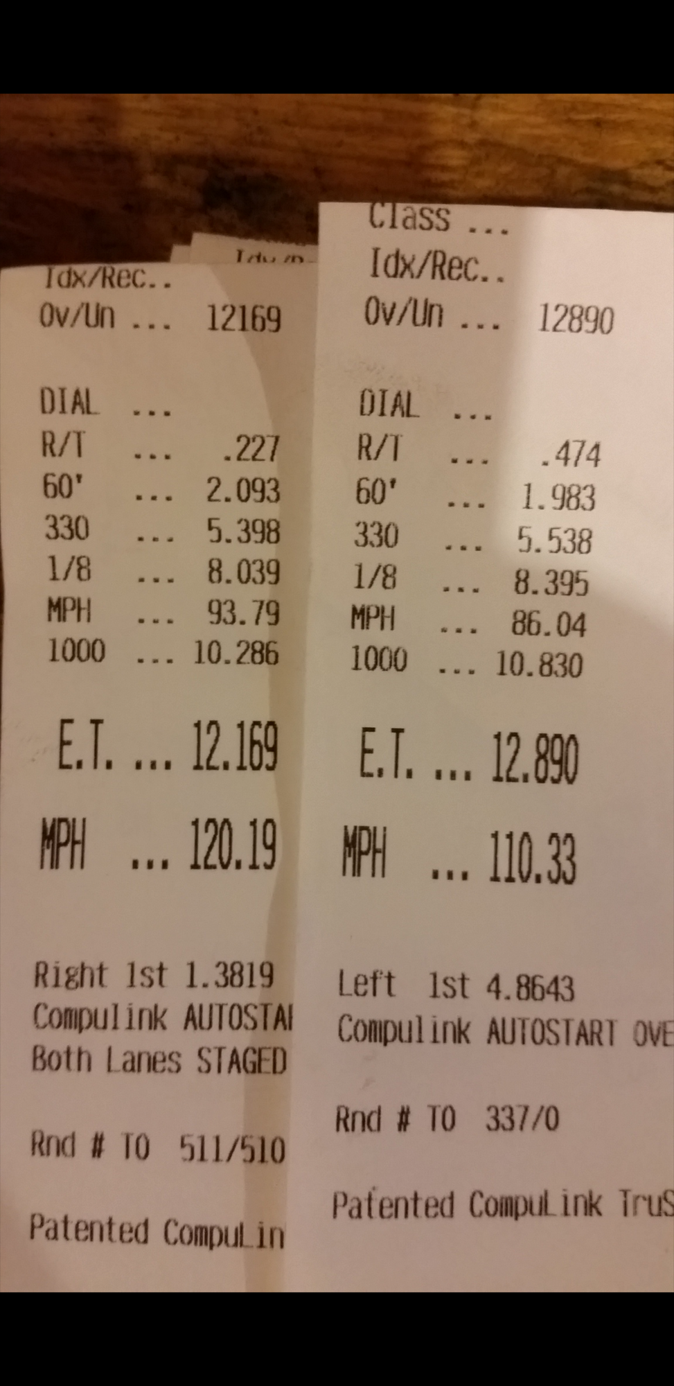

Hey guys, trying to get my 99 C5 6 speed down to the Atco one more time before they close this year. Only had it down 3 times total. Car is mostly stock except vararam intake and a Zex nitrous shot. So Far before intake and juice best I got was a 13.08 with Nitto 555 tires. After intake was a 12.89 at 110mph with a 1.98 sixty foot. Had it down to a 12.16 at 120mph with a 2.09 sixty foot on a 125 shot using a Nitrous outlet controller. With that set at 3500 to 5800 window for the juice.
So my 60' times are my biggest struggle. Doing a 3 to 5 second burn out in second gear and on the brakes. Then about 2500 rom for launch and trying to not just dump the clutch but slip it slightly and ease into the gass. Most runs I'm bogging down and rpms drops right glass. So feel like it's hooking up pretty well. That's what I don't like, feels like it bogs down to 1500 and um waiting for it to build power. Feel like with a better 60' and on the juice I can seek an 11 second pass. That is my goal here. I still have more ET playing with the window switch for the juice.
Any tips and lauching? Should i be more aggresive with throttle and RPM and slip the clutch more?
